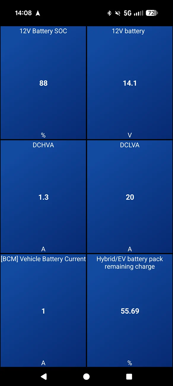

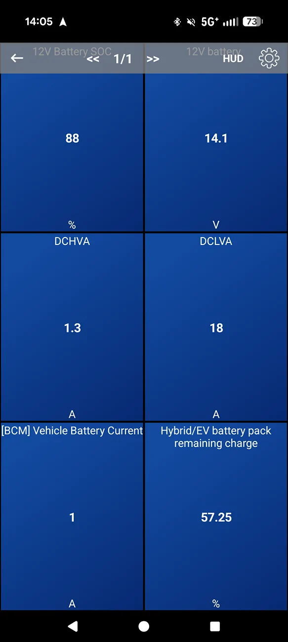

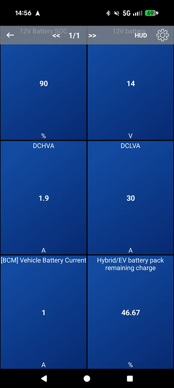

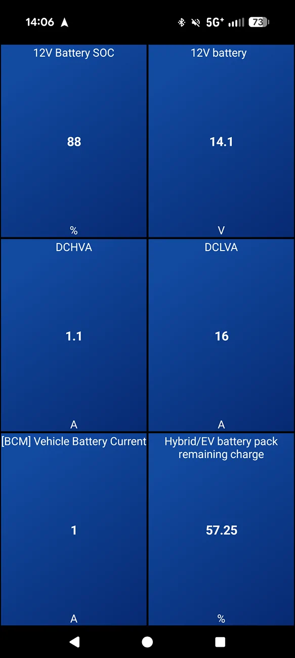

rslilly76
rslilly76
Apr 20, 2022
293
408
Corpus Christi Texas
2025 Maverick XL Hybrid Fwd
Well here's the latest numbers from today.
The dc/dc charge amps stay between 15-30 mostly all day. However, if the AC is on full blast, headlights are on, radio on it can jump to 50-60 amps. However, if only 1 of those 3 are true it stays 30 amps or under typically. I don't think the triggers are the same on the 25 the way mine is acting.
Is vehicle battery current ever anything other than 1?
Look for it in the first couple of minutes after a startup. See if that is anything other than a 1.
DCLVA is what your truck is using.
Not what is charging into your 12v battery.
Vehicle battery current of 1A looks like nothing but a trickle charge in your examples but I'm not familiar with your software.

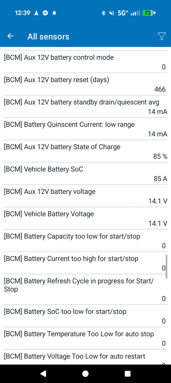

I'll have to watch that, there's a couple sensors that give that info, I'm learning at what to look at
That other thread where you listed all the PIDs - did show a LVB Current, which may provide more figures than Vehicle Battery Current.
Or it's doing the same rounding to whole numbers the Forscan provides on 1 PID.
I found a 2nd Battery PID that gave the extra accuracy to see below 1A.
I'm wondering since you are already at 90% SOC, it's too late for this threads auto-ability to do it.
466 day old battery.
Maybe if you gave it one external charge - then tried the method.
In which case - it is operating the same as prior years.
Perhaps the limits are higher though.
Those are all good questions! And thanks for the advice as I need it! 🤣
Just trying to put in extra data for 25 to see if it's different or if Ford actually fixed anything
