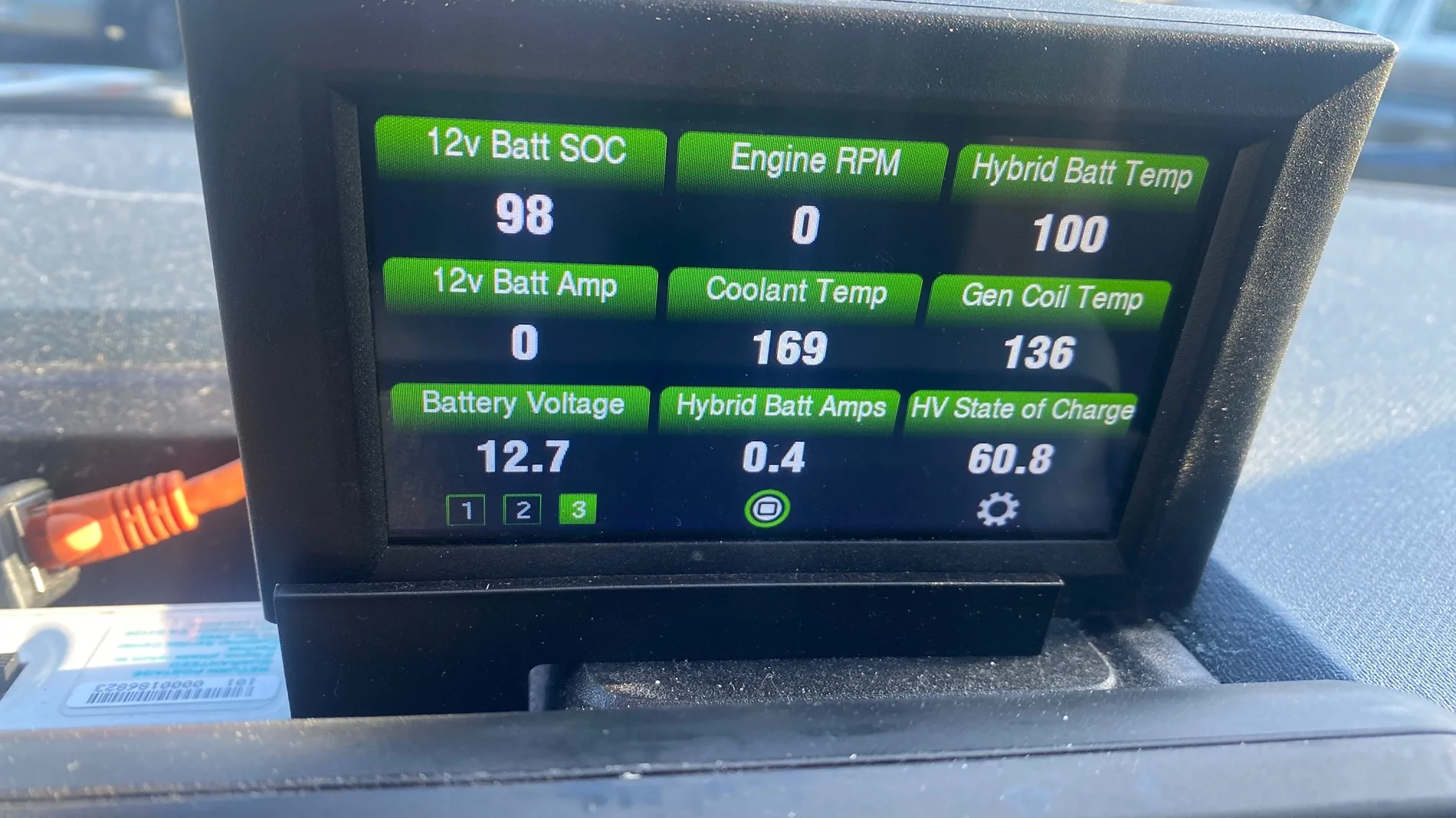

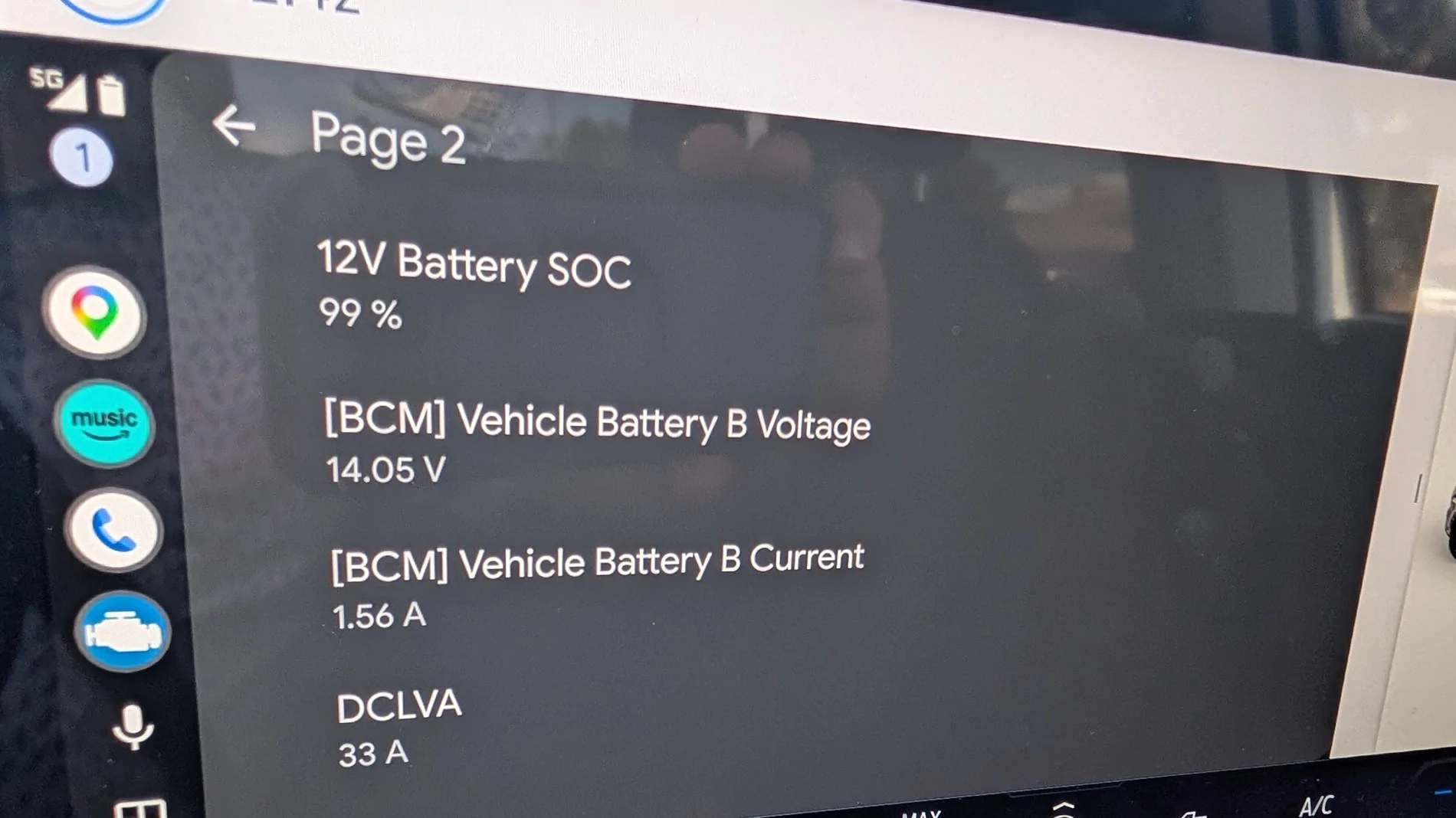

More evidence the truck does whatever the hell it wants.
Today: 50 minute 40 mile drive.
Daylight. DRL on but no other "tricks".
Ambient 58°F
After 1 minute of some negative and some positive 12v amperage it settled on this. And stayed like this (zero, or below 0.5 and rounded down) for the next 49 minutes.
I'm confused. Don't know whether to laugh or cry. But I'm starting to get bored with this...
Ambient 58°F
so crazy question, what if you set the drl to parking lights in forscan?
would it possibly fool it into thinking the parking lights are always on? 🤷🏻‍♂️

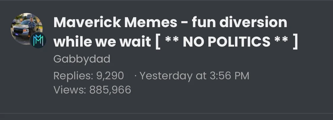

This thread is now 27 pages long so I am wondering what is the record for longest thread is, if not this. I have 2 $32,000 questions....
  1. Does Ford monitor this board?
  2. If the answer is yes, is this topic active there and what are they doing about it?
Sam,
Question # 1. No not officially.
Question #2. 27 Pages ain't even close.👇

So besides monitoring morning voltage direction, the power plug volt reading seems like one other good use.
@Mavster Mechanic
Would the simple use be:
While driving & none of the 3 systems are enabled, if you see 12.8V - the BMS has charged as high as it normally would (85% SLA, 92% AGM) and likely be in discharge state.
Turn on 1 of the 3 systems so it says 14.x again. (Amps lowered at 100%, but Volts stay high?)
May get by with a couple hours a week of that extra charge method.
@rslilly76
Great test and confirmation.
Ya - isn't the drop to float amps crazy. Fits with idea a battery charger final time is low amps - except they don't know how much longer we are driving.
Mine even at 50% SOC, within 5 minutes usually down to 1.x A, by 10 min <1.x float charge.
Thanks so much for confirming they kept the method going with 25MY and AGM battery.
Now we need a tester that has kept their SLA going strong thru regular recharging - with access to a scan tool - or at least the day after charging, notice that effect on a power port volt reading.
And no - my SLA isn't going strong, a recharge won't make it strong - and I want the warranty AGM before the 3yrs.

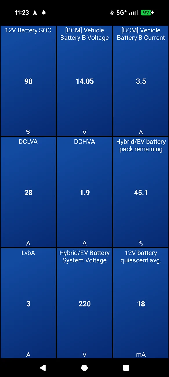

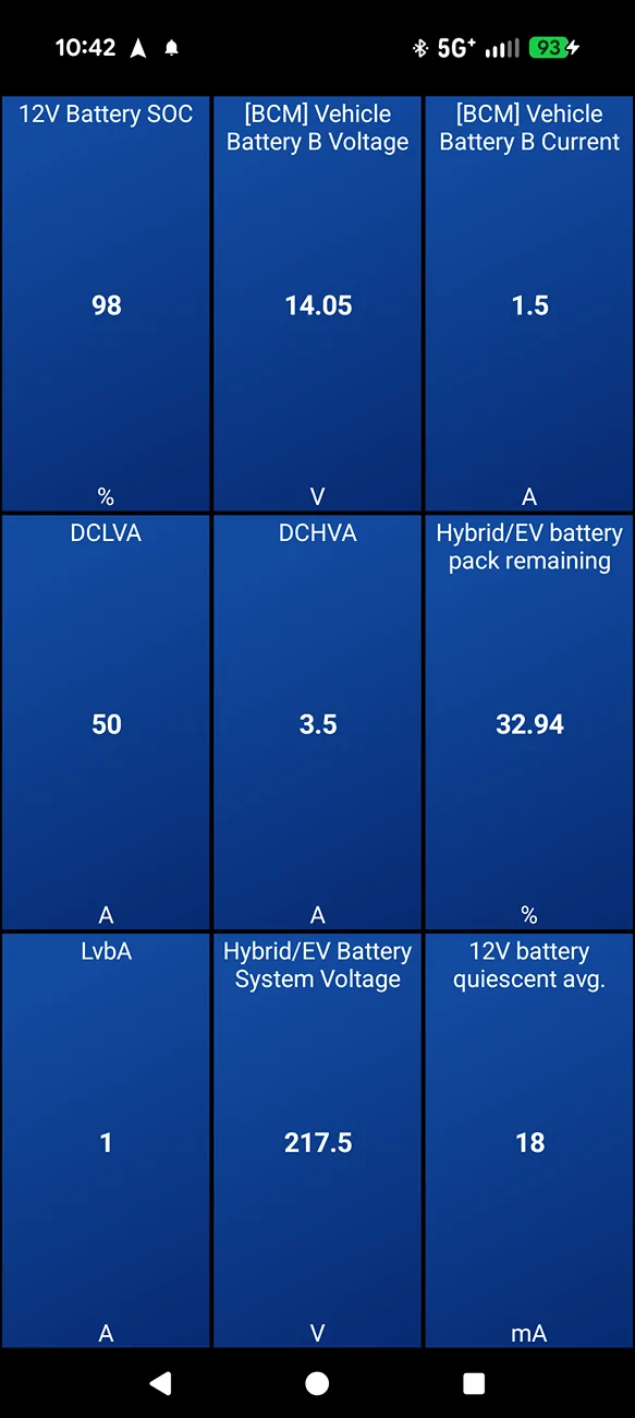

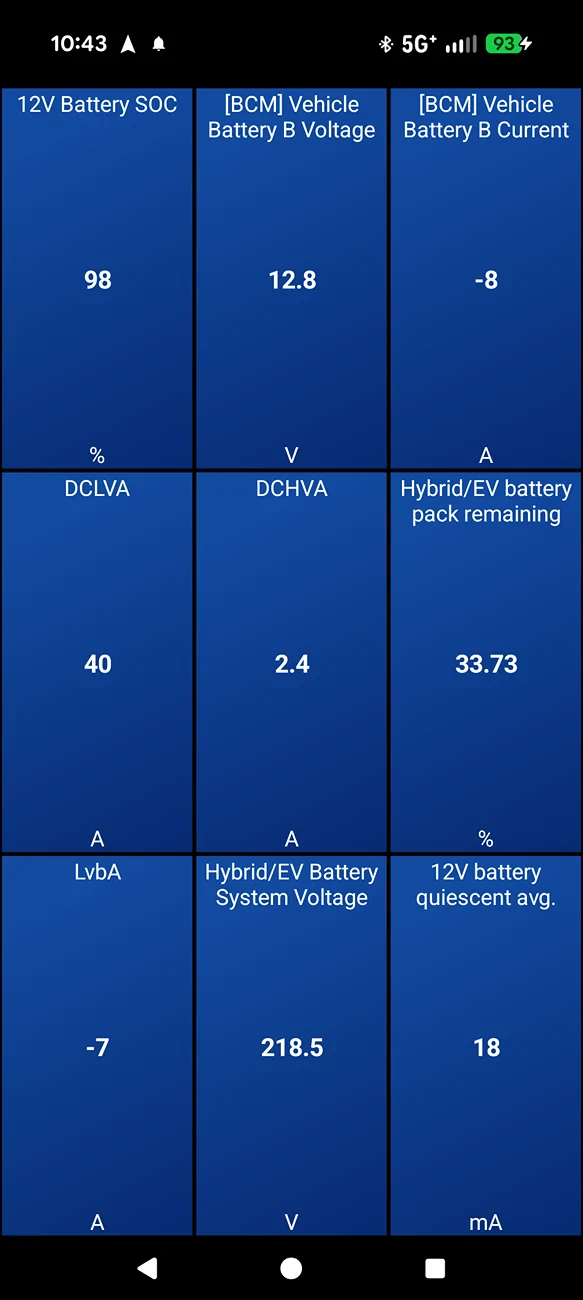

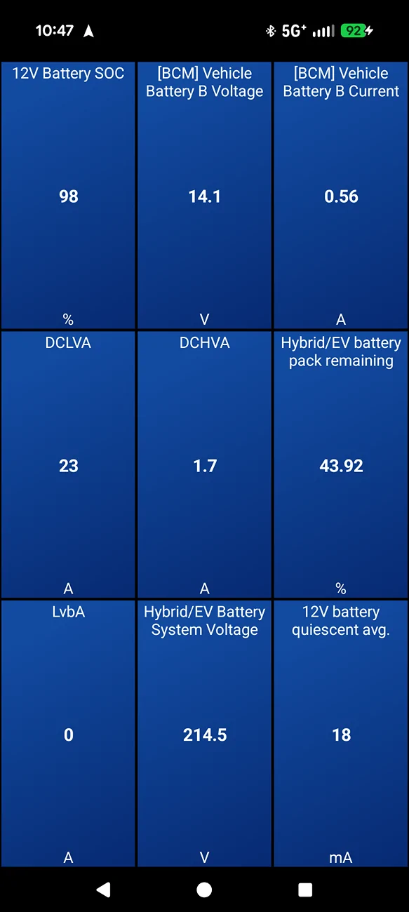

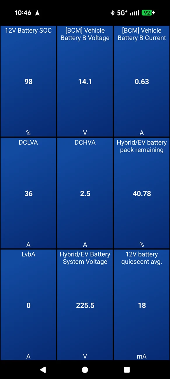

Well after yesterday's findings I decided to charge up the battery at home. I have a cheap old everstart 6amp charger, and I put the vechicle on that, but by the time I was ready to go to sleep it wasn't fully charged. I unplugged it anyway and this is what I found out today.
Started vehicle SOC said 98% and immediately the truck started to drain the battery with the negative amps showing on the BCM, and battery voltage to 12.8. I turned on the headlights, and it moved to 14.1 volts and the amps went up to 1amp. I drove for about 30 minutes to my first client and everything pretty much stayed the same, but the amps were down to about .5-.6 by the time I got to the client.
Next client I travelled to with the headlights on the amps went up 4-6 the whole way there and the battery reached 99% SOC
Next client it was back to 1 amp and 99% SOC.
This cycle repeated back and forth with each client 1amp one trip 4-6 amps the next trip. And there really was no rhyme or reason for the discrepancy accept that I turned the vehicle off and then back on.
Here's what I don't get, on SLA they start draining at 85% on AGM they start draining at 92%. Why aren't they allowing it to charge to 100%? SLA and AGM are supposed to be charged to 100% it prolongs their life. I know the Hybrid Lithium battery is a whole different story and that's why they shoot for 40-70% on those to extend their life.
Old school alternators would take over the 12v system while the vehicle was running, and they would charge the battery at around 13.5 - 14.5 volts to 100% (The only time a 12v battery would discharge when running was if the vehicle alternator or alternator regulator failed).
Why didn't ford design the dc/dc charging to mimic that? Are they trying to sell more 12v batteries by them prematurely failing on us? I just don't get it!
I think I am about to by a noco genius 5 and put the vehicle on it about 1 time a week at night or weekend.

Cry all you want, but my data matches @Mavster Mechanic testing as well, and I have included screenshots. The vehicle stops charging at 92% and starts charging if you do one of 4 things to get it to trigger it to charge. (go look at the readings and I am not the only one that has verified this)
My vehicle has all the ACCM and ABS updates so don't tell me that Ford has fixed anything.
Yes the parasitic draw is minimal on my truck which is 12-18mA (IDK what it was before the updates.)
I for the record have not had any deep sleep issues with my truck in the 13 months I have owned it. But I did prove that the truck actually drains the battery while the vehicle is on if the battery is above 92% SOC. That is not debatable, you can look at the data.
If the truck doesn't consistently charge the 12v battery to 100% this will prematurely degrade the battery. There is no denying this! Patristic draw will drain it sure, but the battery will fail prematurely from not being charged correctly as well. I do believe this is two things happening and Ford hasn't addressed this yet.

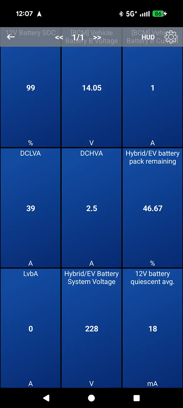

So another crazy thing battery was at 99% when I parked it, went to leave at noon battery is magically at 92% and went strait to drain mode when started. my sleep draw was 30mA too which has normally been at 12-18mA
I'm gonna set the parking brake tonight for fun to see what happens
