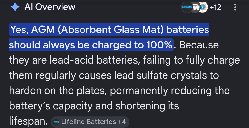

An SLA and AGM should always be charged to 100% (not 101% but 100%)
Failure to do so shortens the battery life. So tell me again they aren't too stupid! Cause they have the system draining the battery prior to reaching 100%
