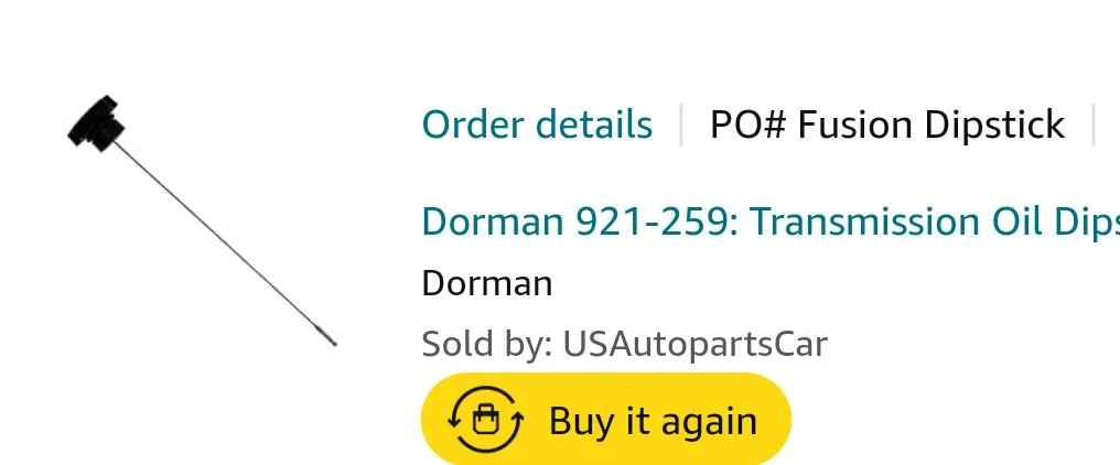

The Transmission is not sealed. The small black cap on the top is the fill port of the Transmission. Earlier versions of this Transmission had a Dipstick. The Dipsticks are available on Amazon. I bought one for my 2020 Fusion 6f35. I replace the cap after I check Transmission fluid for condition and level. Store Dipstick elsewhere.
Ford Maverick How to check auto transmission fluid on EcoBoost Maverick? Screenshot_20240930-113210_(1)
