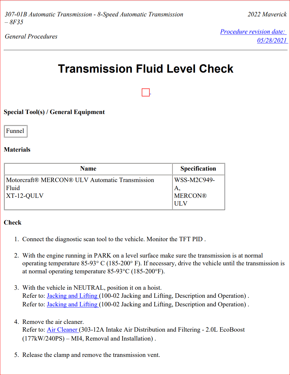

I'm posting this in the maintenance section rather than the transmission section because it's the servicing instructions for the transmission on the EcoBoosts. The revision of the service manual is 2021 so unless something drastic changes, it should remain current for a while for the 8F35's. If something does change and someone informs me of it, I will update the post accordingly.

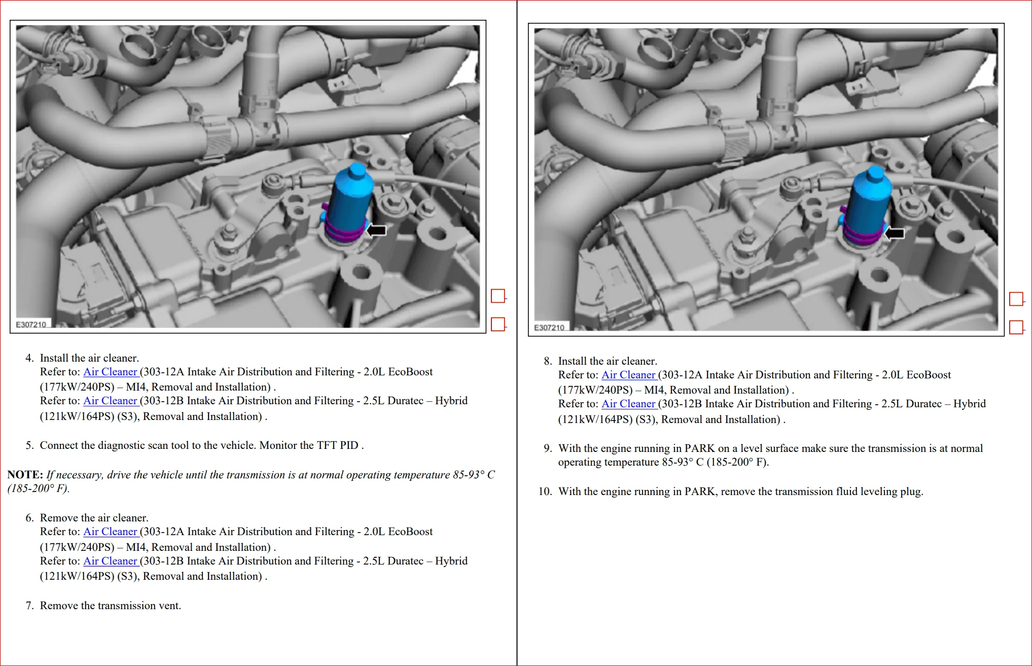

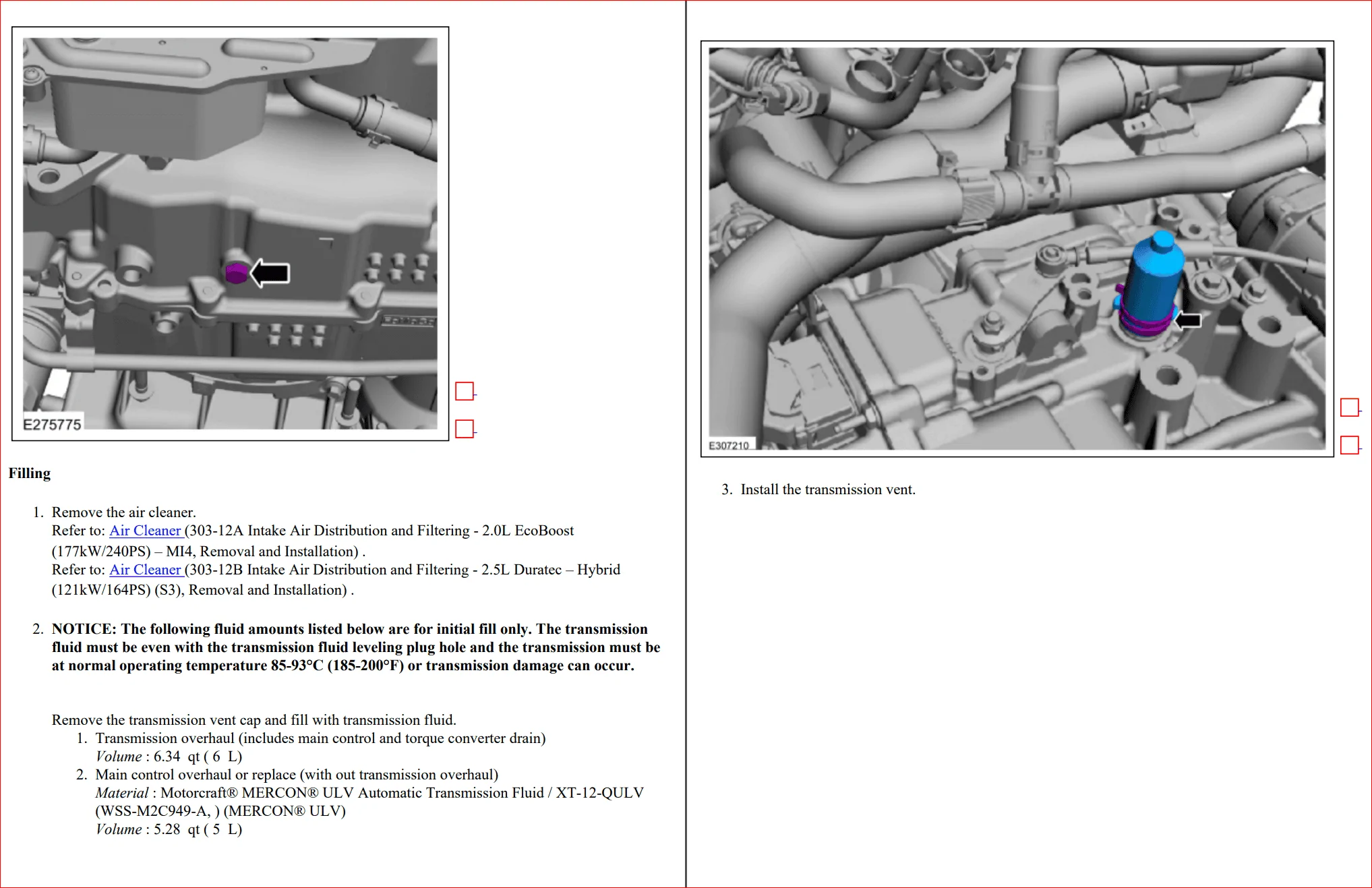

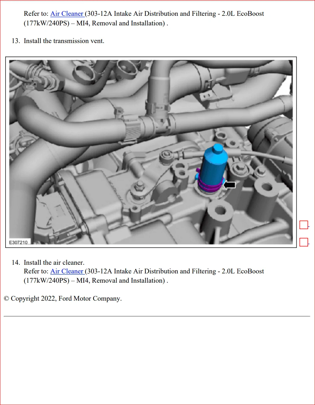

I'll start with the how to fluid level check procedure:
Ford Maverick Transmission fluid check and service, with torque specs (per the Service Manual) Check 001.PNG
Ford Maverick Transmission fluid check and service, with torque specs (per the Service Manual) check 002.PNG

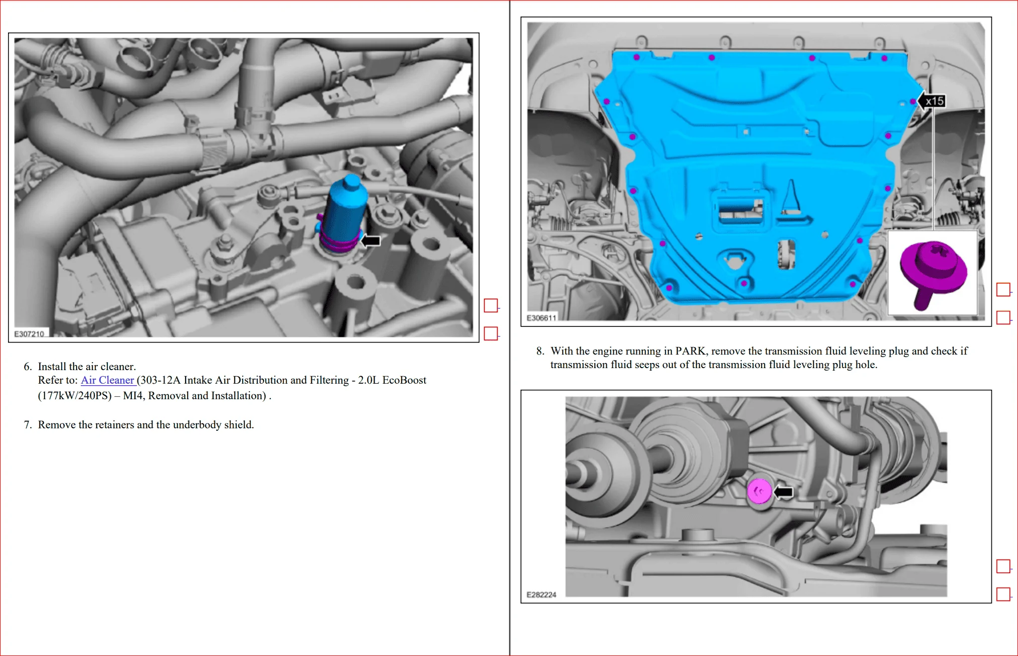

Ford Maverick Transmission fluid check and service, with torque specs (per the Service Manual) check 003.PNG

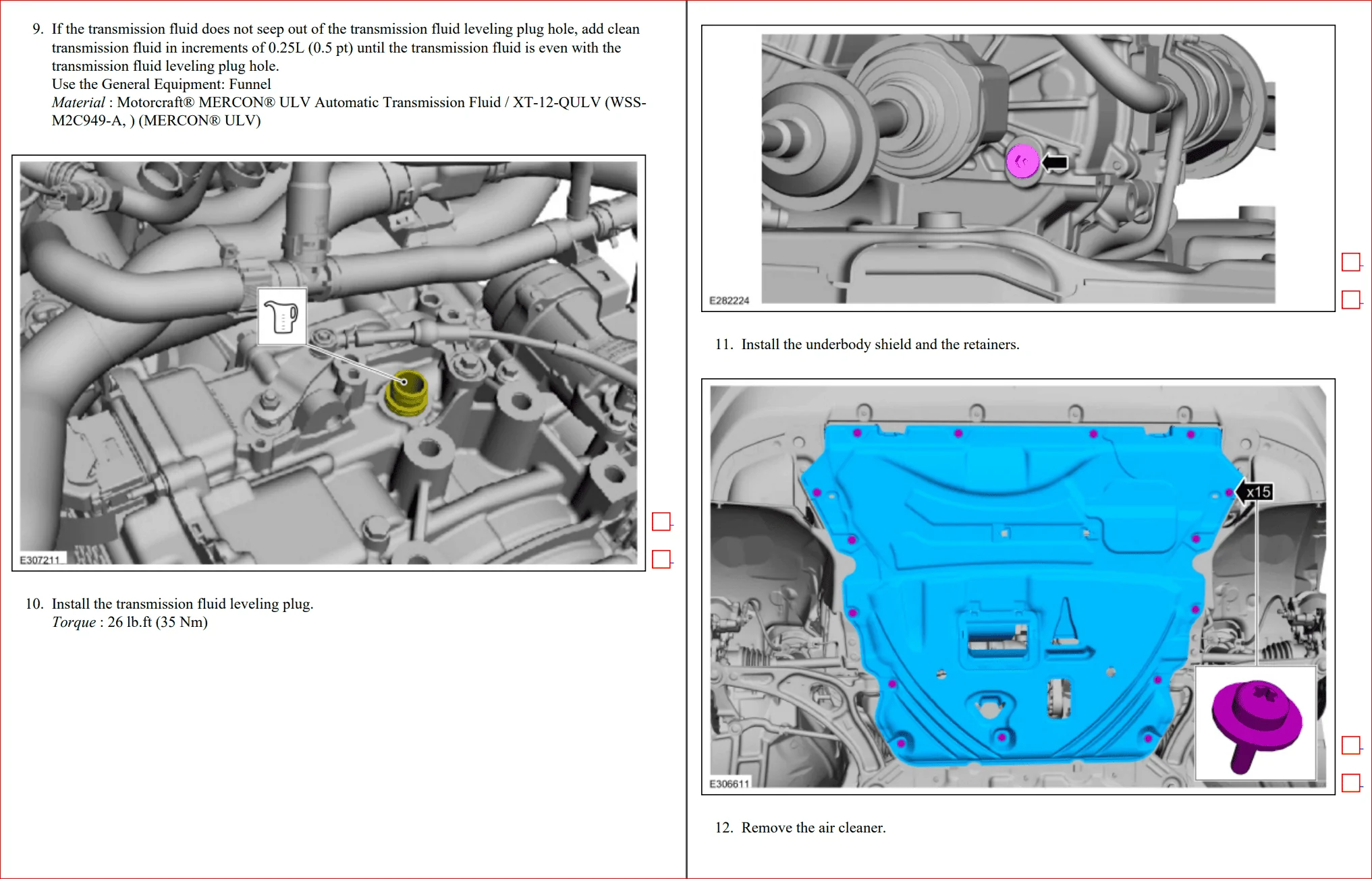

Ford Maverick Transmission fluid check and service, with torque specs (per the Service Manual) check 004.PNG
Ford Maverick Transmission fluid check and service, with torque specs (per the Service Manual) Swap 001.PNG
The rest of the procedure for the fluid exchange is the same as the fluid level check.

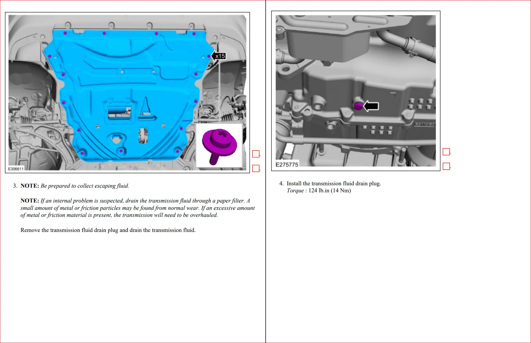

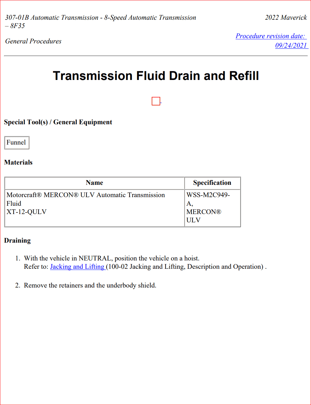

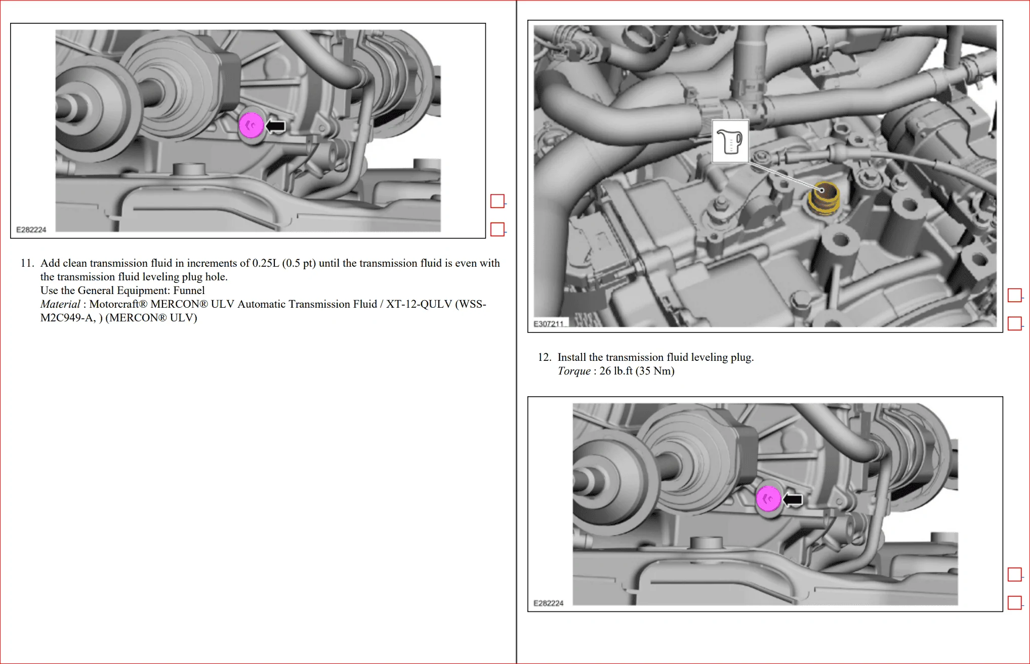

Now the drain and refill procedure:
Ford Maverick Transmission fluid check and service, with torque specs (per the Service Manual) 001.PNG
Ford Maverick Transmission fluid check and service, with torque specs (per the Service Manual) 002.PNG
Ford Maverick Transmission fluid check and service, with torque specs (per the Service Manual) 003.PNG
Ford Maverick Transmission fluid check and service, with torque specs (per the Service Manual) 004.PNG

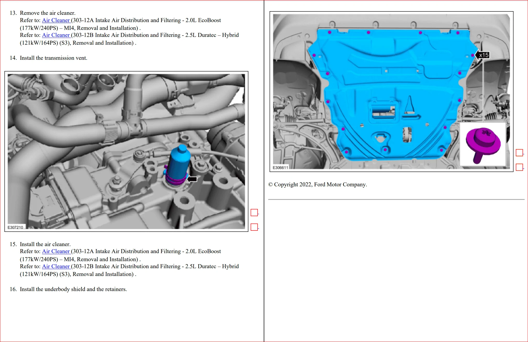

Ford Maverick Transmission fluid check and service, with torque specs (per the Service Manual) 005.PNG
Ford Maverick Transmission fluid check and service, with torque specs (per the Service Manual) 006.PNG
Pretty simple procedure. I'm sure you can skip the step that calls for using something like Torque to monitor the TFT PID (temperature), but it does need to remain at operating temperature during the procedure.
Hope this helps.

Thanks for posting this. It confirms that it's as simple as an oil change.
The only thing I would do different for a drain + fill is open the fill first. That way you know that you can fill it up. If you drain it and you cannot open the fill, it's not going to be fun

It's very easy to access the fluid level plug on the side of the transmission. You can get to it by simply turning the drivers side wheel outwards and using an extension to reach it.
Also a good idea to invest in a spring clamp plier that locks to make removing and replacing that vent cap easier.
Just food for thought before you tackle this job.
