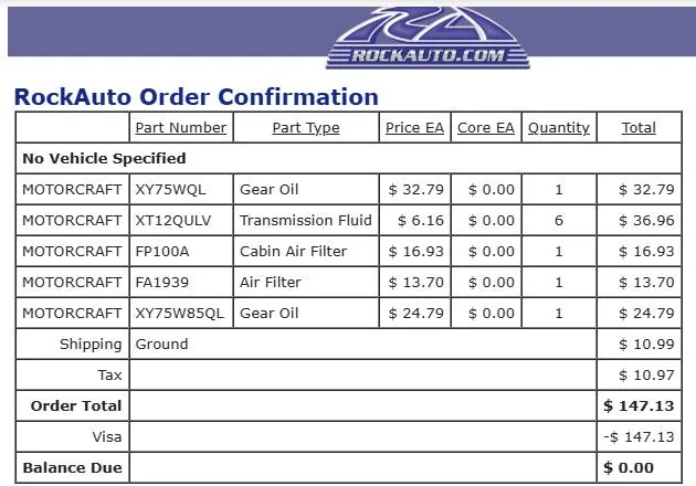

Of course use your own judgement. I think I will probably just do one drain & fill per year. I run about 10-12K miles per year on my Maverick and I've stocked up on a couple of the $25 5-quart jugs of ULV from RockAuto.

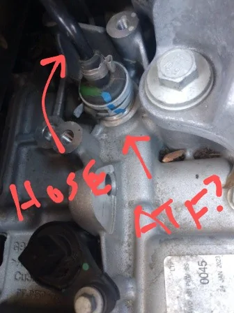

One tip I read here was that the air filter housing doesn’t need to be removed to access the fill vent hole. That’s true, but when I tried it, the fluid struggled to flow in since it couldn’t vent properly and air bubbles built up. If anyone has found a better workaround, I’d appreciate the input. It saves some effort not having to pull extra parts, but the fill process was far from smooth.

Removal of the air box is fairly painless when the alternative is leaving it in place and messing with all kinds of weird angles to get the clamp off, imo.

I agree with @bgn. The air box is so easy to remove from the Mav, I'm just going to keep removing it. Twice that is, once for filling and another for topping off as needed after heating up the fluid. I use an OBD reader to ensure it's up to temperature before reading the level, and it takes quite long drive to get to the 185 degrees minimum required for checking.
I do skip one step you showed--removing the top of the air box. I just loosen the clamp, unhook the sensor and its clip, pull the two clips for the snorkel, pull out the snorkel and yank the box.
