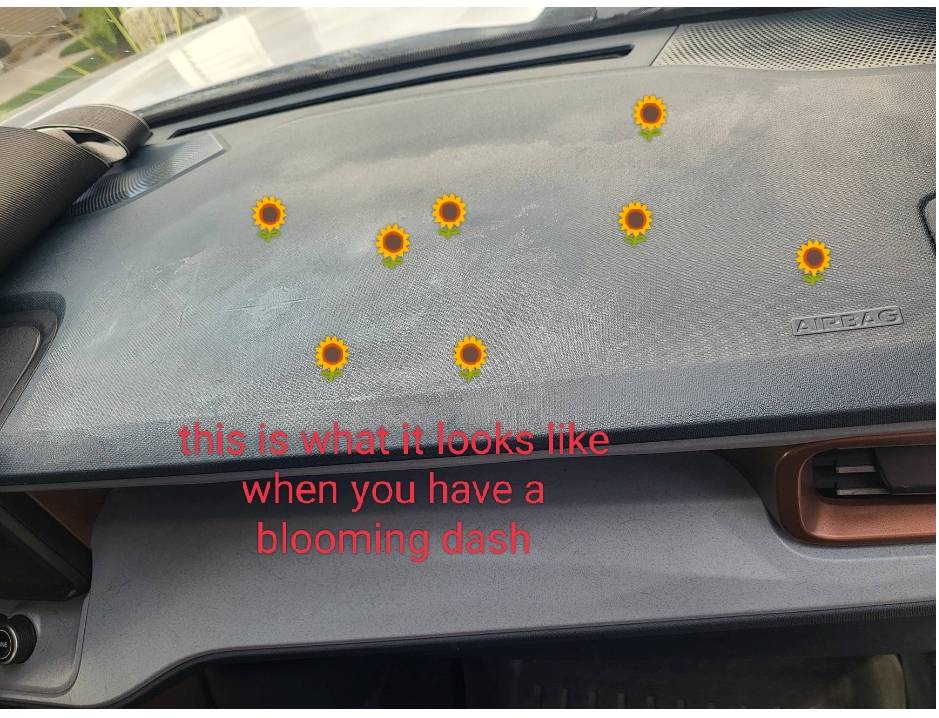

Ford Maverick Great Truck but..... Issue with dash quality. Many vehicles and this never happened before. 1729807167820-2t

Have a dash cover because of the “ sticky dash” problem that is common with some Mavericks. Dash is still a little tacky under the cover but nowhere near as bad as when the full sun was beating down on it without a cover.
Didn’t even realize I had a sticky dash until I saw one of the posts on here and checked mine and sure enough I had the problem.
I’ll go out in the morning to check for discoloration under the dash cover.

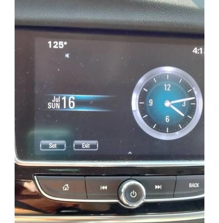

My wife's dash on her Escape isn't sticky and hot weather.
My Buick Encore's wasn't sticky in hot weather.
I would consider 125° hot weather.

Dashboards right?
My wife's dash on her Escape isn't sticky in hot weather.
Maverick dashboards only. Never seen sticky dashboards on any other vehicles to include Ford.

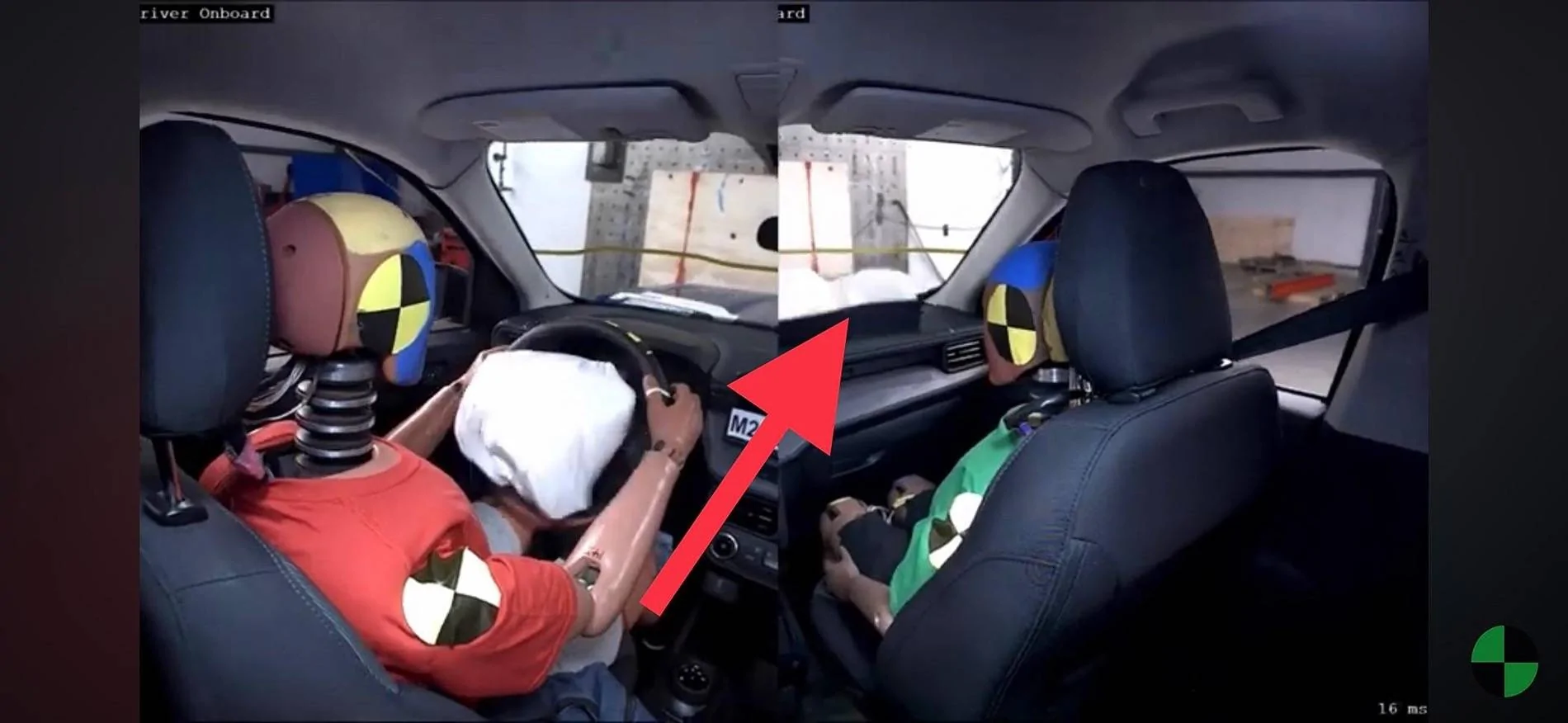

Could you imagine having someone in the car with you like a coworker that is just an acquaintance, not a true friend, then you get in a car wreck and your dash pad hits them in the face at 100 mph causing multiple facial fractures or blindness, then they sue you for negligence for putting a dash pad cover over the air bag deployment area?

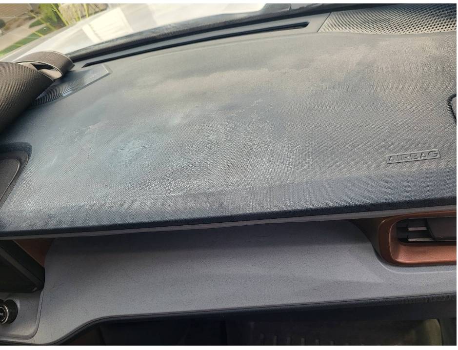

Ford Maverick Great Truck but..... Issue with dash quality. Many vehicles and this never happened before. IMG_1709

A sticky shiny dashboard is the result of car manufacturers reformulating the polymers in their dashboard plastics to be more “green-friendly”.
The new formulations break down prematurely due to ultraviolet exposure from the sun and heat cycling. This causes what is called “blooming”. Where the broken-down polymers inside the dashboard material work their way up to the surface of the dash.
See link below on how to clean and fix.
Nope can't imagine it happening.
My dash pad is a lot softer than the canvas air bag. My dash pad is just laying on my dash, not even taped.
The sticky dash holds it in place.
Then again if we are "What IF'ing" things.
What IF after years in the sun. The dash becomes brittle and the plastic breaks? I would rather have the dash pad in between me and plastic shards.
What IF the air bag igniter is bad as in "takata" and does work properly. At least there's dash pad cushion the impact.
I was a volunteer Fire chief/EMT for over 20 years. Our district was busy and I'll bet I have responded to a few hundred vehicle crashes, many with bag deployments. Those dash covers won't be an issue. They attach to the dash with a few strips of small velcro, with cheapo glue that barely holds the cover to the dash. I have seen a few dash covers after bag deployment and most end up smashed to the inside of the windshield. Also, the detonators are VERY powerful and honestly, many times the folks in the car can get some fairly serious facial injuries from the bags them selves. We had to take classes on how to deactivate (can't do it on some of them) the airbags, as many first responders have been seriously injured and killed while extricating people out of the vehicles. We never had it happen, but we were always thinking and being careful around those things. Dash cover hurting someone? Nah.
