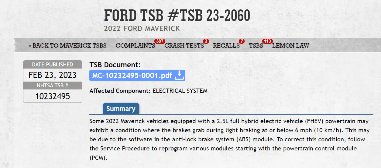

I'm not super worried about getting the emissions recall done, from my understanding, it essentially just said at highway speeds, the maverick could increase its emissions output or something. That doesn't sound like an issue really, and our truck has spent 90% of its life driving at slower speeds. But I'm glad that addresses it as well.
I wasn't worried about it, they just did it. I have not had any previous TSBs installed. Ford just combined a bunch of updates into one, which saves you time, especially with some of the stubborn service advisers. I swear each one gives me a different story when I book an appointment, or visit the dealership.
