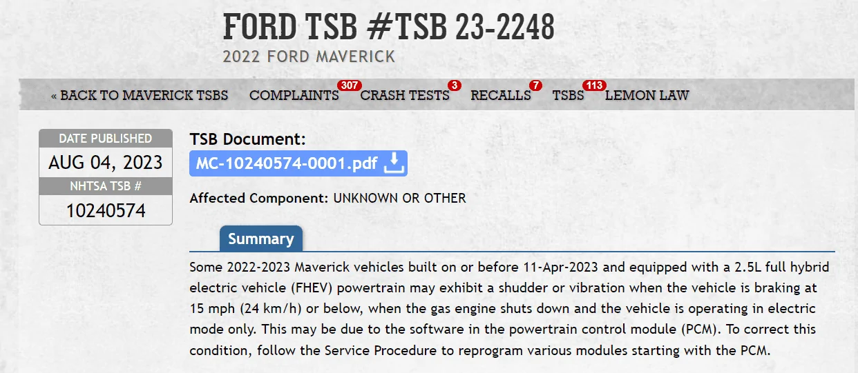

I have a 2022 and it has the grabby / inconsistent low speed braking issues. It was "fixed" at a dealership, but then came back over time.
I really hope there is a permanent fix, because it's probably the one thing I dislike most about the truck so far.
Does anyone have a TSB number for this fix?
EDIT:
I think I may have found it. Looks like TSB# 23-2248.
The most recent update comes combined with the emissions recall, so it's not a TSB, it updates a bunch of modules, including the ABS module, as pointed out earlier in this thread.
Campaign#
23E09
Thread covering the recall
https://www.mavericktruckclub.com/f...rick-grabby-brakes-at-or-below-6-2-mph.24977/
Edit: Posted above, 23E09 emissions recall covers this as well I believe.
