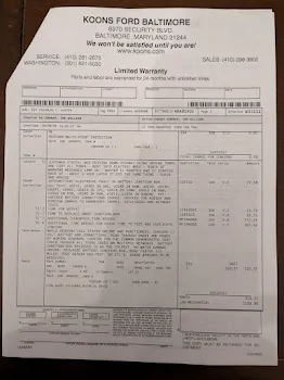

I picked up my 2022 Maverick Hybrid from the dealer today (they had it for eight days) showing they tested for the loss of power problem and replaced the Smart Junction Box aka the Battery Junction box they believed to be the culprit, road tested 121 miles and issue appears to be resolved. I couldn’t find anything about new or repeated software downloads that I thought they might also try. So time will tell if the Battery/Smart Junction box was in fact the culprit causing my truck to lose all power twice going 70+. See the service invoice attached.
4/17/24 update - Ford is recalling 450k SUVs (Broncos) and Trucks (Mavericks) because they could lose driving power. Also attached is a clearer image of my repair order;
https://www.kbb.com/car-news/ford-recalls-450000-vehicles-over-loss-of-drive-power/
Ford Maverick Hybrid problems after recalls done (software based) Maverick-RapairReceipt

Downloaded your photo. Still to small to read and when I made the photo larger, it got even more blurry.
