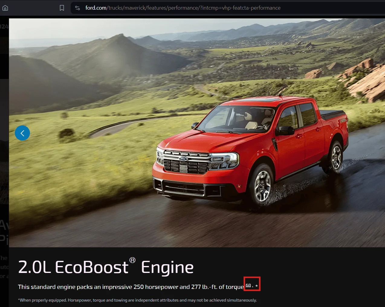

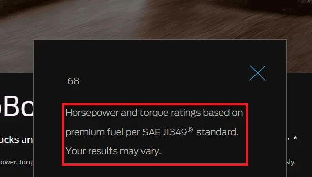

The EcoBoost power ratings (250hp / 277 ft lbs/torque) are established using premium fuel. Here you can see right from Ford's very own website:

Click 68:
Ford Maverick Gas consumption question 1710249258461

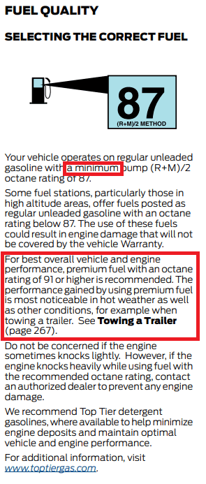

Per the owners manual - 87 is the minimum grade fuel that the 2.0 EcoBoost can run on. For best performance 91 or higher is recommended.
The EcoBoost is mapped for a 91 octane fuel. Using anything less with detune your EB (by retarding timing). Using 87 likely causes a 10-15% reduction in power so you're looking closer to 220 hp/245 ft lbs torque.
