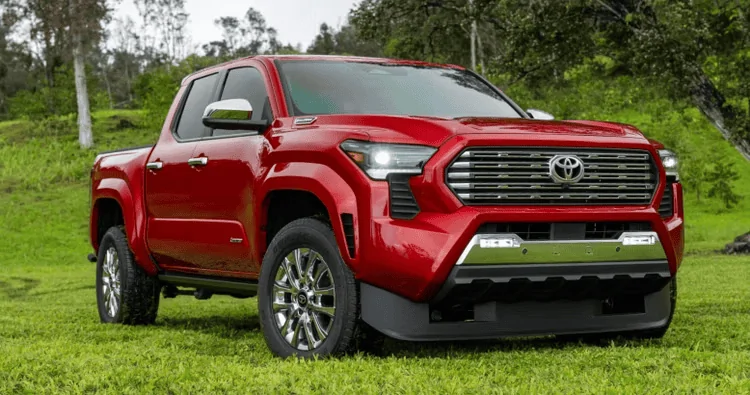

You don't have to believe me though - here is the chief engineer for the 2024 Tacoma, Sheldon Brown:
"The air dam is part of the aerodynamic package. These trucks, we've lifted them pretty tall, they got wider, they got a little bit taller, that means our coefficient of drag x area increased which means the drag on the truck increased"

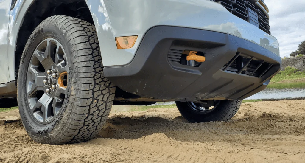

Ford Maverick Gas consumption question 1699895515326
The Tremor does not have the air dam chin which leaves the tires and underbody open to wind, turbulence, and increased drag:
(Tires are completely exposed)

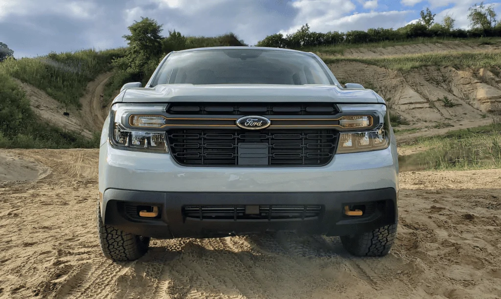

Ford Maverick Gas consumption question 1699895591506
(Front fascia angles up at a 30+ degree angle pushing air down underneath the it):
Ford Maverick Gas consumption question 1699895671951
Compared to an FX4 with the upgraded tire package, you can see where the FX4 has the lower chin which goes out of its way to protect and cover the tires, and the front fascia comes straight down to the chin which significantly reduces the amount of air underneath the vehicle (ie drag):
Ford Maverick Gas consumption question 1699895854387
Tires impact city MPG the most
Drag/aero impact Highway MPG the most.
