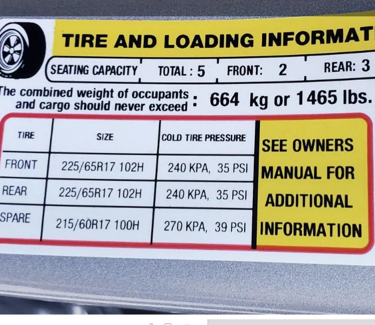

Looks like all Mavericks come with two different spare tires:
1. a space saver spare tire, donut, or temporary tire, size T155/70D17
2. If you purchase a hybrid or pay extra for a so called "Full Size Spare" surprise, the size is 215/60R17 . This is not the same as the OEM tire/rim on any Maverick.
Please note, the spare does not have a Ford OEM TPMS factory sensor.
This information is shown on the Placard located on the driver side door jam.

I just got a flat on my 2024 lariat hybrid and I was told I have a full size spare but when I lowered it down from under the bed of the truck it is not a donut but the size is 215/60/R17 and the factory tires on my truck are 225/60/R18.
My question is why is the so called full size Spare smaller then the factory tires that came with the truck.

There are many posts on this already. Basically spares are:
1) Donut - 155/70/17
2) Ford's full size spare 215/60/17 - on steel rim(same rims that come with XL)
If you want true full size:
1) Swap out the Ford's full size spare with a 225/65/17
2) Buy 1 wheel from many XL owners who swapped out for the alloy rims
3) If you want exact, you need to go find another rim and exact tire
Note: The full size spare does fit the spare wheel well under the truck
