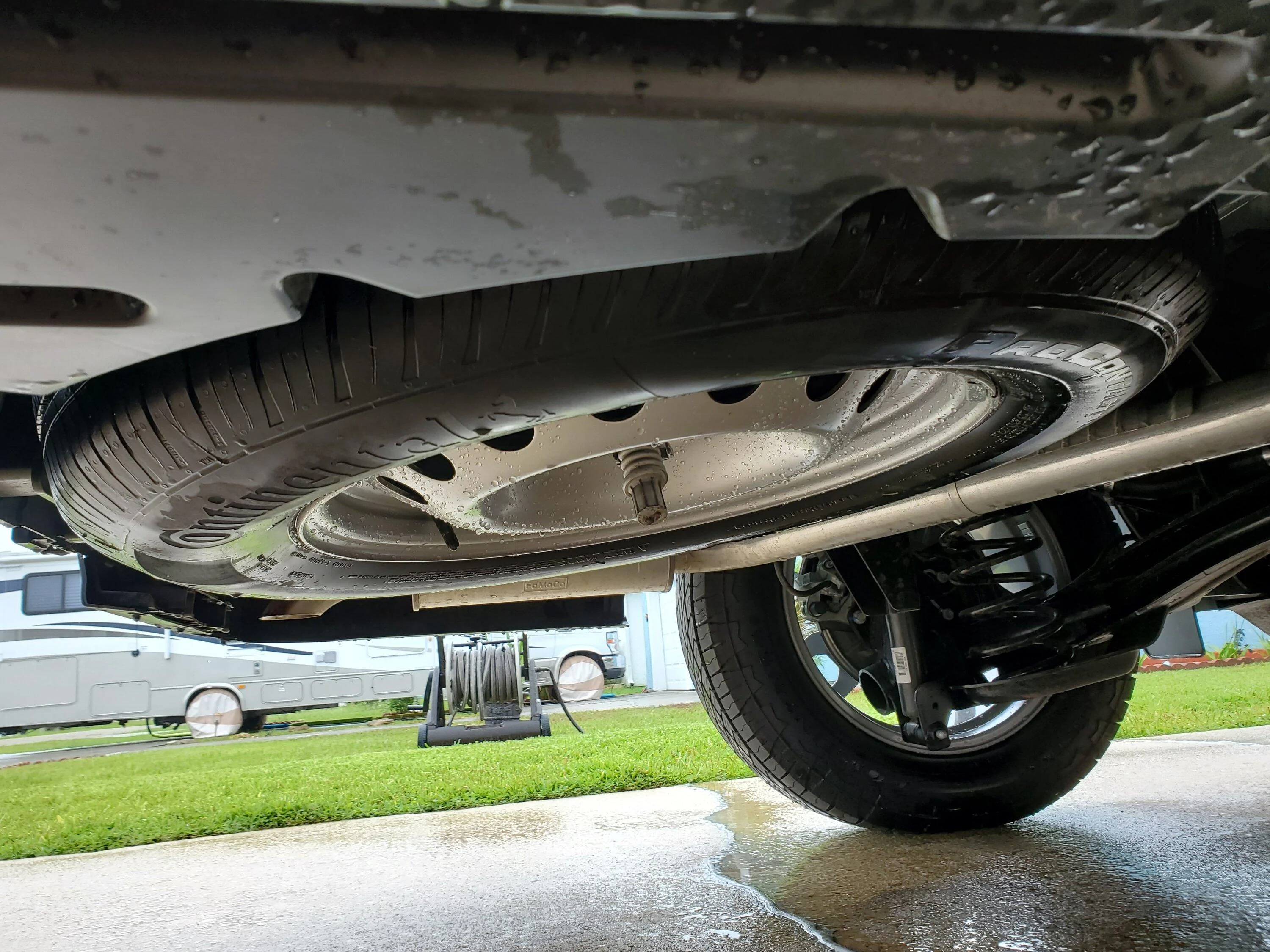

The drivers side door jam placard says it all ! Its misleading to call it a FULL size spare or worse, pay extra for one.
Here is a pic of a TRUE FULL size 17 inch spare.
Ford Maverick This is a full size spare? full size spar
so. there's normally a tire deflation device in there that prevents a ~29" tall tire like the Mav uses from fitting. I didn't engineer the thing, but I assume Ford wants the tire to go flat so that it'll crumple properly in a heavy rear-end collision.
did you remove the deflating spike?

Thanks—I probably saw some of those same posts about the teeth (they got undercoated with Fluid Film recently, along with the rest of the truck). At least some of those posts were AWD and 4k towing. I have the hybrid with “normal” tow package, and while I can’t speak for the other builds, I have a good 1.5 inches, maybe even 2 inches, before it hits the receiver. I had the spare tire dropped and out of the way while undercoating, and when I put it back up I pushed it fwd gently into the teeth so that the tread just kissed them. I could probably push fwd just a hair more too, without having to do anything to the teeth. But a 225/65R17 is ballpark about 1.3 inches larger than a “full size” spare of 215/60R17. If it’s THAT close, I’ll put on a used 225/65R17 but I’m not too worried about fitment. Heck, the OEM Continental tires count as used right out of the box, considering it only comes with 8/32 tread new anyway. A real tire would have about 12/32 new.

interesting. I'm not sure if it was a FWD or AWD model, but there was a thread a while back where someone tried to put a factory 225/65-17 on a steelie in there and the deflation spike was in the way.
