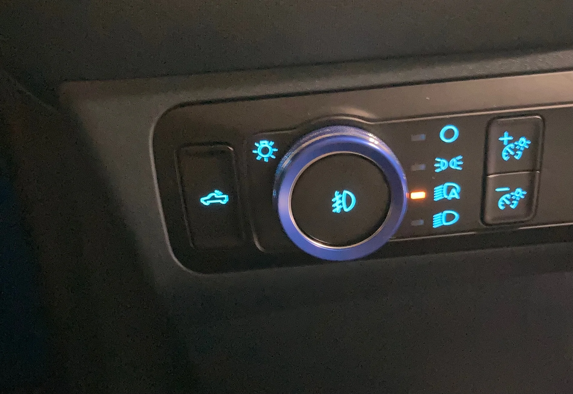

The on/off button for the Lobo Foglights fyi…
Ford Maverick Foglights for 2025 Maverick Lariat? IMG_0056

So the question is, what's going on behind that switch and where do all the wires go?
Most of the switch, including the Fog button, share a LIN bus instead of using discrete 12V signals.
