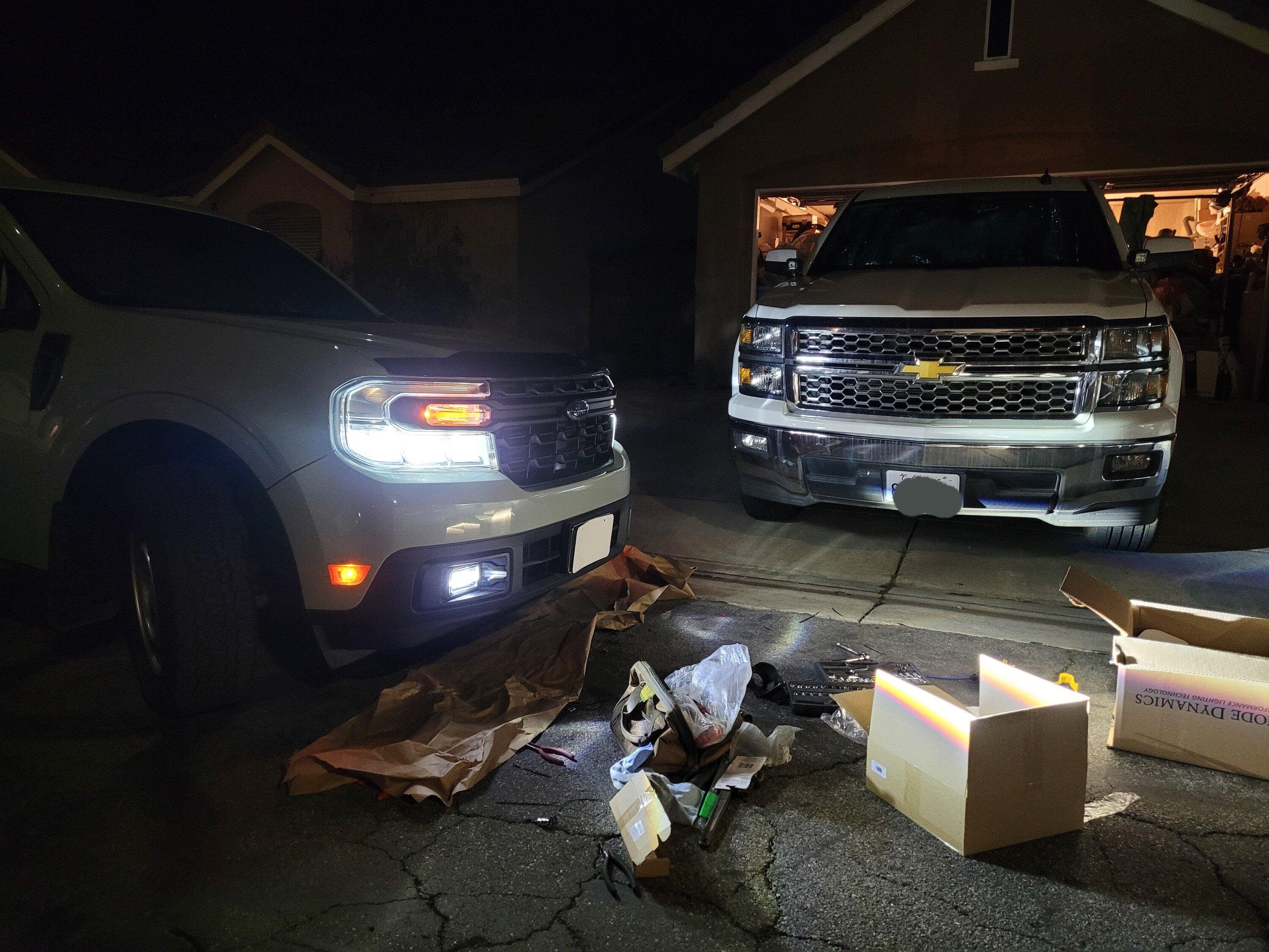

I have to admit that these DD fog lights are much better than I thought they would be. Looking at them from the vehicle front you wouldn't think they would project much light but looking out from the inside I can see the extra amount of light down in front of the vehicle and towards the sides that the low beams do not cover. They definitely work better than I though they would being recessed that far into the front bumper area. I just wish the amber backlights were brighter since they are somewhat dismal compared to my other running lights.

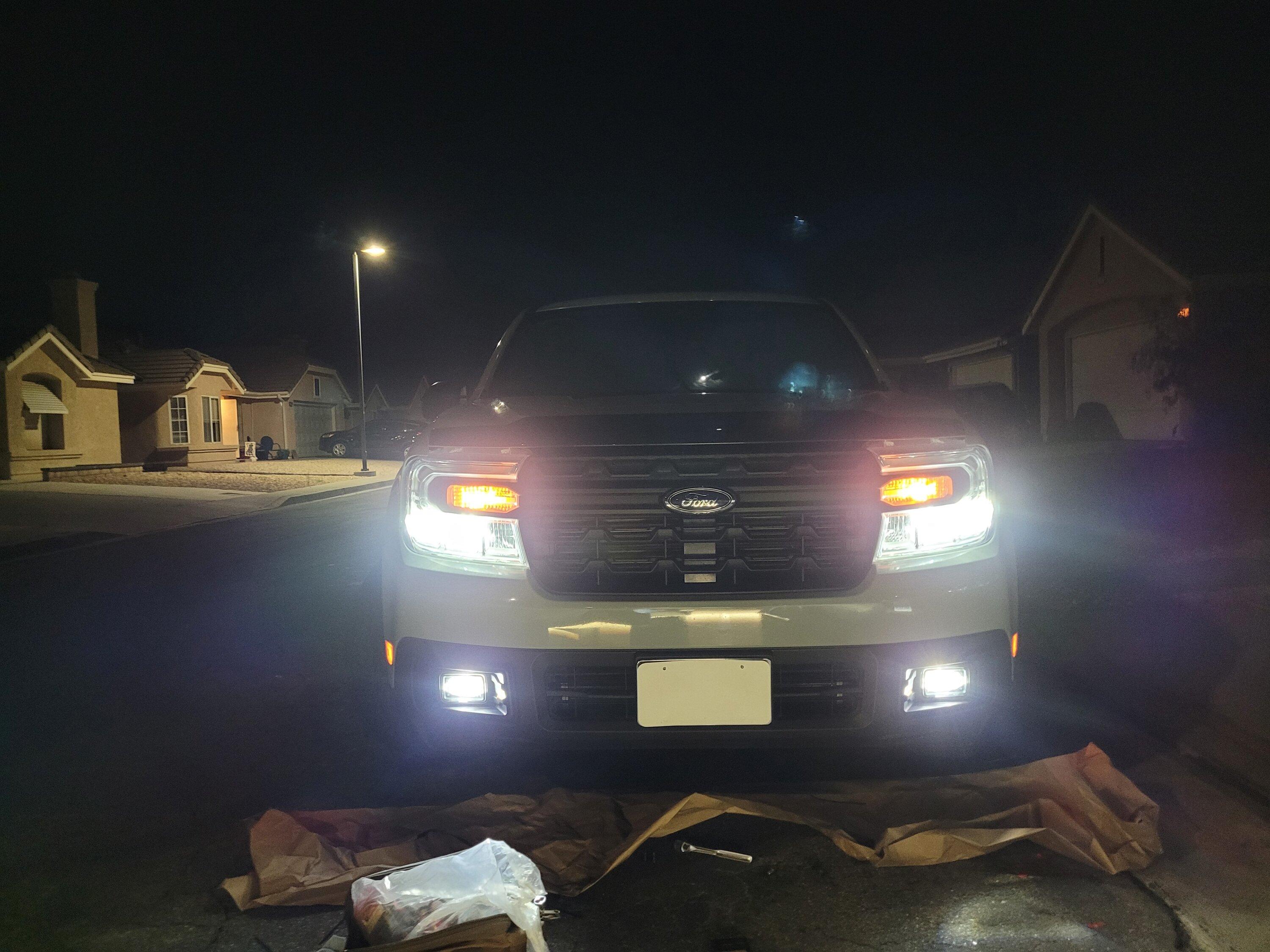

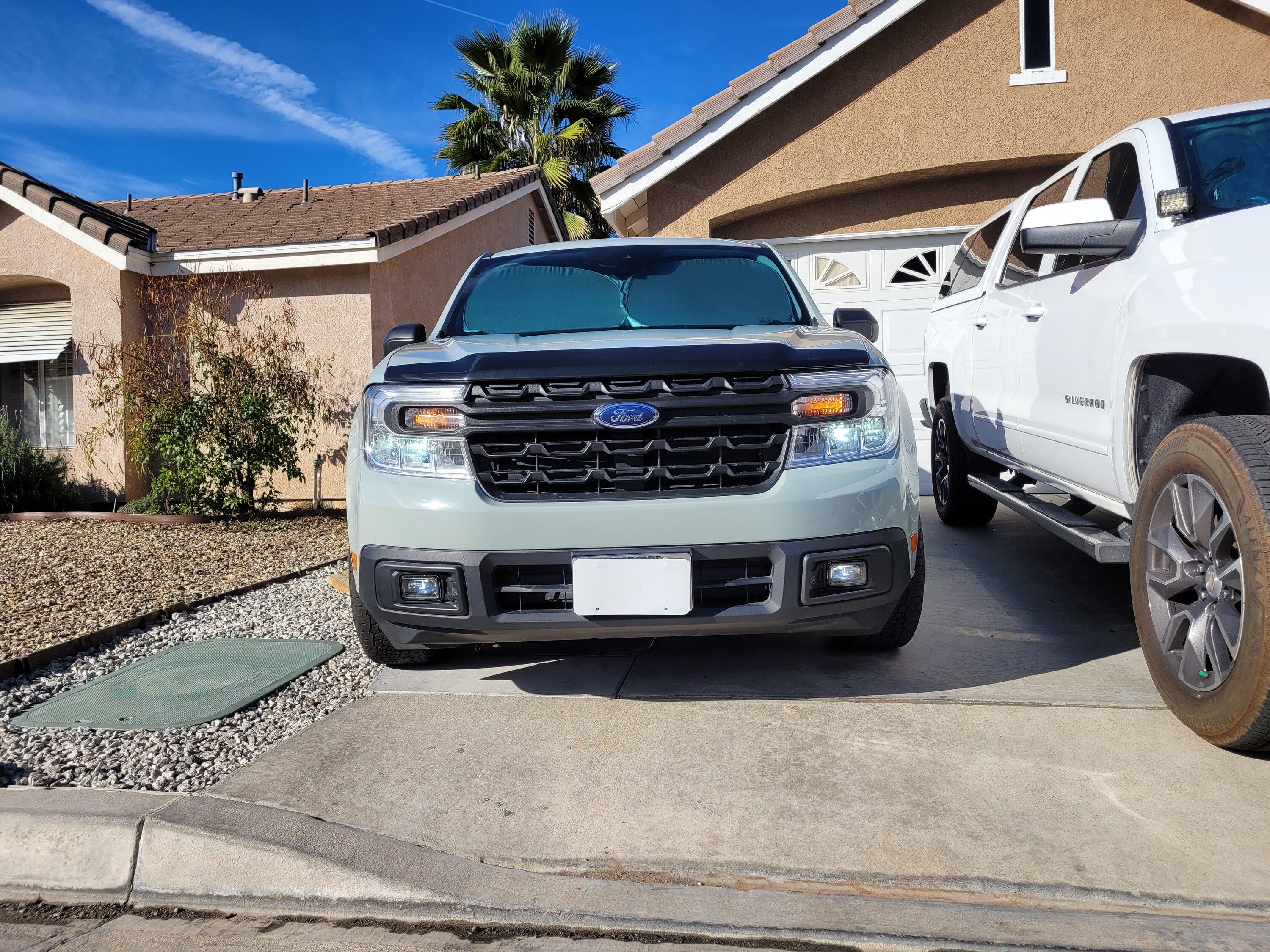

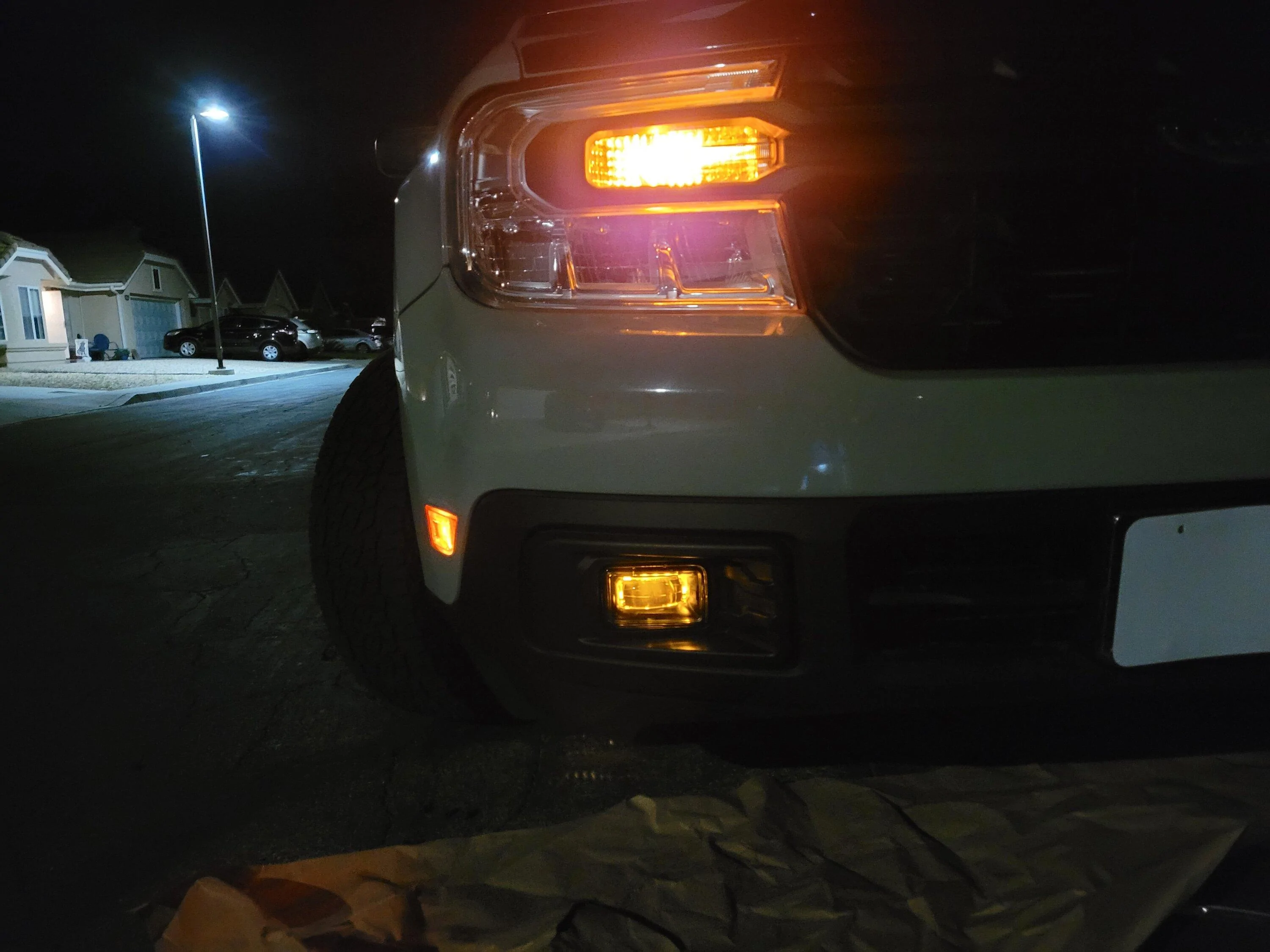

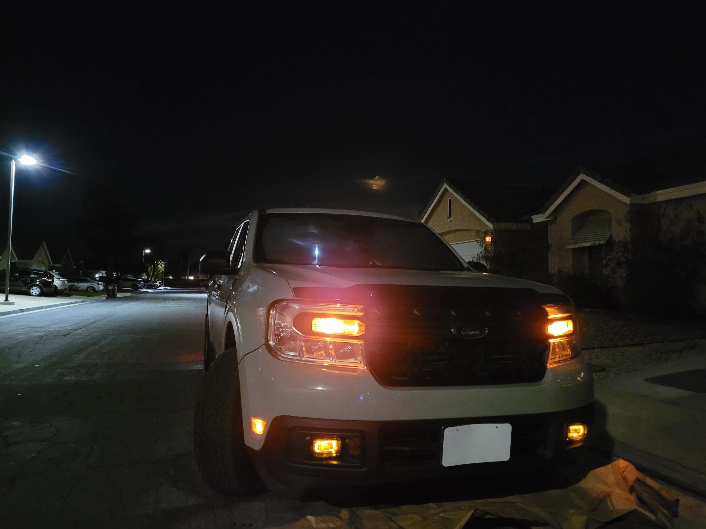

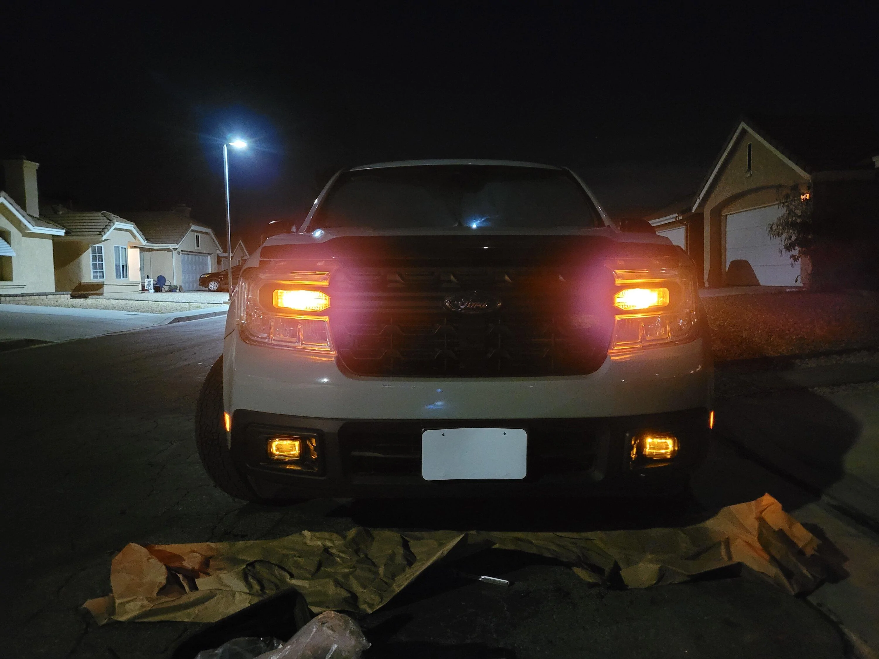

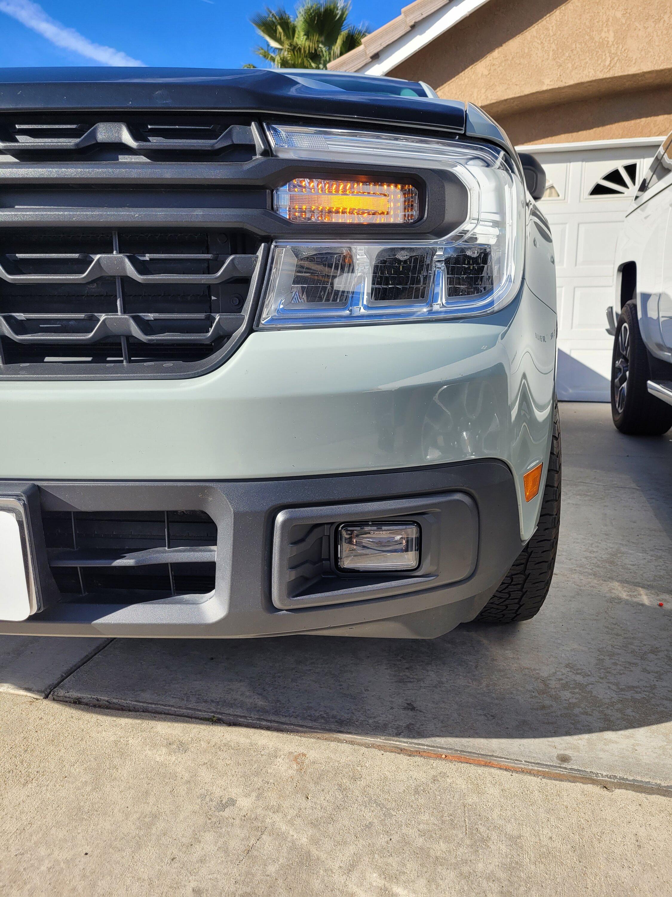

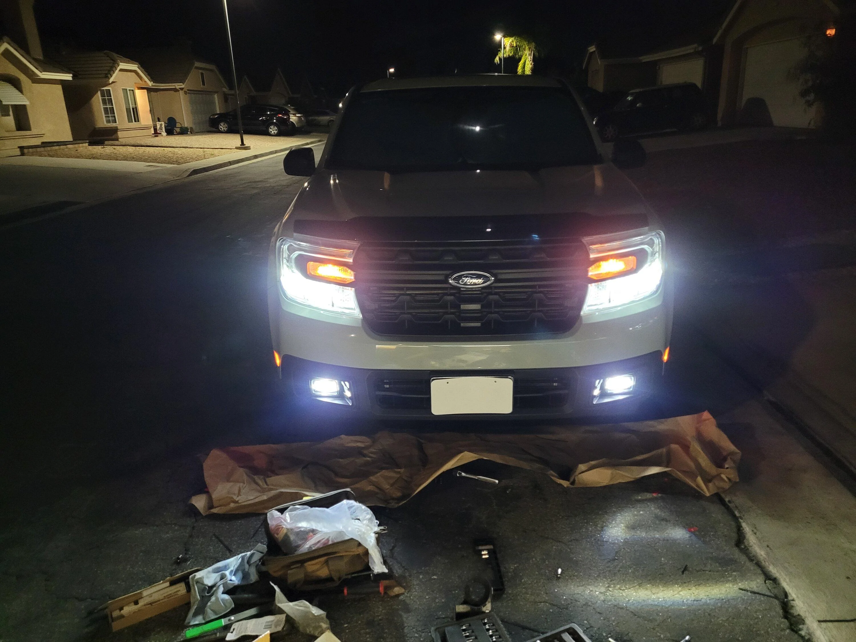

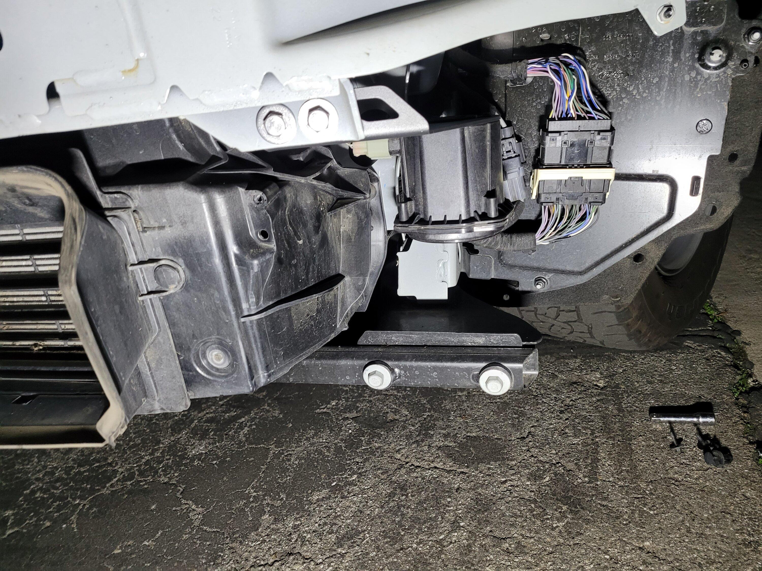

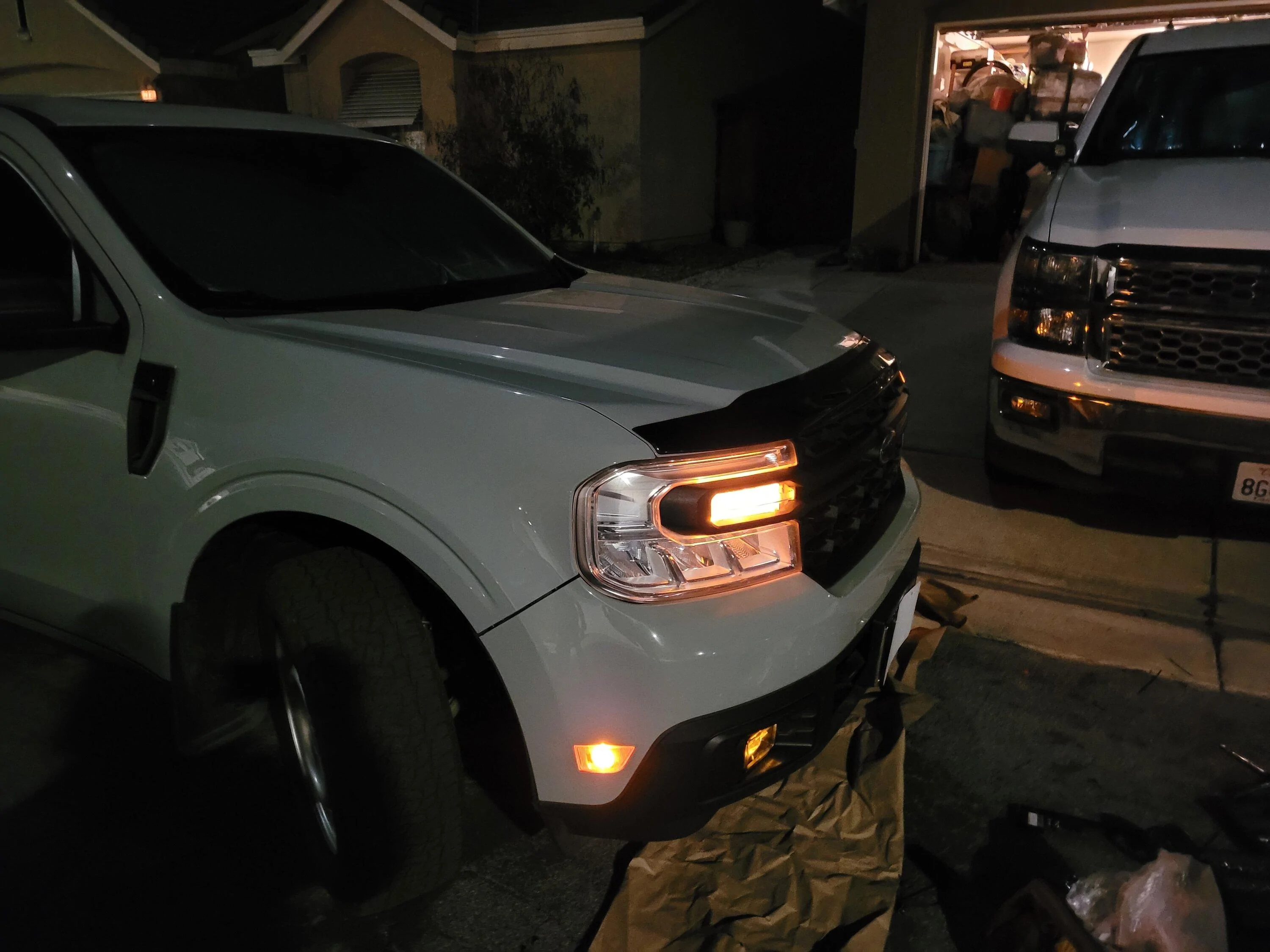

BOOYAH πŸ‘ŠπŸ½ 😁 πŸ‘πŸ½ πŸ‡ΊπŸ‡Έ to all the guys at Diode Dynamics. They came out with a great kit for the Maverick.
It looks great the light is awesome. And I still can't believe it. The new daytime running light addition ✨️ just adds even more reason to love your truck.
I attached some some photos, of course a lot of them lol.
(DAYTIME SHOTS TO FOLLOW)
