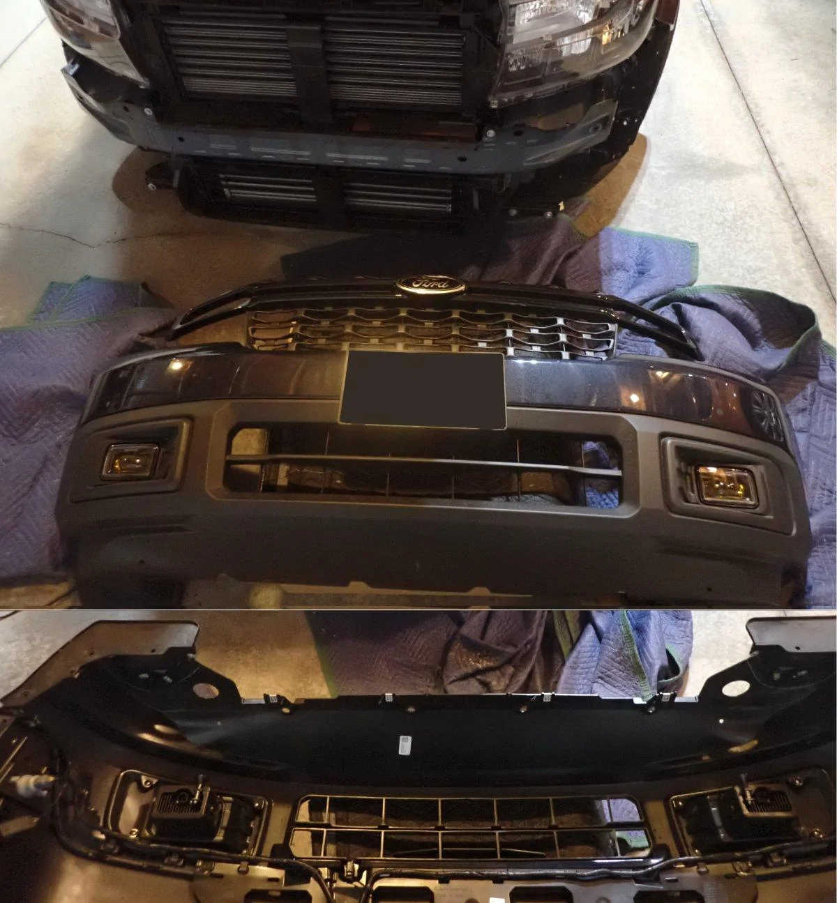

My ambers arrived today. Got them mounted in the bumper. Tomorrow I'll wire them and put it back together.

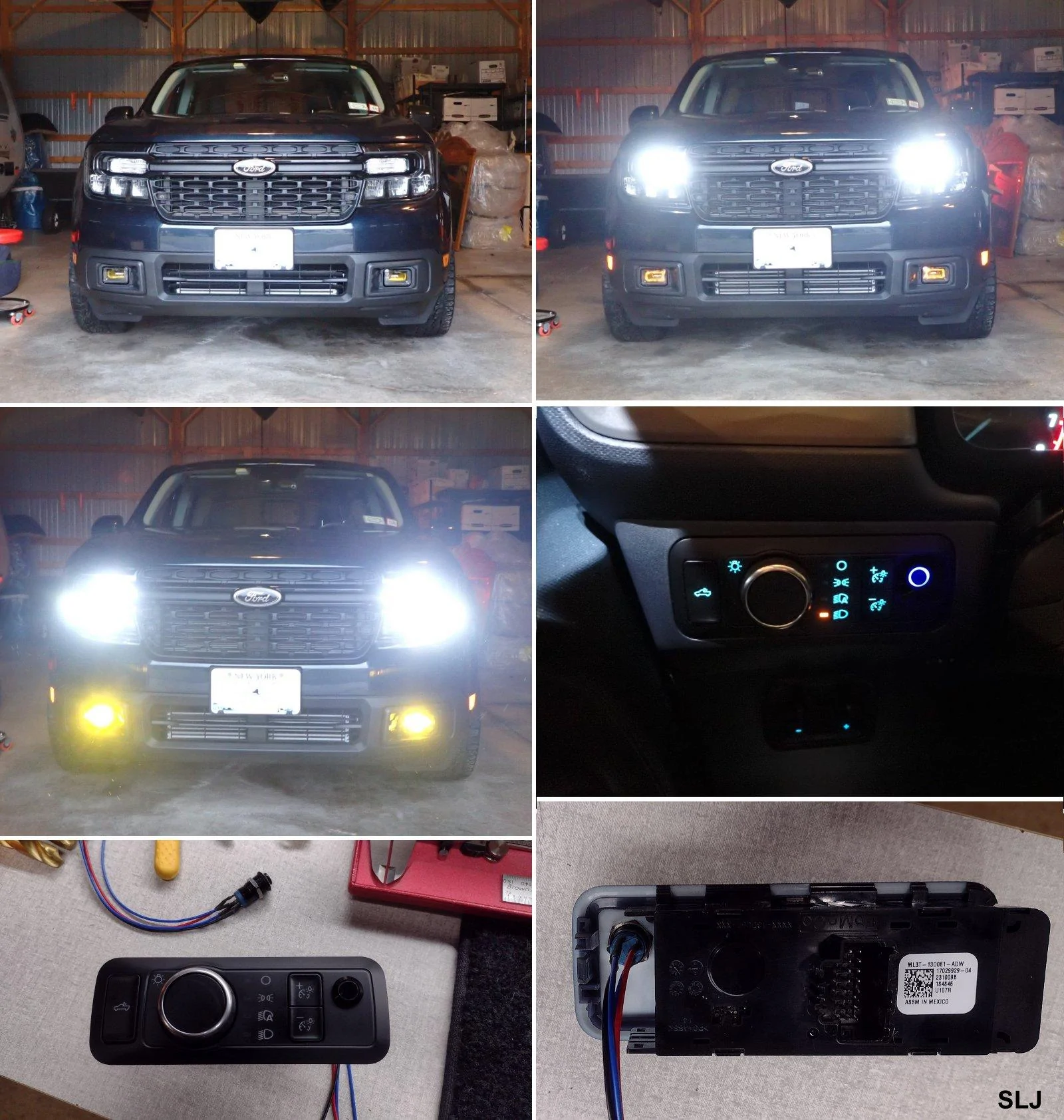

Can you provide an additional information about the included switch? Is it a 2 or 3 position rocker? are the wires for it essentially a positive, negative, and ground? I'm thinking of using a different switch instead of what they included.
They provide a single pole single throw (3 wire) with an LED for 12 volts. I'm wiring mine up tomorrow with a different switch. I'm guessing it's ground for the LED and 12 volts switched to trip a relay so ground-12Volts-12 volts return to the relay.
I'm not positive but that would be the way to make the LED in the switch work. I will be checking mine tomorrow after everything is wired as I'm planning on using a different switch also.

Done!
Ford Maverick Foglights Finally Diode Dynamics Fog Lights
