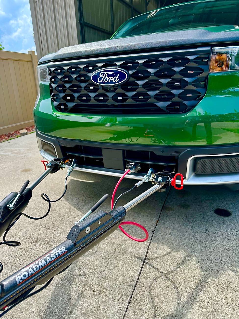

I finally got the Roadmaster kit on my 2025 Lariat Hybrid and took is for a short run with the RV. Everything worked great and the Mav towed perfect. Now I'm planning my first long trip with a toad.

No major modifications required I just post a photo of the finish product it looks great I am so happy
Nice install! However, it does appear you removed the lower shutters like it shows in the Roadmaster instructions.

Thank you Kyle yes - I don’t see removing the lower shutter being an issue after talking with the installer who has a lot of experience with this modification and understanding it’s purpose

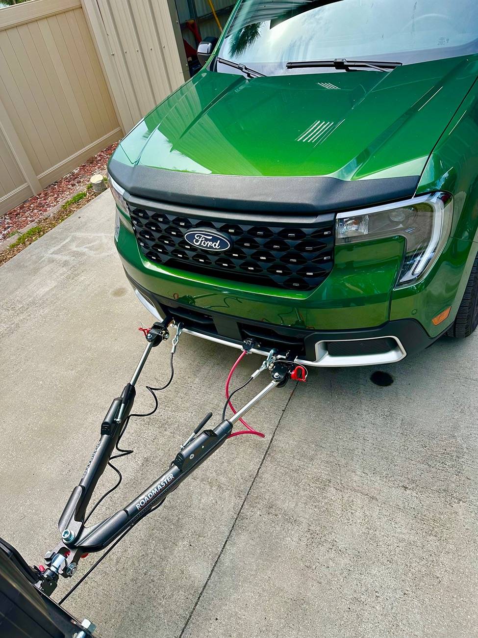

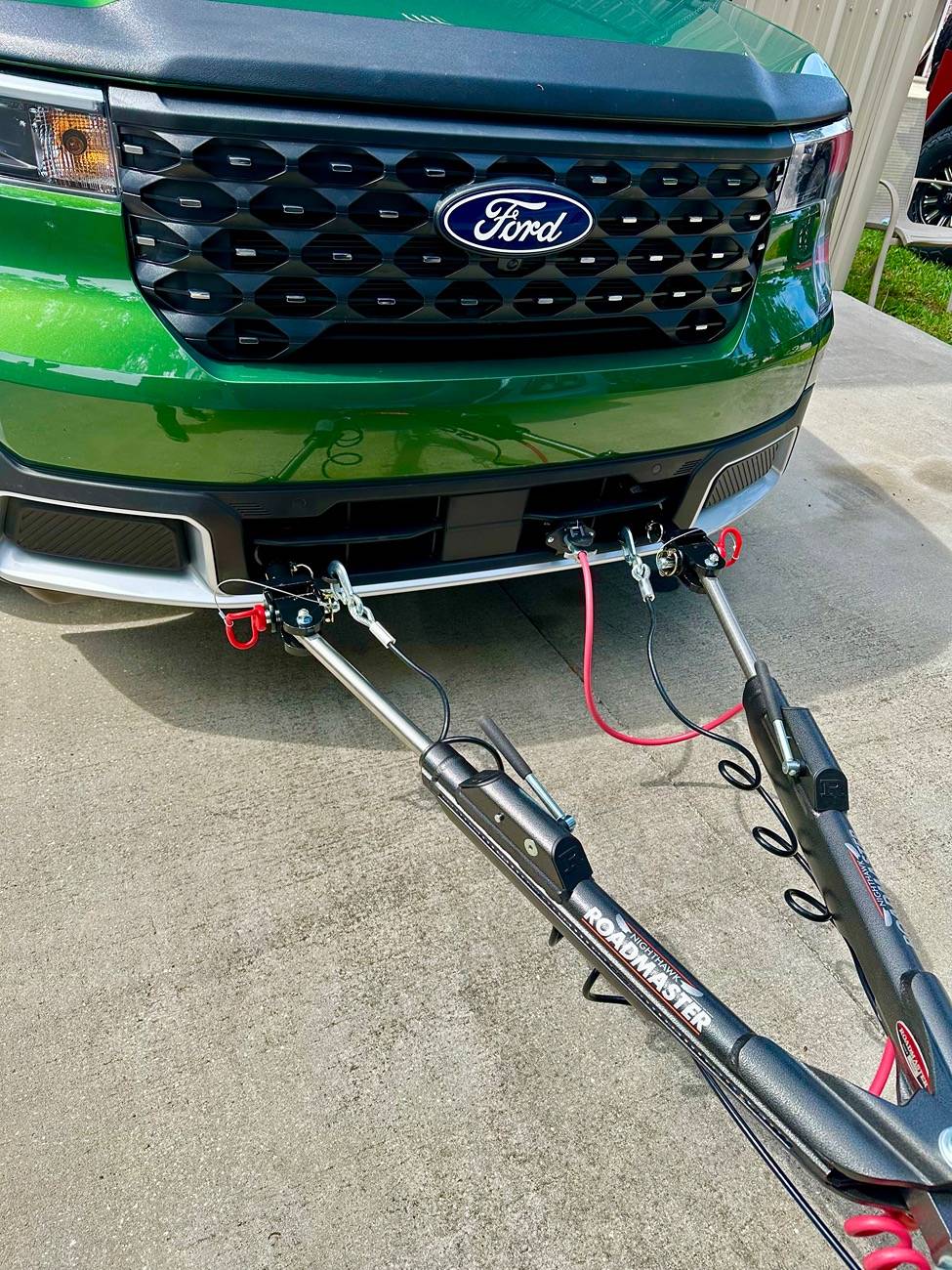

Connected the 2025 Maverick to the MotorHome today - everything went well no issues, I love this RoadMaster Set up - I now am working on modifying my BlueOx KarGuard (Rock Guard) brackets to fit on the RoadMaster TowBar looks like it will work more pics and details to follow…

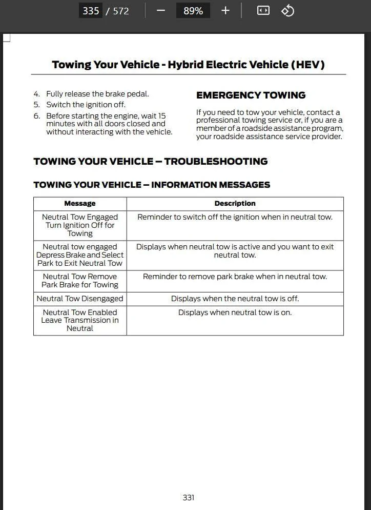

I just joined after lurking for a month or so to try and get more information on the 15 minute requirement that's new for 2025. I do see it in the 2025 Maverick owners manual online:
Switching Neutral Tow Off
  1. Switch your vehicle on in accessory mode.
  2. Fully press the brake pedal.
  3. Shift into park (P).
  4. Fully release the brake pedal.
  5. Switch the ignition off.
  6. Before starting the engine, wait 15 minutes with all doors closed and without interacting with the vehicle.
MasterChief - can you clarify if you've had to push the truck to get it out of the road within those 15 minutes? If so, I assume you're leaving it in neutral tow mode after disconnecting to do so?
Has anyone asked/gotten a response from Ford about this? We're shopping for our next flat-tow vehicle and really like the Maverick as an option, but that requirement would take the 2025 off our list.

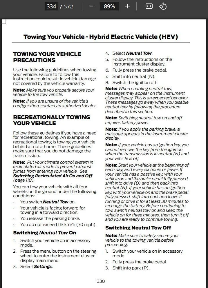

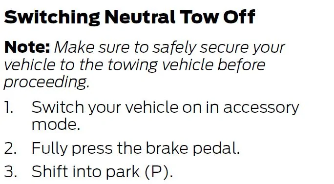

I think you missed the note on page 330.
Note: Make sure to safely secure your vehicle to the towing vehicle before proceeding.​
It will take you 15 minutes to disconnect the tow bar & put it away. I also would do a walk around both vehicles to make sure everything is secure.

Page 334 of the 2025 FORD MAVERICK Owner’s Manual Printing 2 (PDF)
Ford Maverick Flat Towing the 2025 Maverick AWD Hybrid 1750025285782-0
Ford Maverick Flat Towing the 2025 Maverick AWD Hybrid 1750025616689-qa
I checked the 2025 FORD MAVERICK Owner's Manual HTLM version does not have that note:
