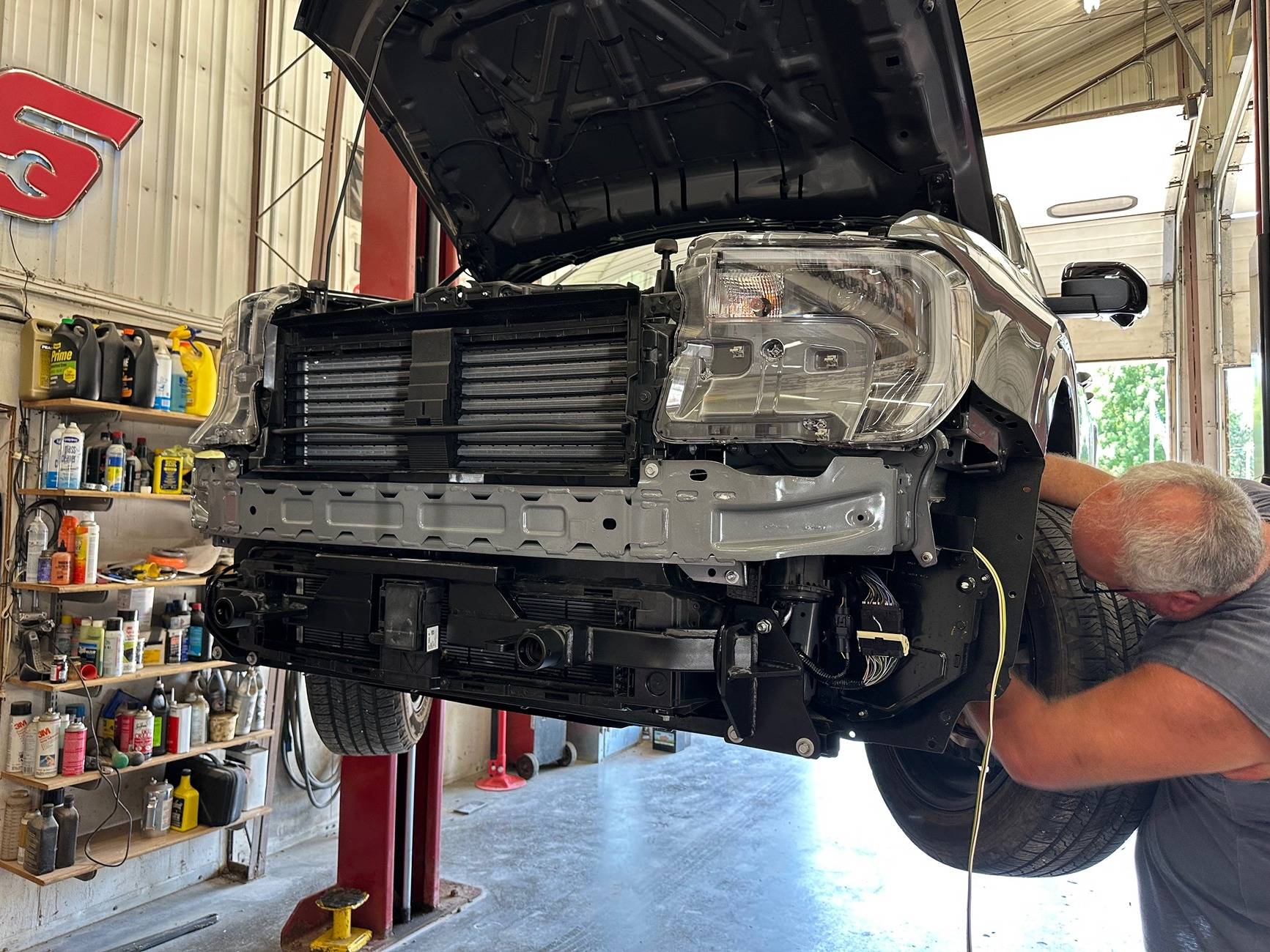

Today I'm having the install for my Demco base plate (and stay and play) completed. Took DDK's experience and recommendation, and I'm having it installed at Bruce's repair in Matlock, IA. The guy knows his stuff.
