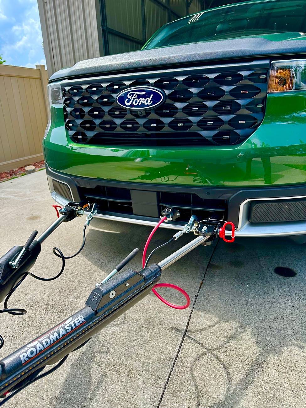

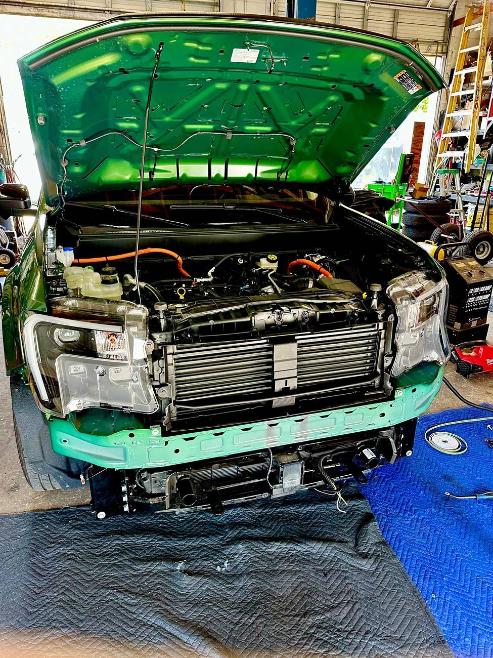

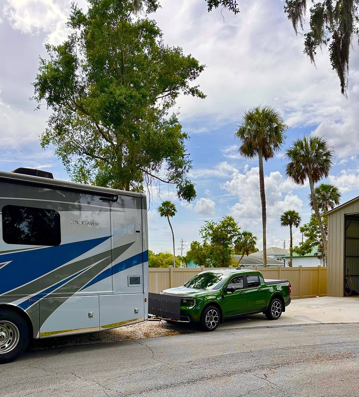

I installed the RoadMaster Baseplate and paired it with the RoadMaster Nighthawk Towbar on my 2025 Maverick Lariat AWD Hybrid I am extremely happy with the results
Ford Maverick Can the new 2025 Hybrid AWD be flat towed? IMG_5342
Ford Maverick Can the new 2025 Hybrid AWD be flat towed? IMG_5268
Ford Maverick Can the new 2025 Hybrid AWD be flat towed? IMG_5257
Ford Maverick Can the new 2025 Hybrid AWD be flat towed? IMG_5255
