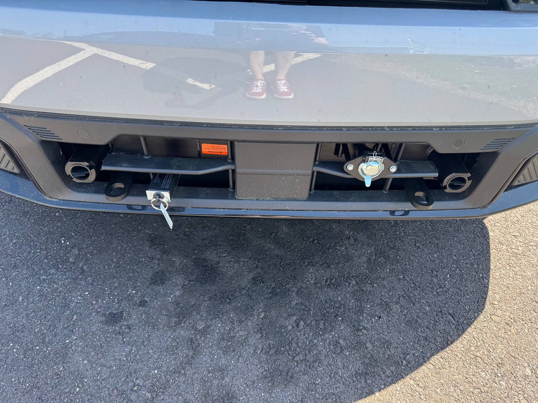

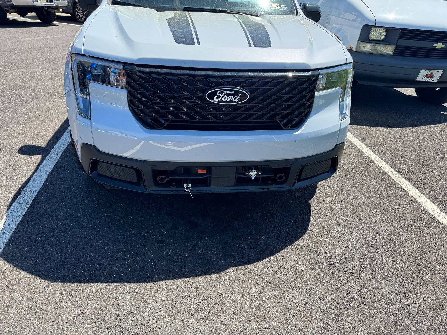

I had the Blue Ox baseplate installed on our 25 Lariat hybrid today by our local RV dealer. The technician said it was no problem to install and he does a lot of these. . Unfortunately, I didn’t get to tow the car because I had to leave the RV for a service visit, so I’ll have to report back when I pick it up. Here are photos of the install.

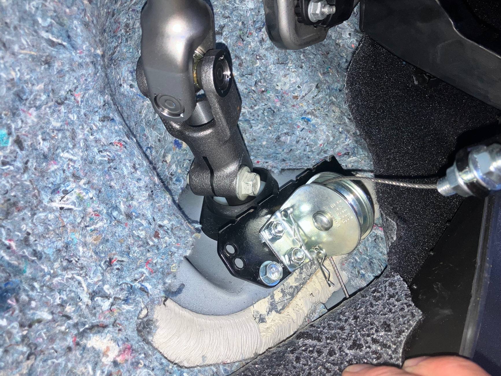

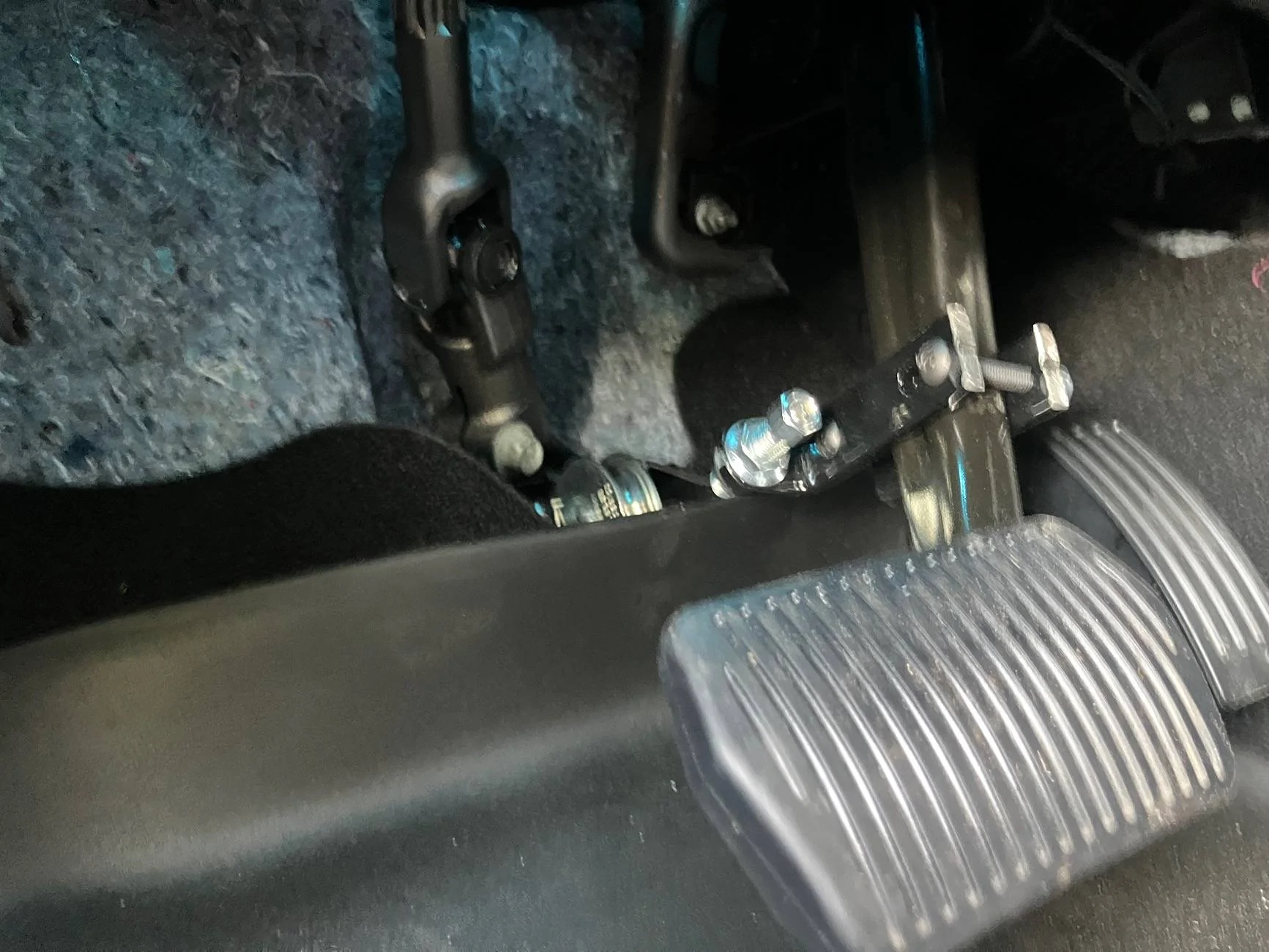

Here are a couple of pictures of the brake pedal area. Cylinder is under driver’s seat. I can’t get to the back seat right now. Too much stuff packed in there.

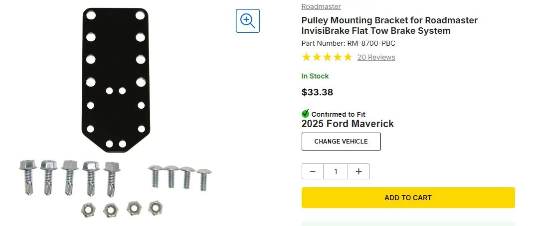

Thanks for the pics. That helps a bunch as I plan on working on this over the weekend. I know what you mean with the seat and getting photos there. I was going to start working on the under-the-seat stuff last night but couldn't get the seat unbolted. Found that they have some huge torx bolts on there so having to order large torx sockets to unscrew. What happened to the days of regular cap screws or nuts that you can use regular socket set? The vehicle uses a lot of torx; I have torx wrenches but just the small type on a fold up set. These are huge Torx and will require a ratchet to unbolt. Ordered a set from Amazon that also includes "security" type of torx so I think I'll be covered for all large sizes plus the security type. Never really needed these in the past. Looking again at your photos, it does look like they used that bracket RM-8700-PBC. I guess I'll have to order that from eTrailer to complete the Invisibrake install. Perhaps I should have opted for the Demco unit as I see those install easily under the dash and the cylinder mounts directly to the pedal. But I ended up going all Roadmaster. Nighthawk is awesome and the base plate from Roadmaster does make for a clean install in that the fascia is not cut and the bar is hidden behind the fascia. Roadmaster seems to make good product.

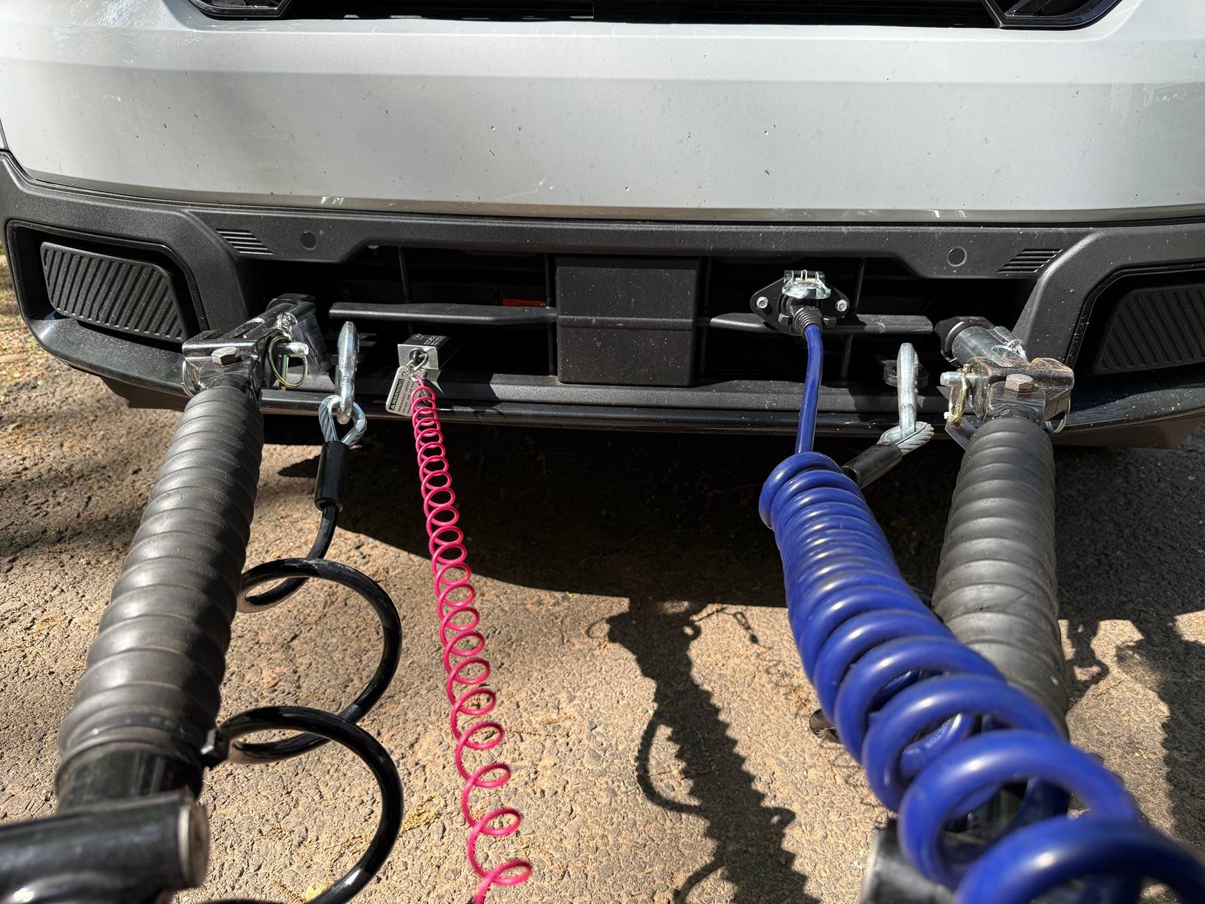

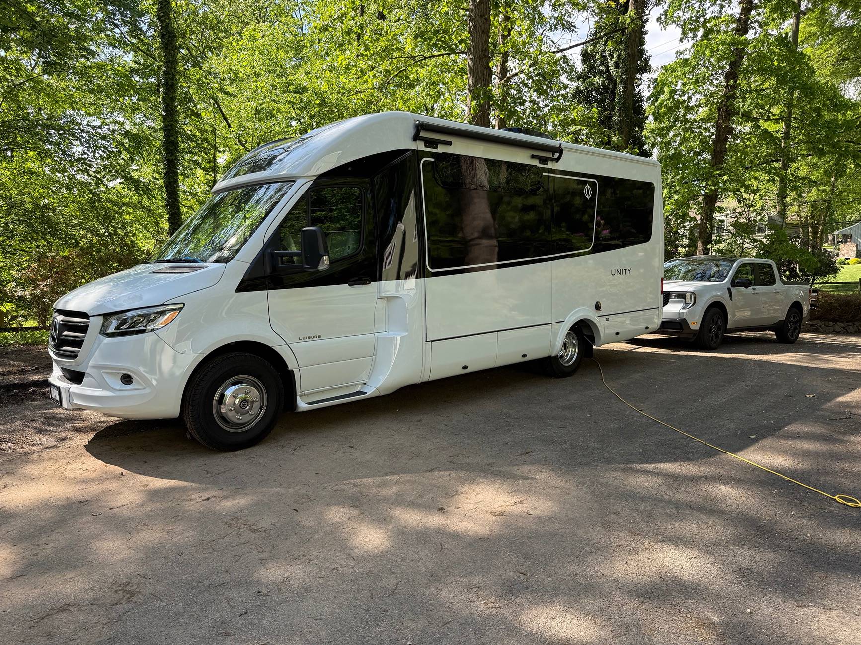

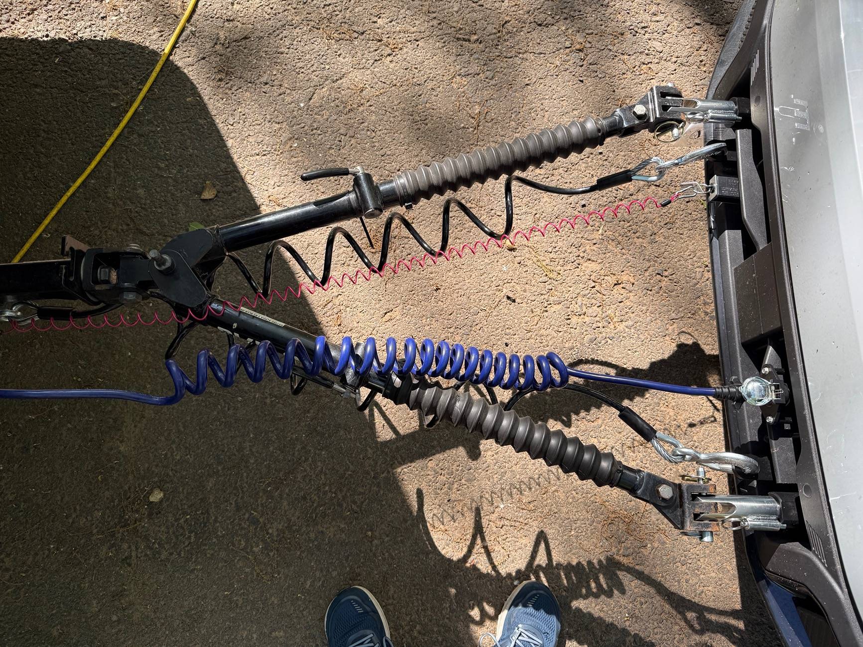

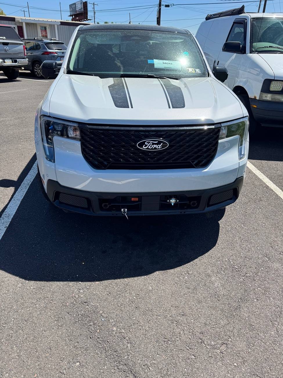

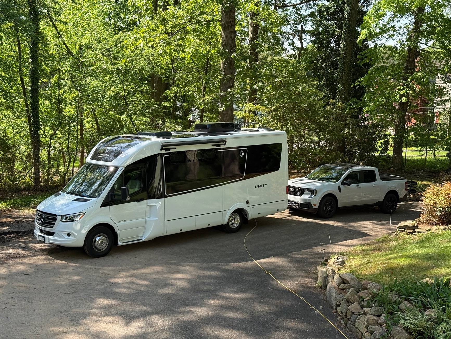

Towed my 25 Lariat Hybrid 4k towing for the first time just now with my new Blue Ox set up. Works great! My shop steered me towards Blur Ox over other brands - says tbey are more robust than others 🤷🏻‍♂️
I am pretty sure sure all will work equally well. Glad to have my toad set up at last…
