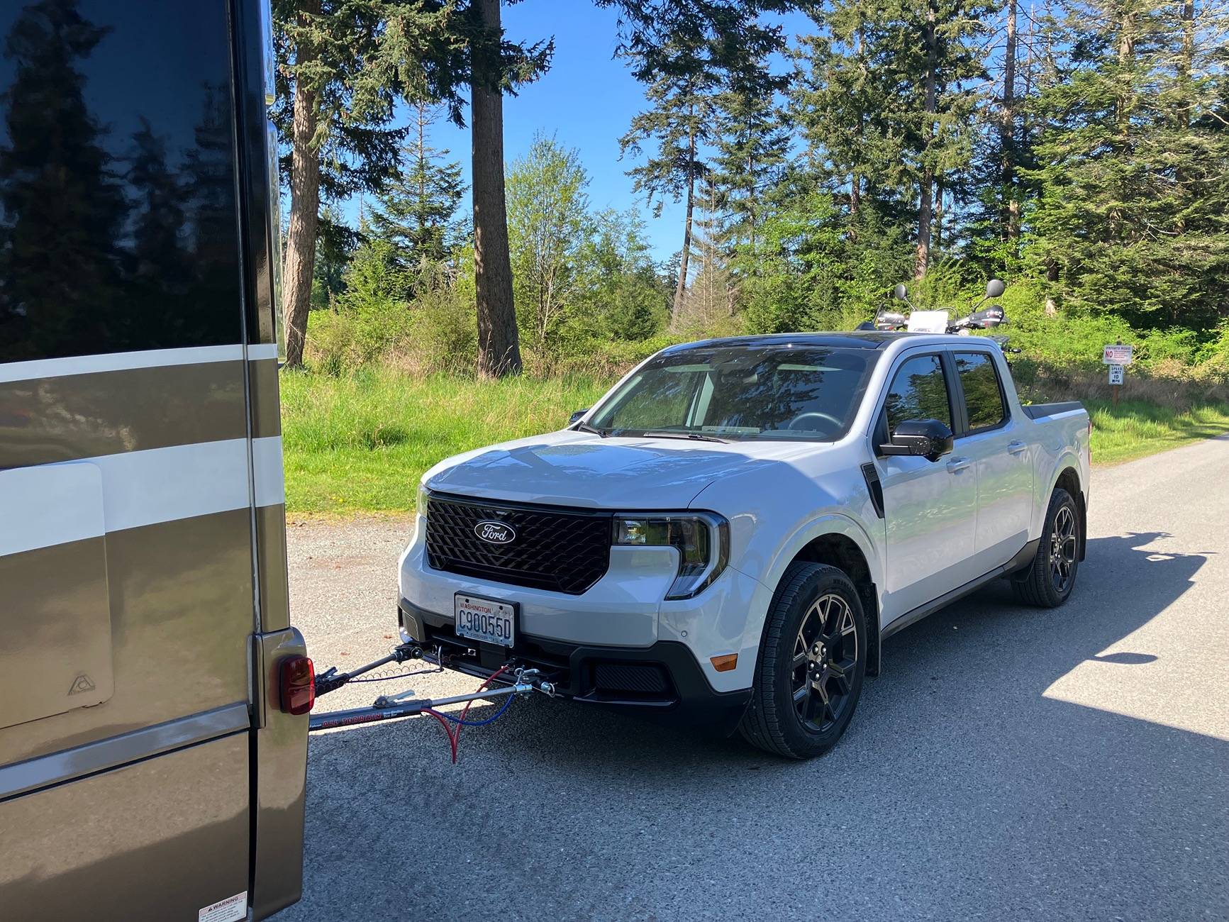

Over 3500 miles towing now. I have let it sit for 15 minutes most of the time. At some camp sites were I had to back in I had to move the maverick out of the road after disconnecting.
The weird thing is that after towing for 6 hours you are supposed to stop, shift into D then back to N to continue towing. Nothing about waiting 15 minutes.

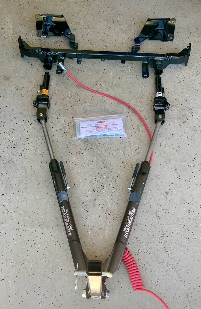

I finally got the Roadmaster kit on my 2025 Lariat Hybrid and took is for a short run with the RV. Everything worked great and the Mav towed perfect. Now I'm planning my first long trip with a toad.

The only problems I ran into was the break away switch cable was too short and had to add to that. Also when detaching the Maverick it was on a shallow slope so wouldn't release until I started the Mav and drove forward about 1/2 inch then locked the brake so it wouldnt roll back again.

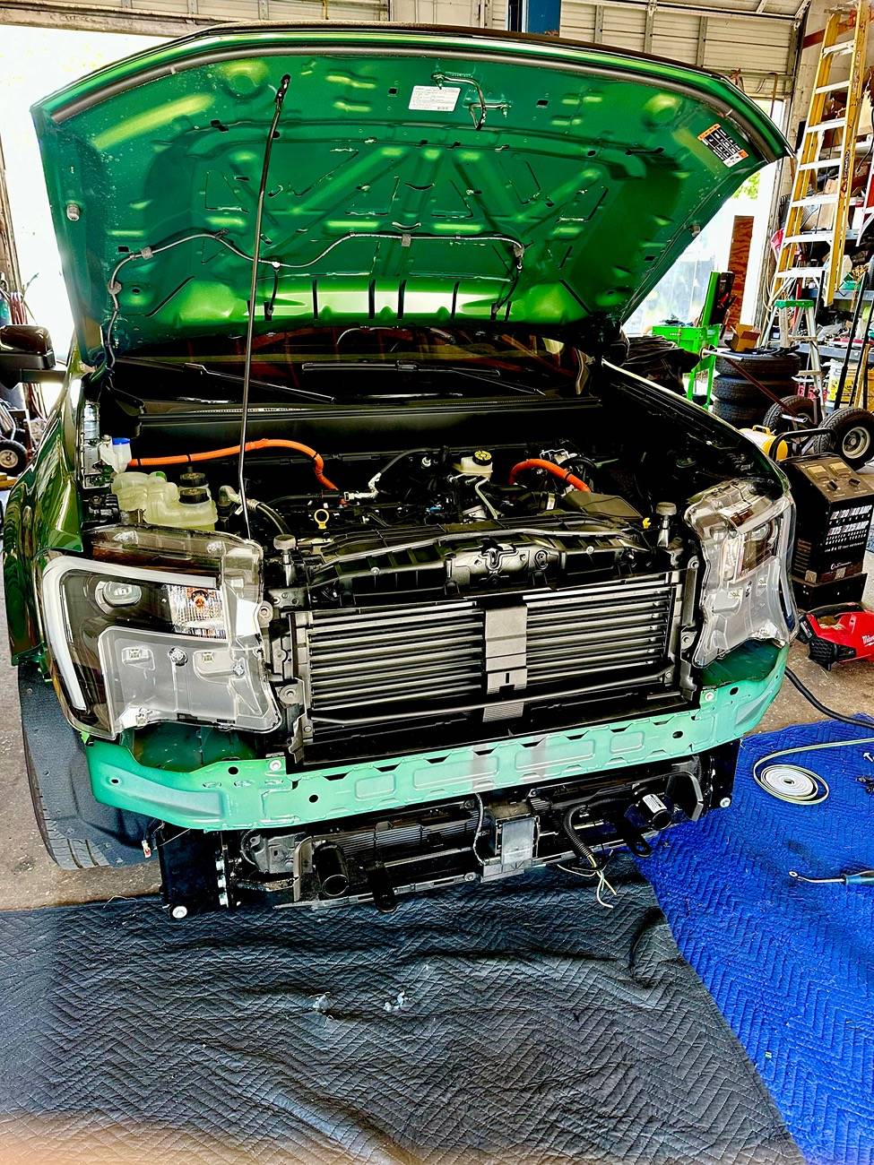

Started the installation of the RoadMaster Baseplate today on my 2025 Maverick Lariat AWD Hybrid. All is going well wiring up the lighting and charge wire now then I’ll start putting everthing back together I’m happy with the fit so far.

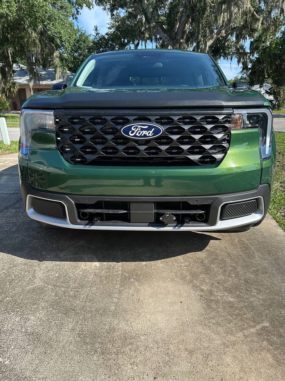

Completed the RoadMaster flat towing installation on my 2025 Maverick Lariat AWD Hybrid today - I couldn’t be happier with the installation of the RoadMaster Baseplate ease of installation definitely exceeded my expectations everything fit perfect with little to no destructive measures required, the lighting and charge wire was simple and works as designed…
Ford Maverick Flat Towing the 2025 Maverick AWD Hybrid IMG_5257

Did you have to trim your shutters with any of the new baseplates and if you did what does that do to your warranty?
No major modifications required I just post a photo of the finish product it looks great I am so happy
