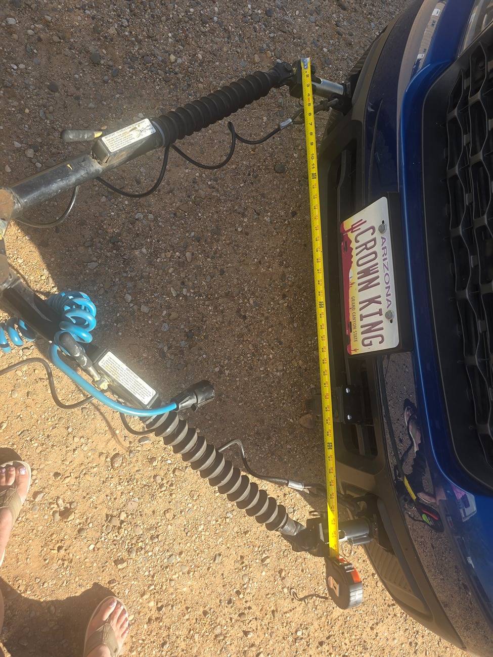

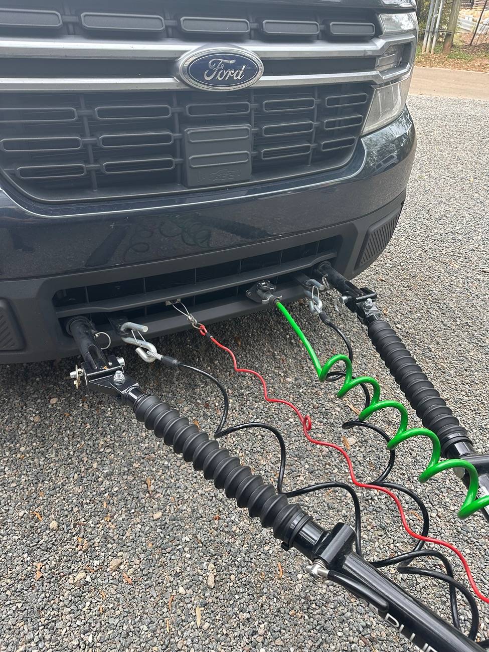

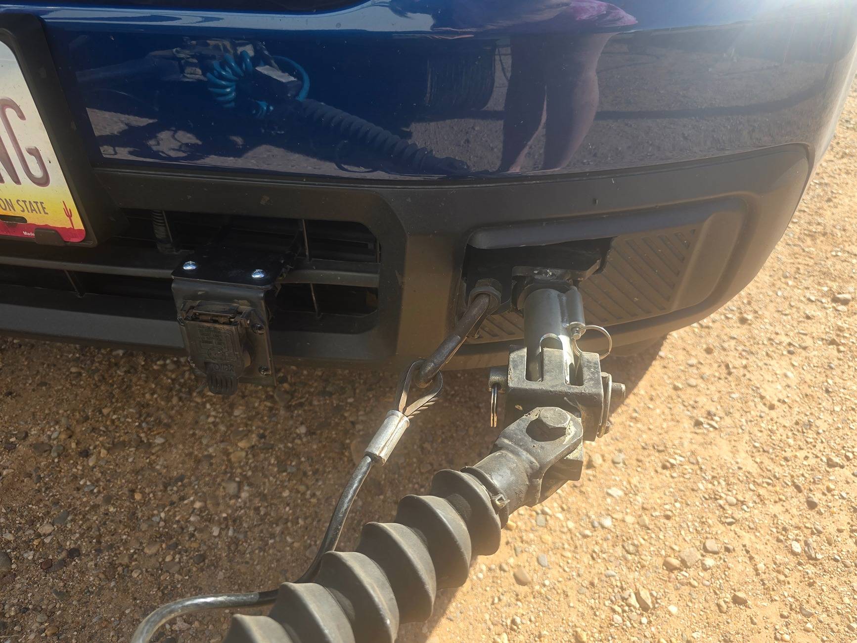

We have 2024 XLT Maverick hybrid with Blue Ox baseplate and tow bar. I'm hoping the 2025 Lariat hybrid is better placed. They chopped through the louvers to install.
It is quite wide. I was reading where someone had big problems because of the width. I like the location on the 2022 pictured above. That's where I'm hoping new baseplate can be mounted on 2025 Lariat hybrid.
One nice thing that Dan's Hitch in Indiana did was make certain that while we are towing, the truck is on charge. So we don't have to stop and run the engine during or after pulling all day.
Having a charge wire is a necessary item to keep the battery up. Turning the ICE on and running it for a few minutes at the start of day and every 6 hours is for the transmission protection, not charging the battery.
