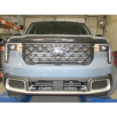

Looks like Blue Ox has the following baseplate on their website that is not yet in stock at E-trailer.
BX2914
2025 Ford Maverick HEV
(Includes Adaptive Cruise Control, Shutters, & Hybrid)
It doesn’t say if it’s for the Lariat specifically. Does anyone know if this description would include the 25 Lariat?

The photo on the Blue Ox website is a Lariat. Don't know if it's equipped with the 4K tow package which has a transmission oil cooler. Requires the permanent removal of the top half of the shutter vanes.

Photo from BlueOx Website today - The baseplate currently shown “Out of Stock” this photo shows a 2025 Maverick and looks to be a more narrow solution - I‘m definitely waiting on some comments from someone who completes the installation

Thanks for this. Do you know if there is any concern with removing the shutter vanes or is it primarily cosmetic?
DaveTS
Jan 6, 2025
New Mexico
2025 Maverick Lariat AWD 4K, 1992 MB SLK, 2014 Prius V
My understanding is that the louvers are controlled by the engine's cooling system, they open when the engine is hot, and close when the engine has cooled off enough. I would think that you would want the louvers in very cold weather cruising at highway speeds. That's not much of a concern in the high desert where I live.

I think the main purpose of the shutters is to slightly improve the aerodynamics when the extra airflow is not needed for cooling. Having some of them always open might have a small effect on mpg under certain conditions and perhaps a small effect of how quickly things warm up in very cold weather.

I got a reply back from a BlueOx distributor he told me they should have that solution back in stock on 4/01/2025 - I am waiting on RoadMaster and Demco to see what their solution looks like and see who offers the less destructive baseplate installation till then I’ll continue to tow my 2004 Jeep Wrangler TJ.
