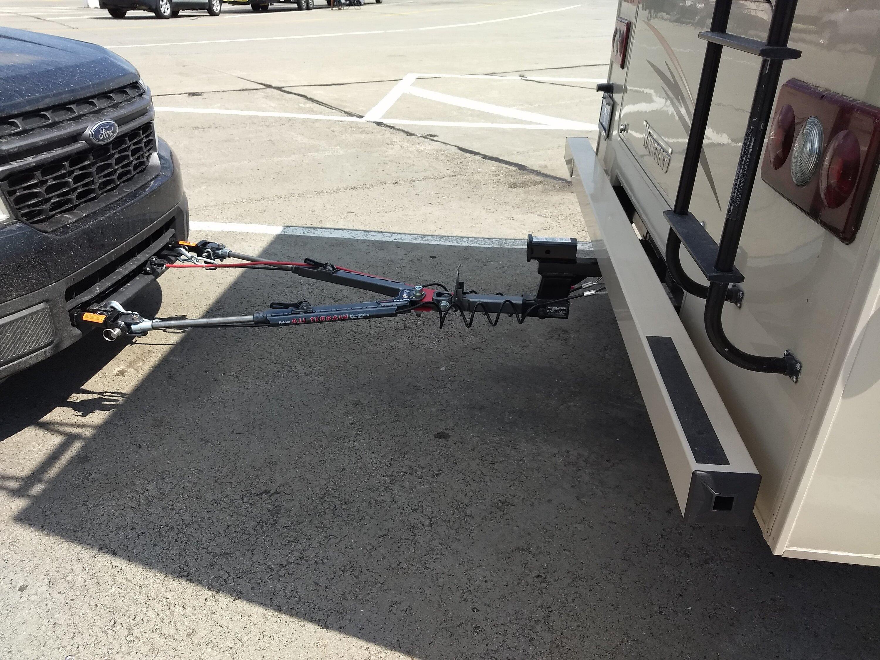

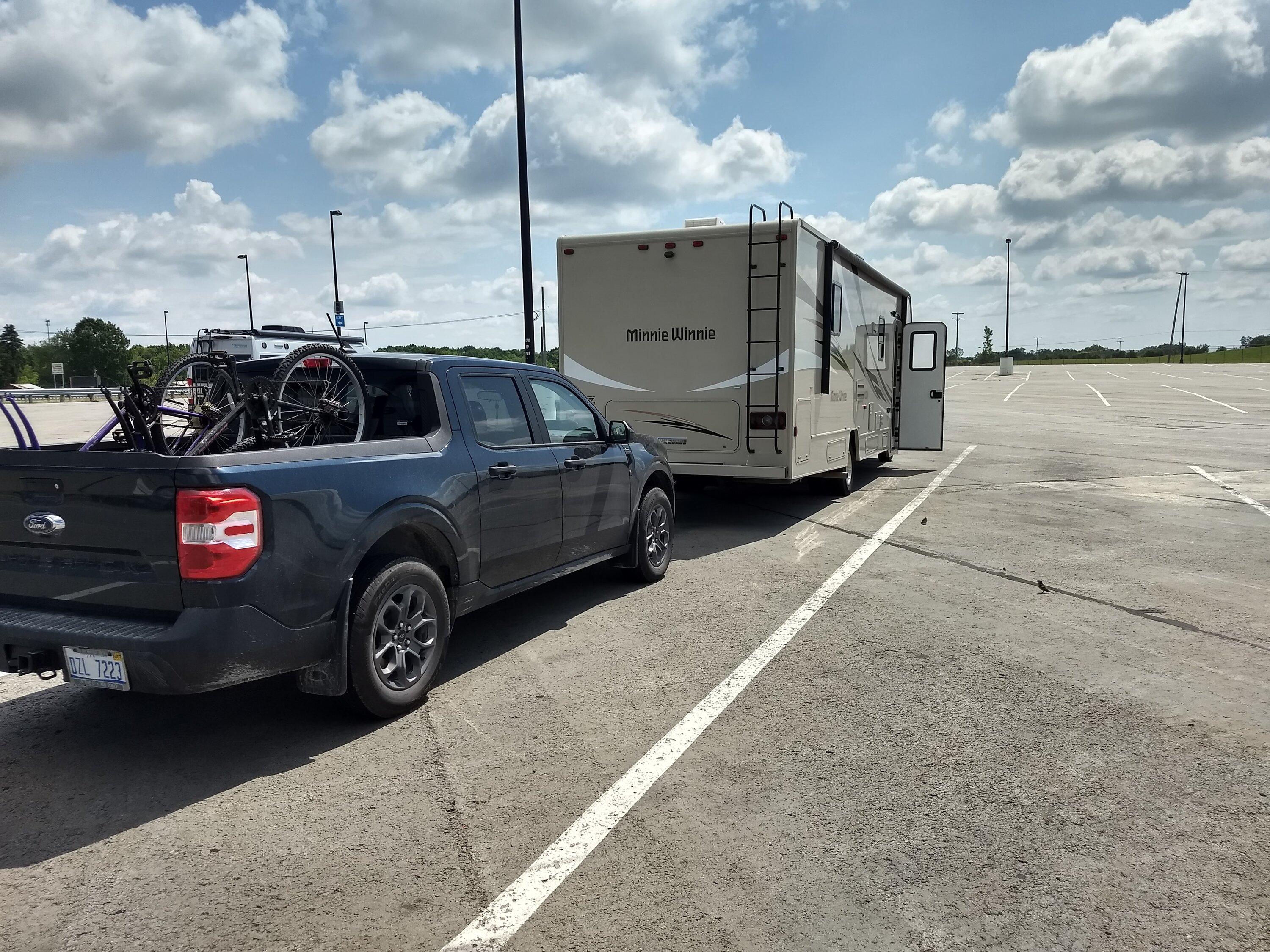

Just purchased a 2022 Hybrid Maverick to pull behind my Motorhome. Just looking for advice for the best base plate for the Maverick,
Blue Ox or Roadmaster, or another option?
Thanks
Demco! I have a video posted here showing the installation.
