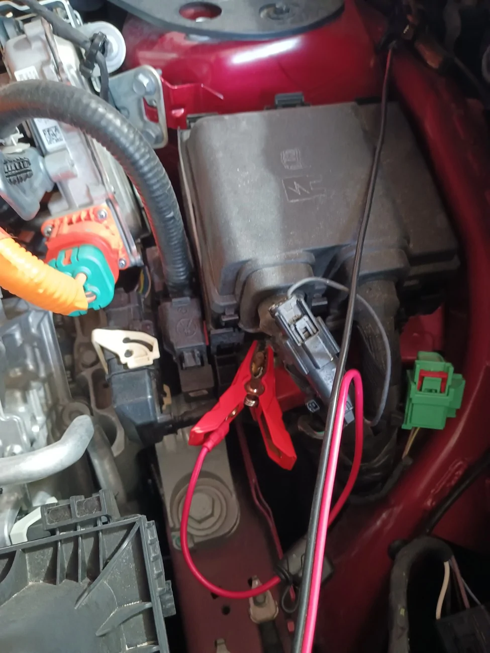

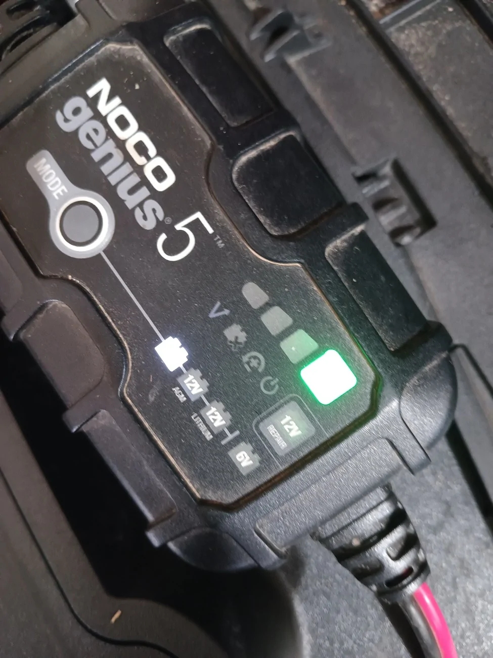

I just checked my noco 5g on my 2022 hybrid lariat. Looks like it's on standby after running my approximately 90 days charge followed by the optimization/desulfation routine. ETA: The rectangular cover to a threaded jump post tips towards the front of the truck.
