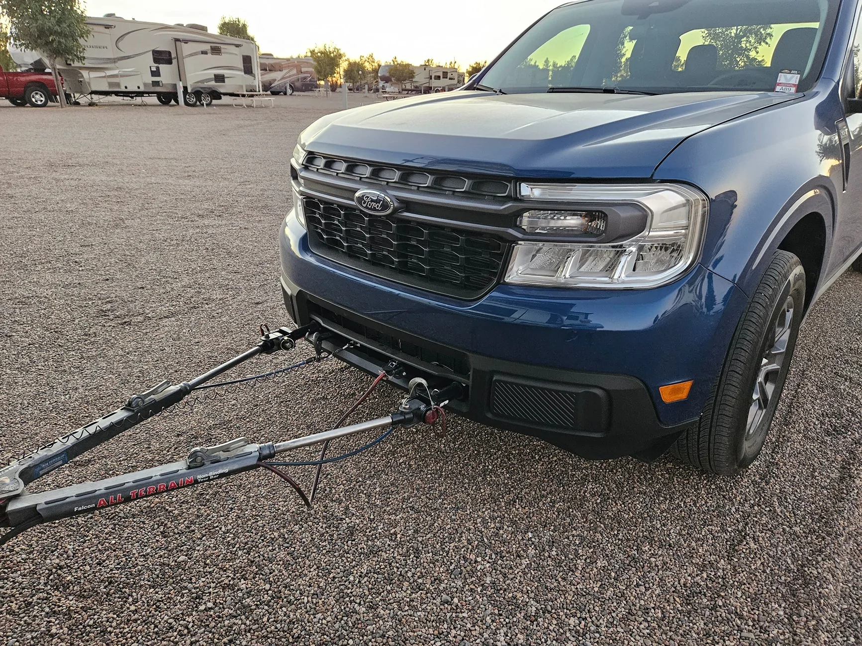

Ford Maverick Flat tow Base Plate Maverick hooked up 01
I installed the Roadmaster base plate on my 2023 XLT Hybrid and am using a Roadmaster Falcon All Terrain tow bar.. That baseplate required some significant trimming and removal of the lower active air vanes. I believe the Demco base plate requires less trimming and leaves the active air system intact. Go take a look at etrailer.com, they have several base plate choices and have detailed installation instructions and videos for each one. I have heard the BlueOx base plate is least desirable due to the wider mounting points which effectively shortens the towbar which can cause binding or contact with the towing vehicle in sharp turns.

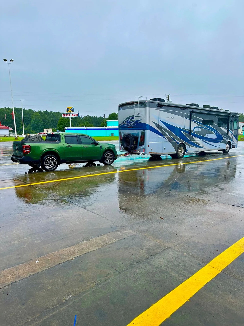

Looks great however with the 2025 refresh and the relocation of the ACC Radar everything changed so they all started from square one and have similar but different approaches it was easy for me to immediately disqualify BlueOx for my 2025 with its wide stance so I focused on RoadMaster and Demco for me RoadMaster nailed this one
when I purchased my 2025 Lariat AWD Hybrid there were no options for any baseplates and I contacted both manufacturers and communicated with both through their engineering process after over 6,000 miles flat towing with this Maverick using the RoadMaster baseplate and RoadMaster NightHawk towbar Im happy with the installation and how it performs

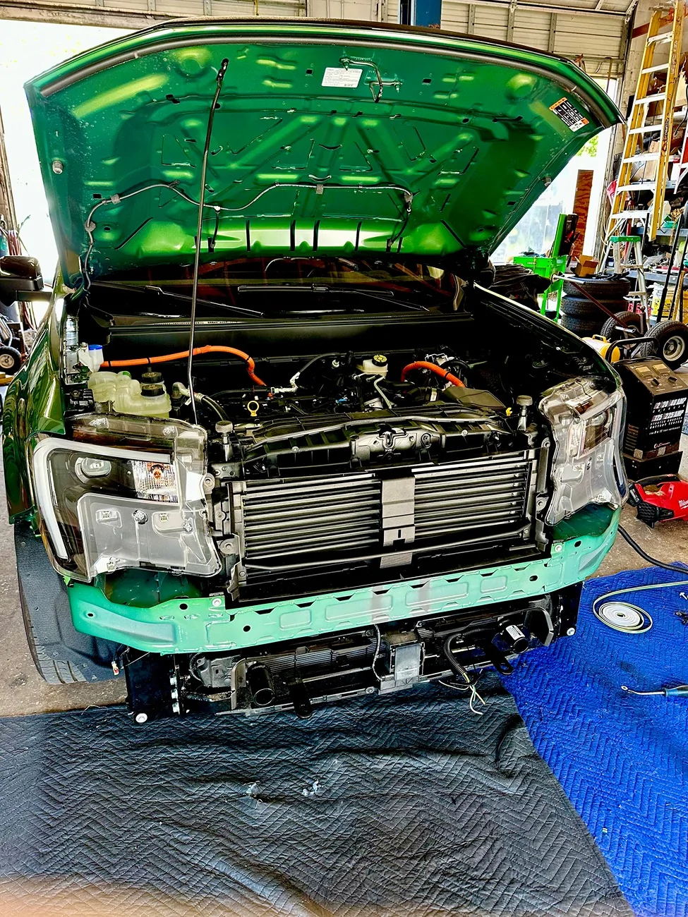

I purchased directly from RoadMaster which I highly recommend they have amazing customer and product support something that third party retailers canā€˜t match IMO companies like e-trailer talk a good game but rarely can deliver.
i had a small local family owned business do the install and could not be happier with their work and attention to detail I’m very fortunate to have these guys near by. It took about four hours.
