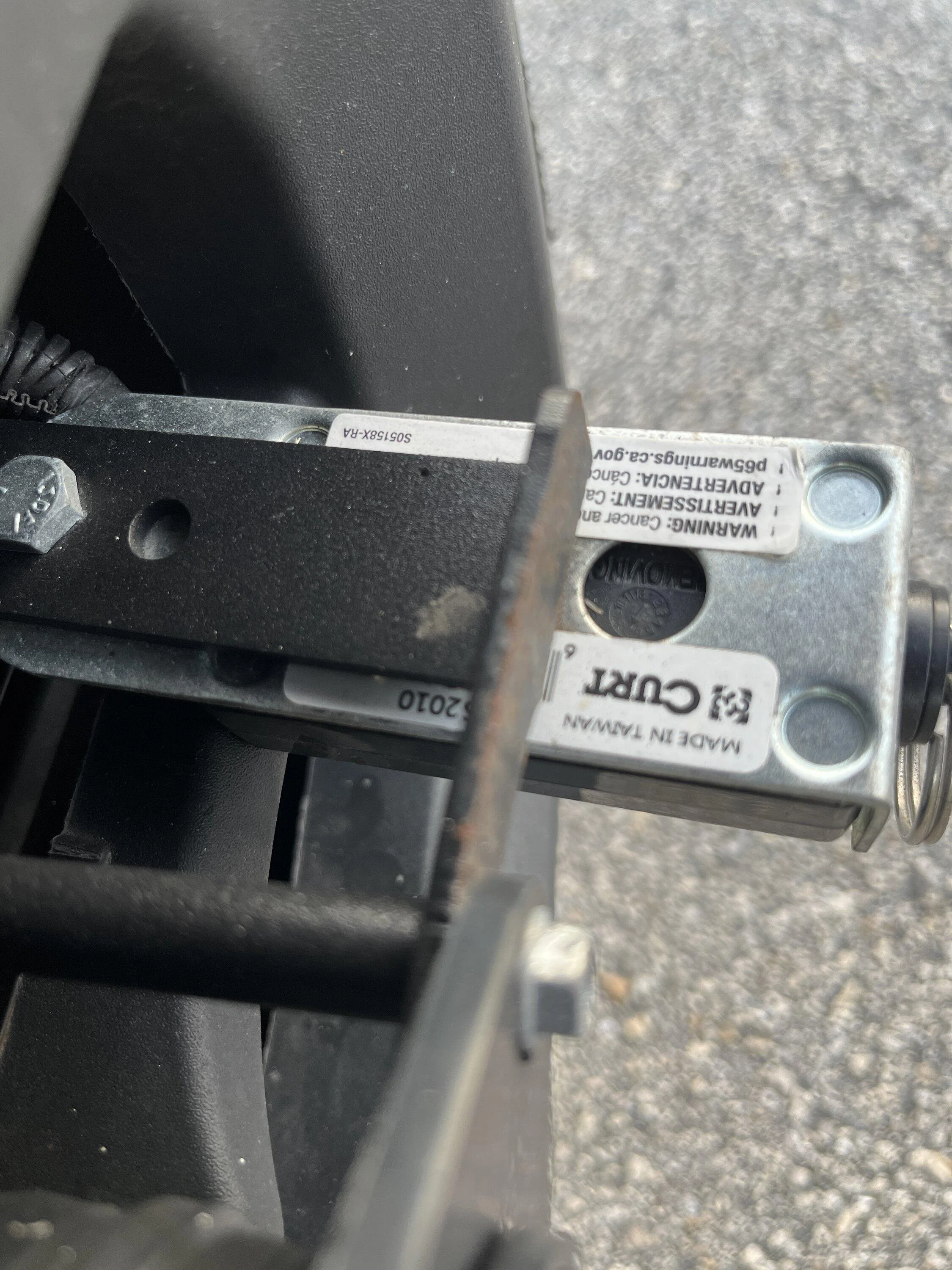

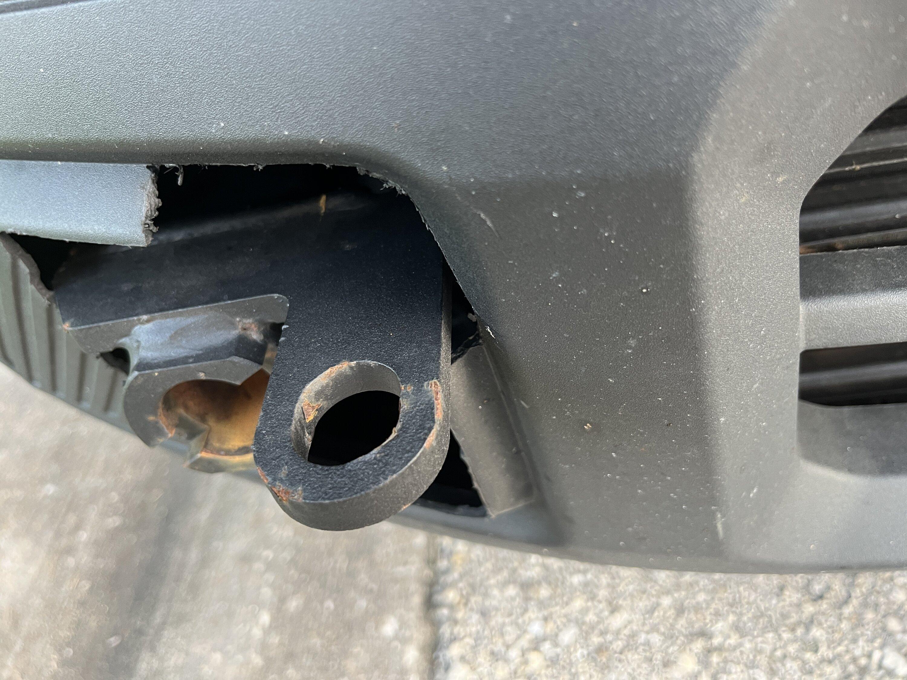

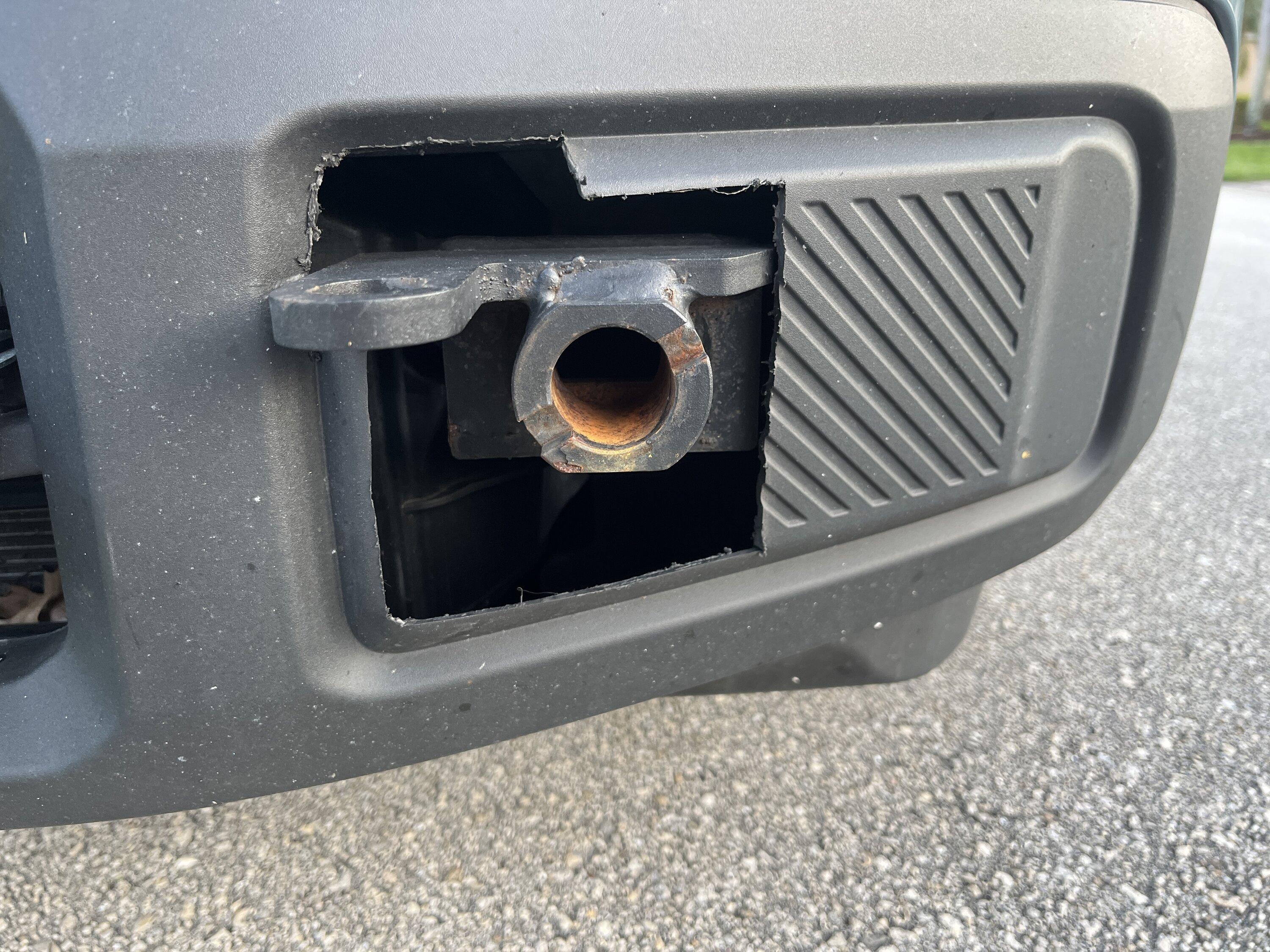

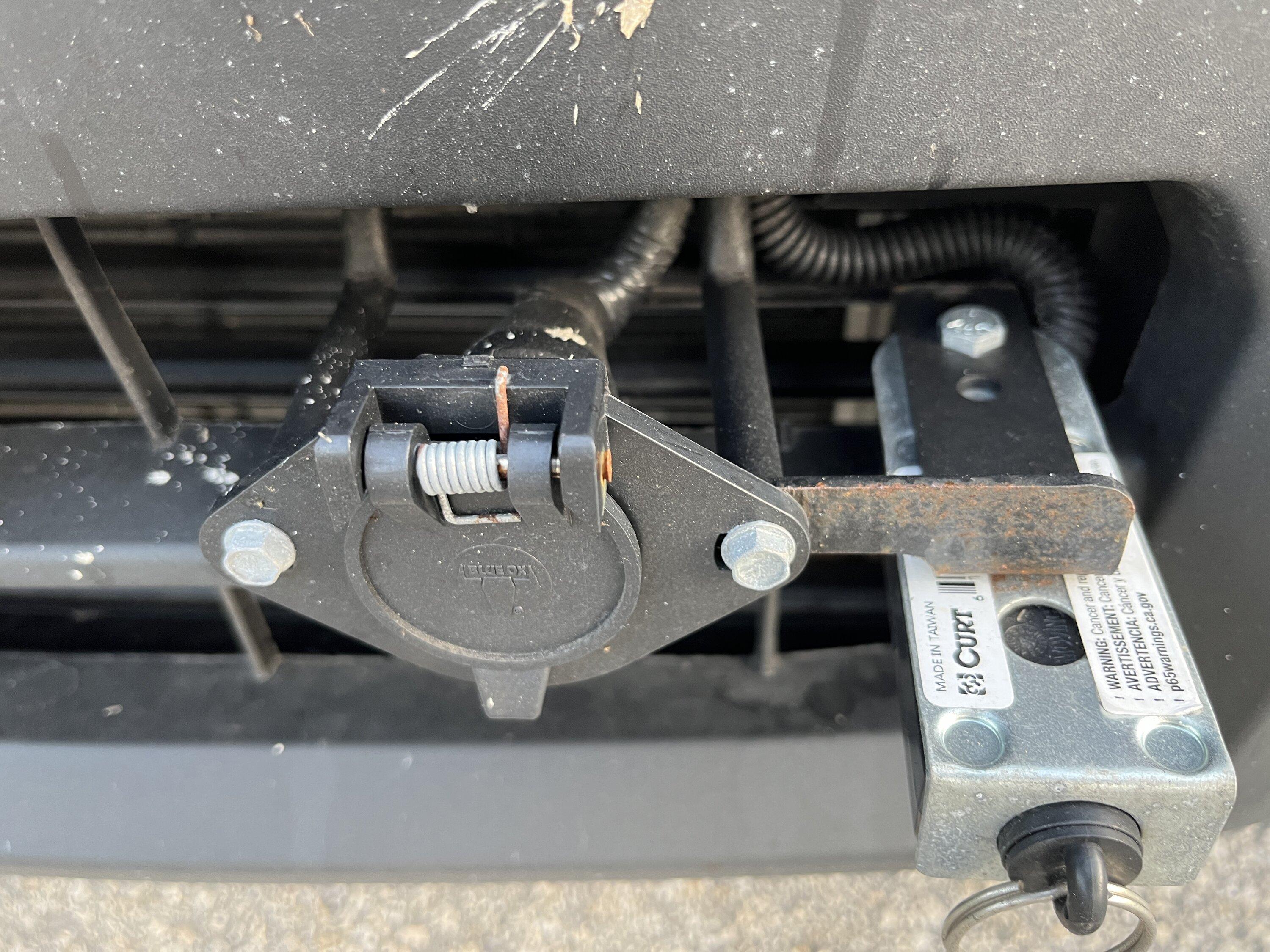

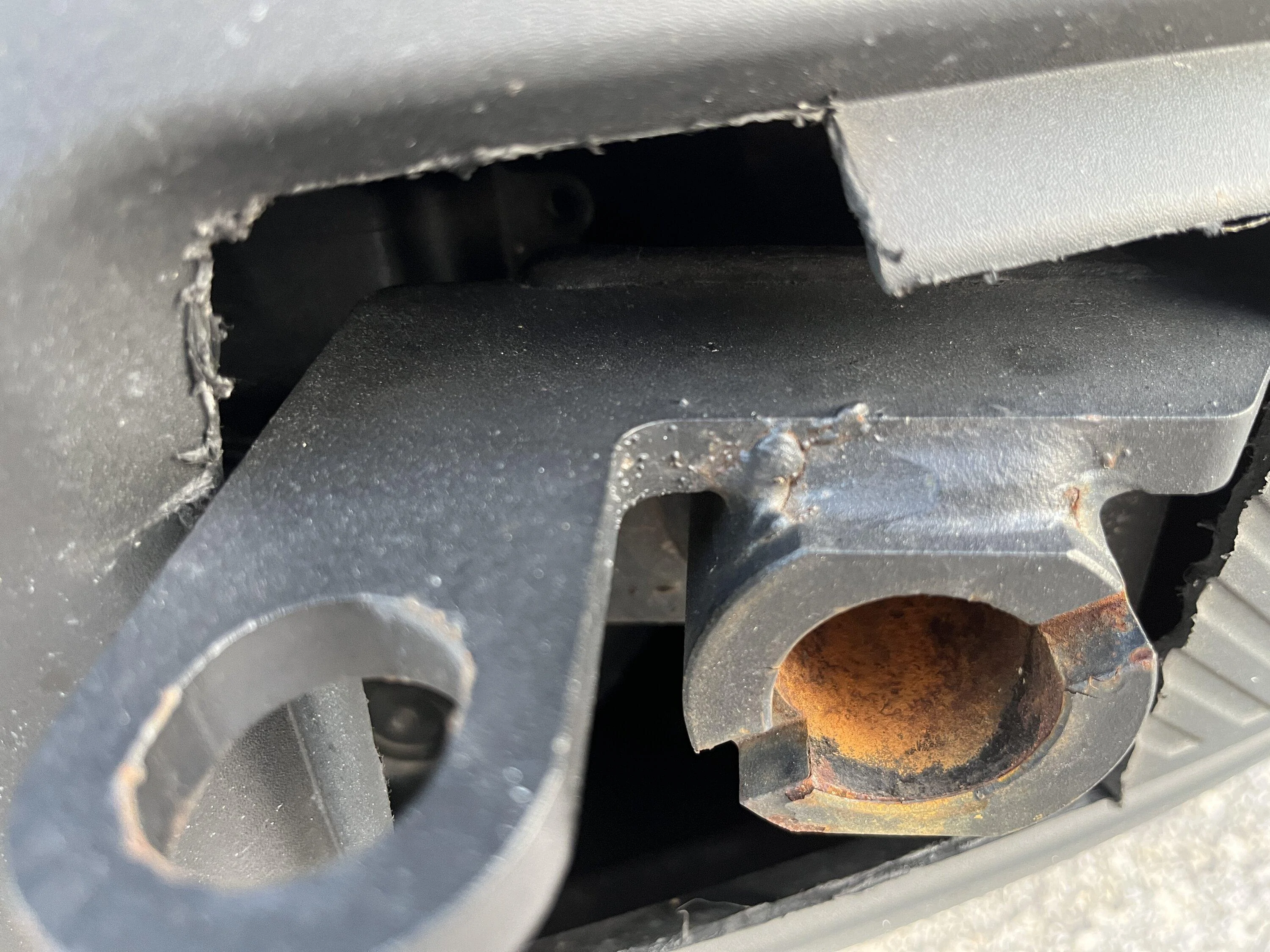

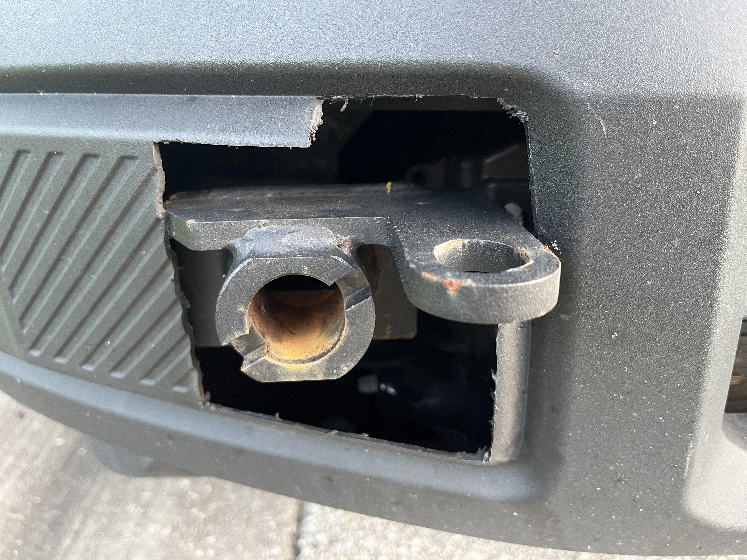

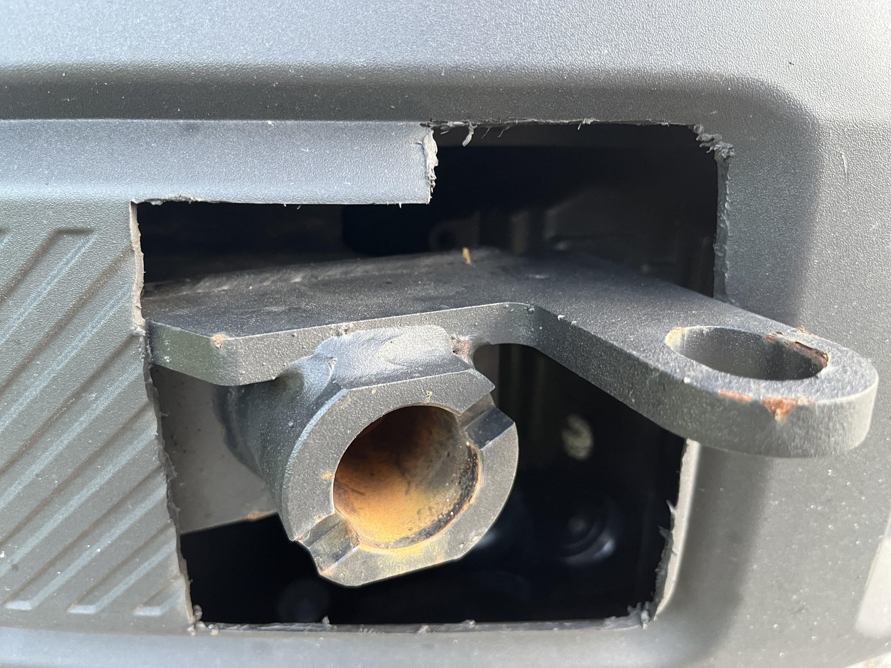

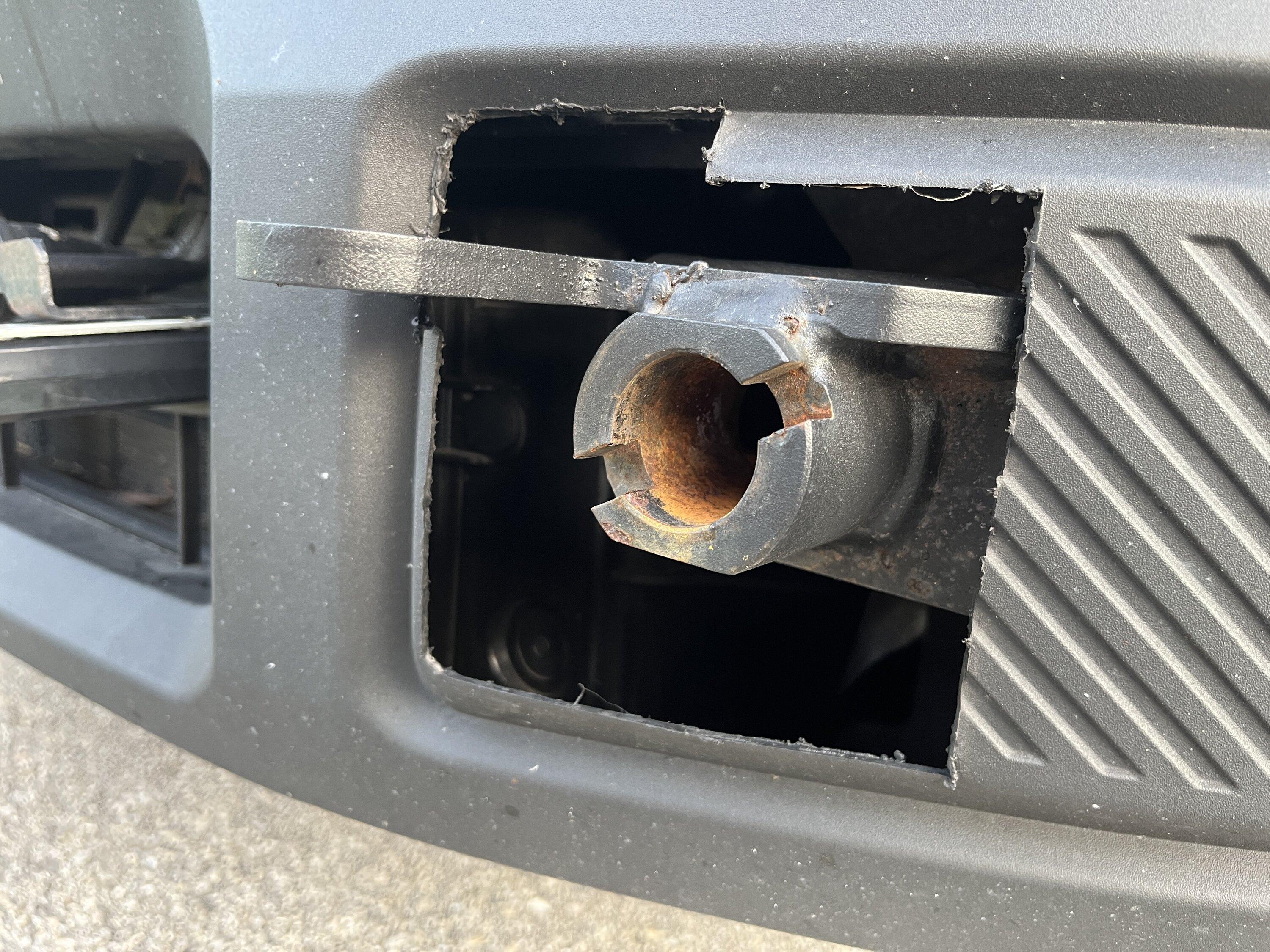

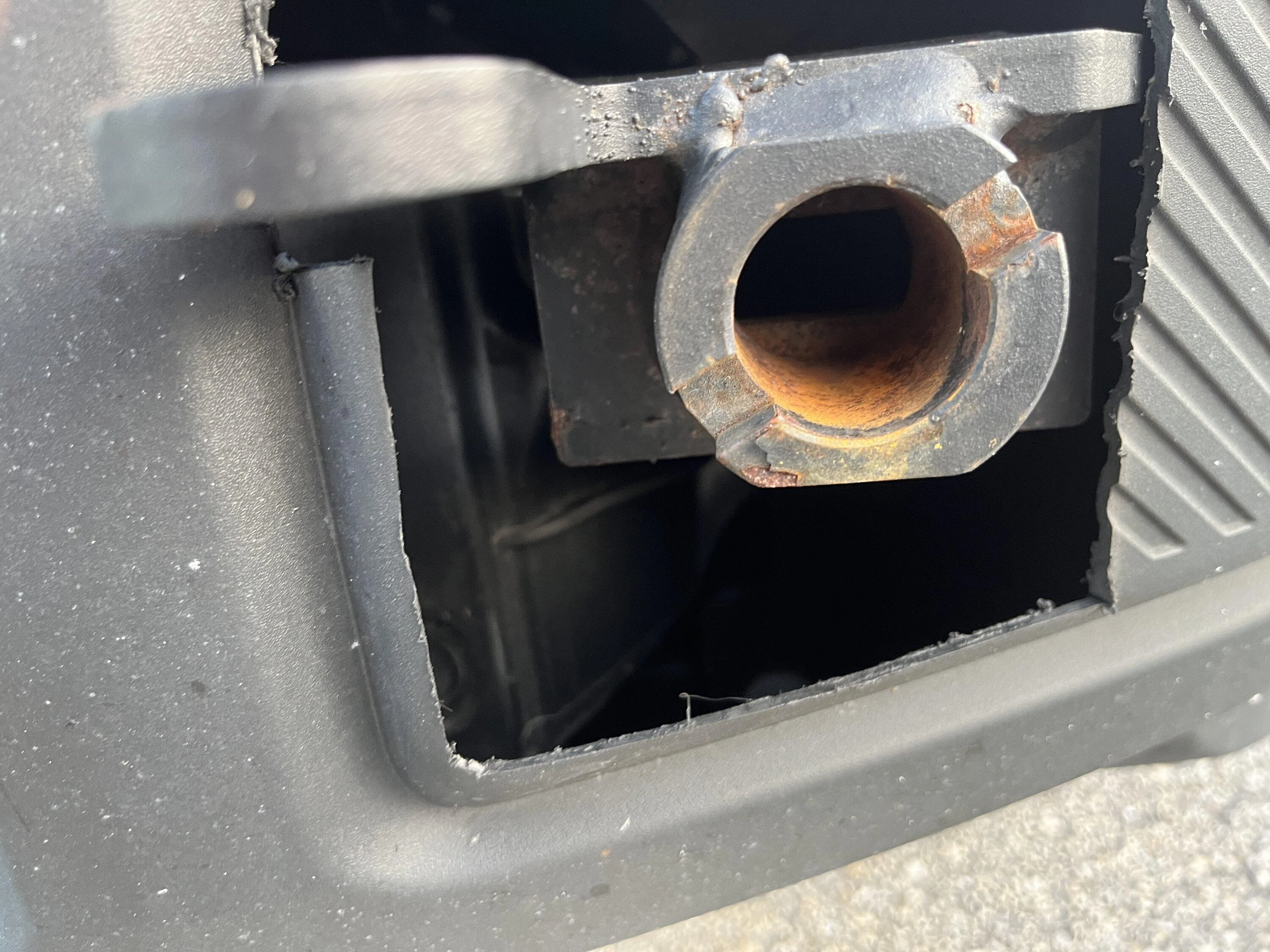

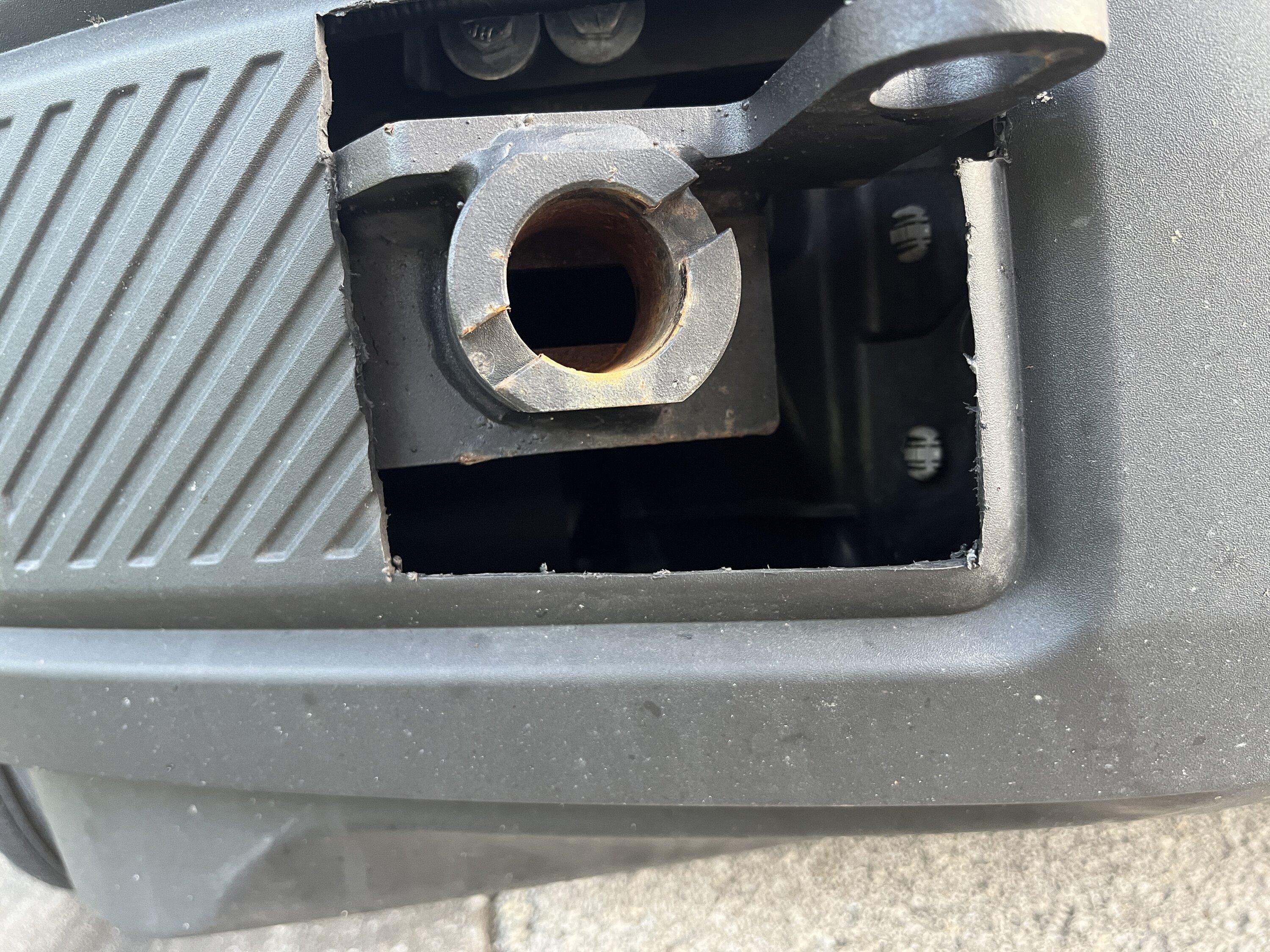

Just found on my walk and took pics. Good guide. Just needs a little TLC to finish. Hope it helps.
put white lithium or other grease in the tubes to fix and avoid future rust. The pins vibrate when towing, which is why the need for grease.

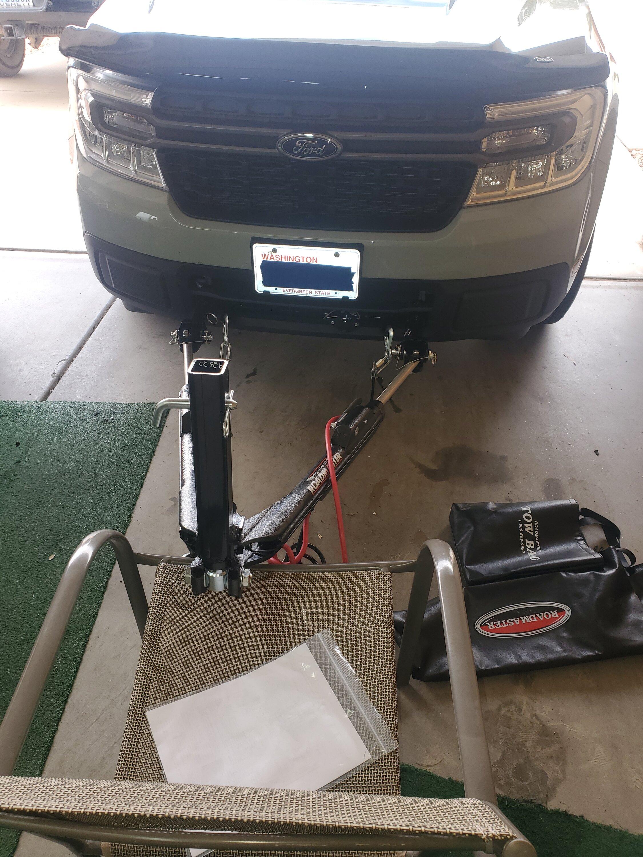

The shutters have to be removed as part of the oil fire recall to increase ventilation. They are only there as part of an attempt to grab a tiny bit more mpg, no effect on warranty. Blue Ox involves hacking away at the facia, ugly versus Roadmaster using existing openings. My truck was one of two used by Roadmaster to prototype their baseplate in exchange for a free baseplate and install.

The shutters have to be removed as part of the oil fire recall to increase ventilation. They are only there as part of an attempt to grab a tiny bit more mpg, no effect on warranty. ...
We've had at least one member be told by their dealer that altering their active-shutters would void cooling-related warranty.
https://www.mavericktruckclub.com/f...ase-plate-for-the-maverick.23250/#post-539632
My lower active shutters weren't removed when my 2023 truck was built in 1/23.
