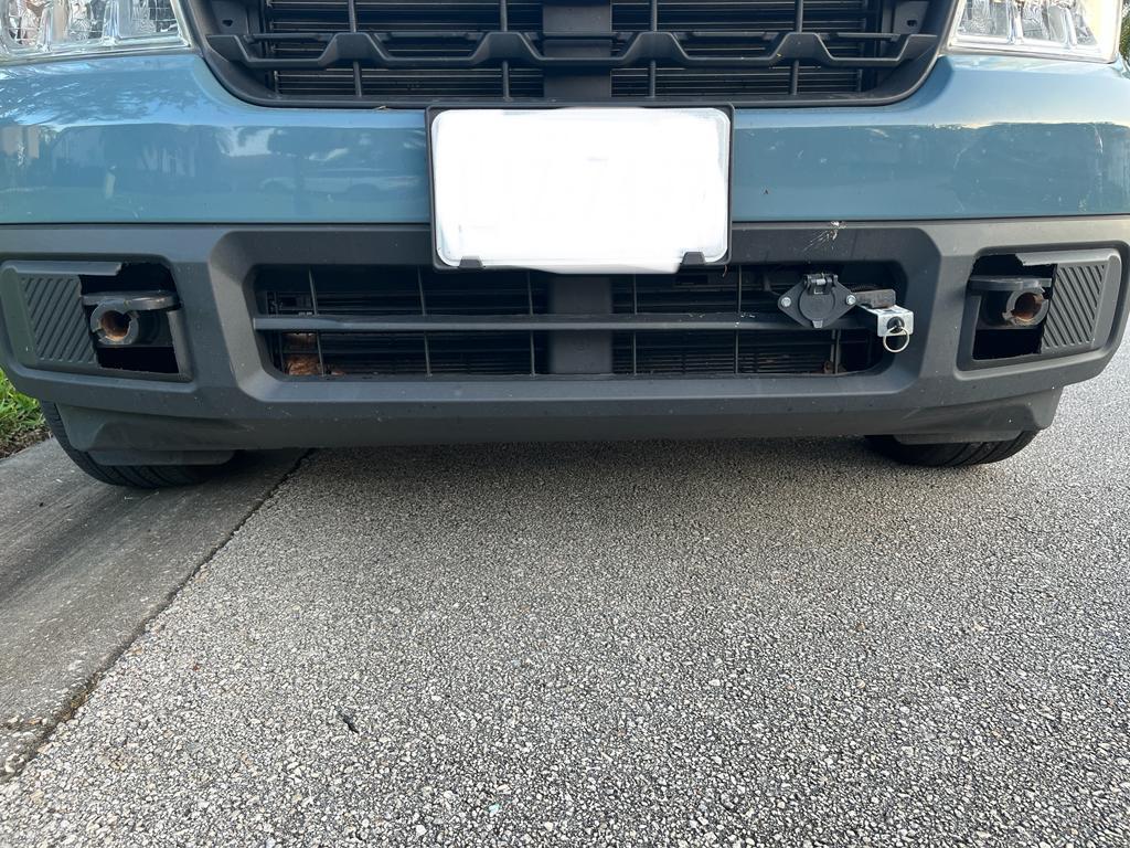

Thanks! There is a much shorter version of the breakaway switch. I started to put this long one on my C-Max and then found the shorter version. https://www.amazon.com/gp/product/B0049MKPSW
It really doesn't seem like it would be that hard to do a more careful job on that trim, then use some 1/4" U-channel to make it look a lot nicer.

Thanks for the tip. I’ve added it to my Amazon list just in case. I may take the existing one,, as well as the Hopkins 39332 Brake Buddy towed vehicle battery maintainer that’s in the Jeep or if too tedious, buy replacement ones.
I’ll go over the pics with the shop that will eventually install the plate to see if our results are better, and add the suggested U-channel.

The Blue Ox instruction sheet shows a nicer cut.
I purchased the Roadmaster, but was thinking if I purchased the Blue Ox I would try and put some king of trim around the rough edge. Something like some split rubber tubing glued in place to cleanup the rough edges.
I was reading someone having cooling issues...but I think it was an ecoboost. Having a destroyed active-shutter system with Roadmaster just seemed to present an easy out for Ford to blame and deny a warranty issue.
I would hope that Roadmaster was contacting Fird when designing their baseplate. Probably wishful thinking. I think I would be more concerned the diode installation would have more warranty impact on the electrical system?
I'm planning on LED bars at this point, I think.
Blue Ox says there is room inside the tail lights to install an extra dual element bulb in each fixture. I did it that way on my S-10. Completely separate and is just wired up to the front connector. No issues with doing it this way, as there is NO connection to the Maverick wiring. When I get my truck, I'll look over that option.
I doubt Roadmaster really concerned themselves with active-shutter. Personally, I don't think active-shutter is worth the hassle, but I guess it helps Ford reach some mileage gain. It just makes for an easy scapegoat for heat issues if you destroy active-shutter. As I've said before, I'm a long-time Roadmaster fan, but this was a real disappointment that they did their baseplate this way.

Here's a final pic of the total front of the hatchet job. Doesn't look as bad from a distance, but certainly can be improved upon, no doubt. I will certainly have a session with my installer prior to allowing any modifications. Thanks guys.
I'd be really pissed if some "Installer" did that job to my new truck.
Can I use any of the three grounding lugs on the frame in front of vthe positive stud for the fused wiring harness for my front license plate holder mounted led bar, with 2 separate 5/16 x 18 nuts, one for the charge line and one for the bar?
Not sure where exactly you are referring to, but a ground is a ground, wherever you find one. Just make sure it is a good ground, and not painted over.
