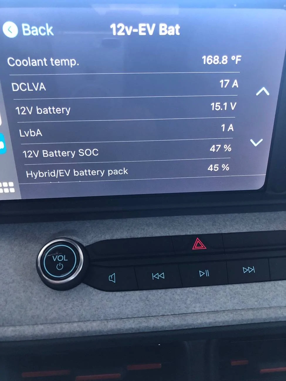

So, I took a 1 hour drive yesterday, 12 volt battery started the trip at 46% SOC and ended at 47% SOC! It always shows the 12 v battery at 15.1 volts, which should mean it is charging?! I have a pdf of the service manual, maybe I can find a theory of operation on the BMS…….I have had no issues thus far, but the 12 SOC is a growing concern to me……. Bill P
Does the DCLVA & 12v battery PID s mean the battery should be charging at 256.7 watts?! P=IxE……….. BILL P

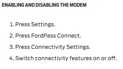

4G and a days worth of data if indeed once a day? - more than half a second then with modem on.
Perhaps if you disabled the "Connected Vehicle" option so system knew no chance of remote start/unlock was possible, I could see it reporting to Ford once a day, would need the other options disabled too though.
But even though I could see once a day being fine if no connectivity for driver - that doesn't mean Ford would hold itself back - hence wondering about reference for that.
The 12 V system is getting 17A, the battery is getting 1A (or rounded up from <1) @ 15.1 V.
15.1 W.
At less than 50% SOC you should be getting deep sleep warnings, unless it rises slowly on turn-off.
SOC is very inaccurate measurement while charge/discharge is going on.

Never see a high charging current ie: 10 amps……, but turn vehicle off & big
- amp draw, 10-15 amps….. Again, I have had NO issues so far! Bill P
Also, ATT coverage is like 2 bars….
So the LvbA line will go to neg 10-15 A when you turn truck off? (foot on brake? 7A for brake lights, overhead lights on, few there, ect.)
(notice it's positive 1A in your pic - battery is receiving a charge)
Interesting - mine goes to neg 5A with foot off brake and other things besides radio have turned off.
