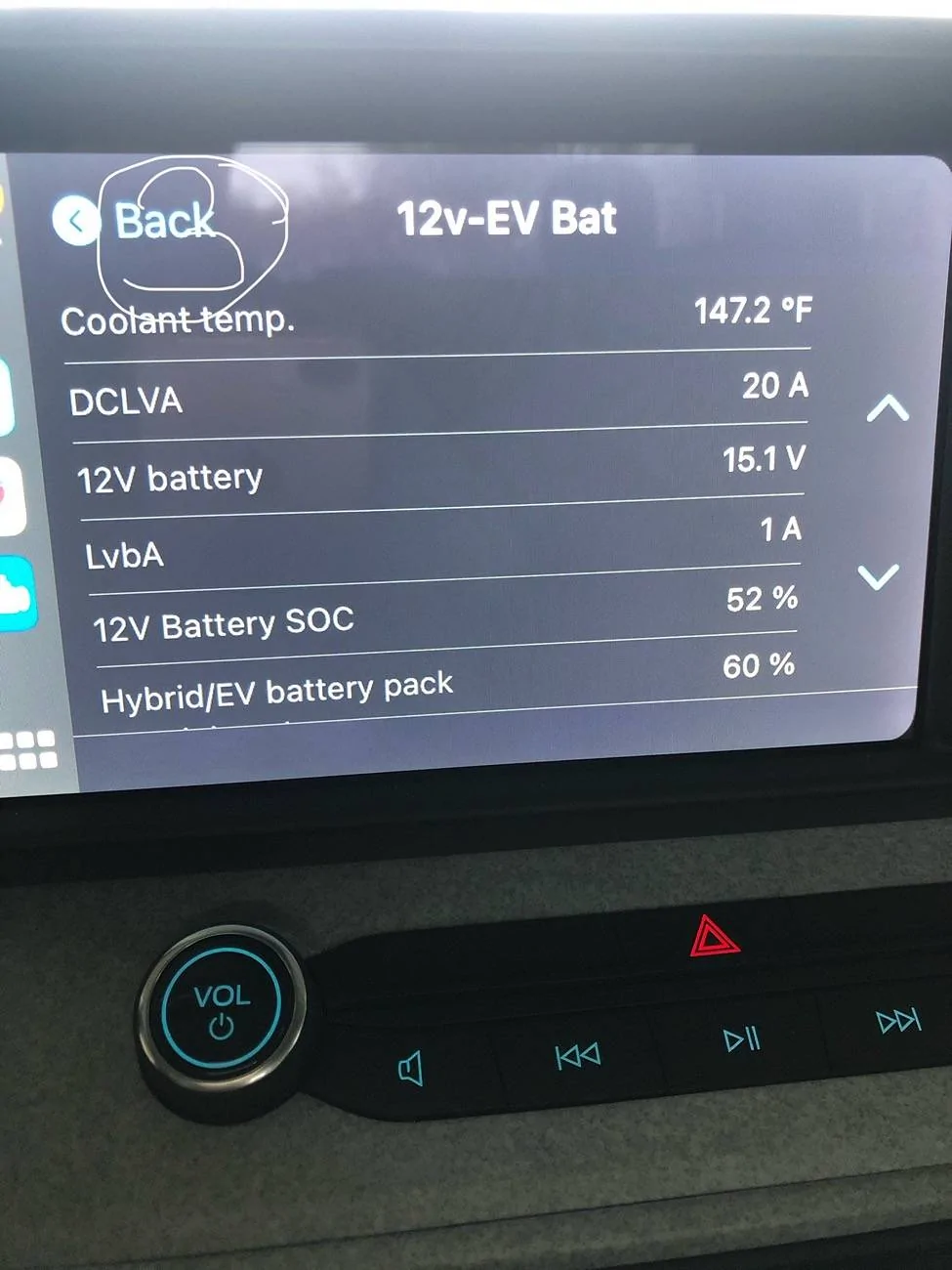

The 12 V system is getting 17A, the battery is getting 1A (or rounded up from <1) @ 15.1 V.
15.1 W.
At less than 50% SOC you should be getting deep sleep warnings, unless it rises slowly on turn-off.
SOC is very inaccurate measurement while charge/discharge is going on.
Not sure how long system takes to decide "oh yeah this is low turning off TCU after sending out notice to Ford".

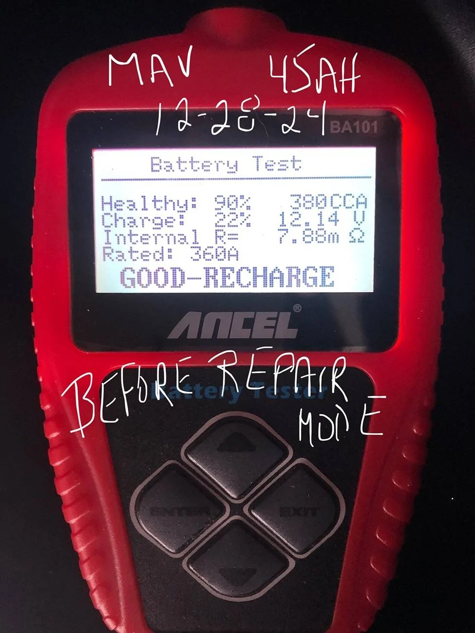

I did a full overnight charge, of the 12 v battery, NOCO Genius 10, see “ before repair” photo

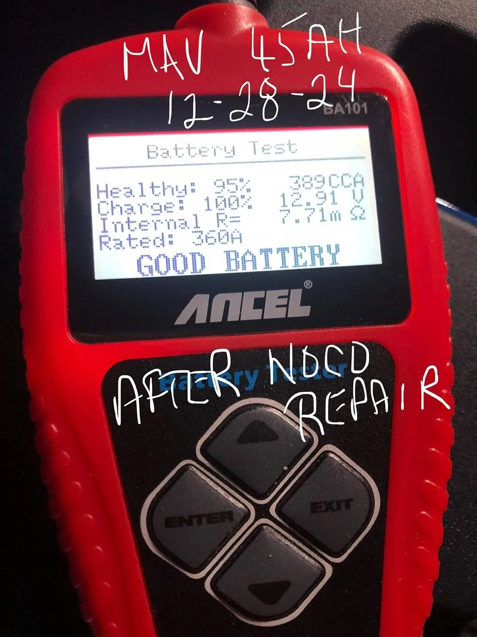

I then did a “ Repair mode” setting……,BE SURE TO DISCONNECT NEGATIVE CABLE AT BATTERY, see “ after NOCO repair” photo

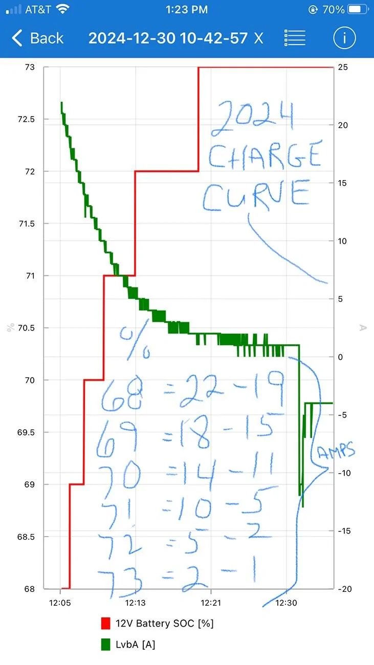

Did another full charge, reset BMS, locked & let vehicle alone for around 12 hours
Took a short trip today, vehicle seems to be charging better now, see photo

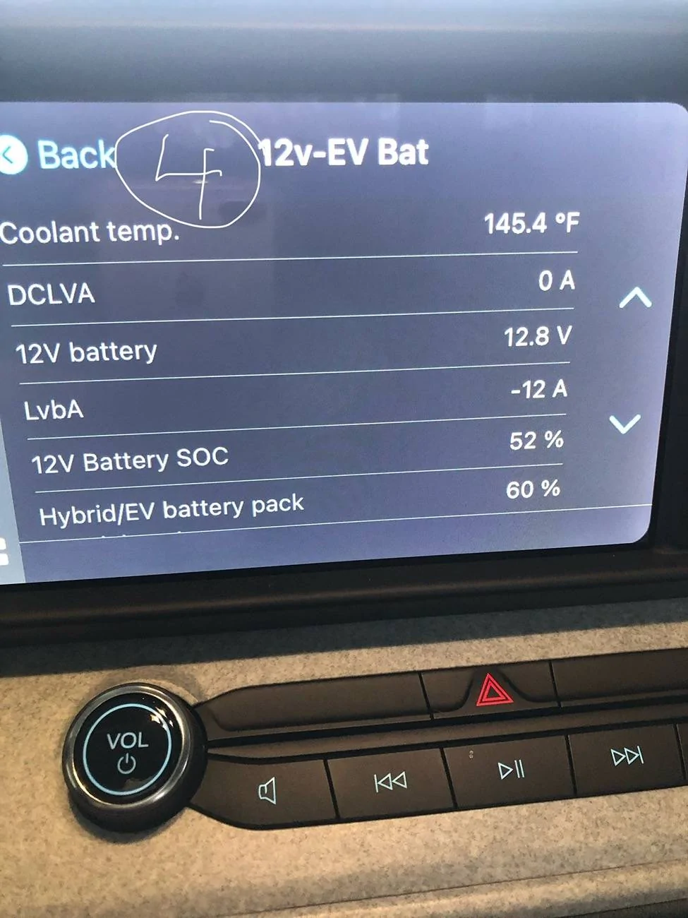

1-5-25 Follow up to post #162...see photos 1-4
Photo #1 is after a 20 minute ride, vehicle still on, 12v SOC was 50% at start, 52 after 20 mins.
Note that DCLVA was supplying 12 amps to 12v system, 1 amp of which was charging the 12v battery…… makes no sense, right?!

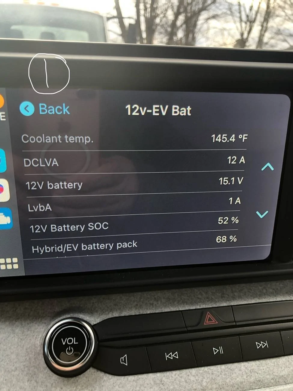

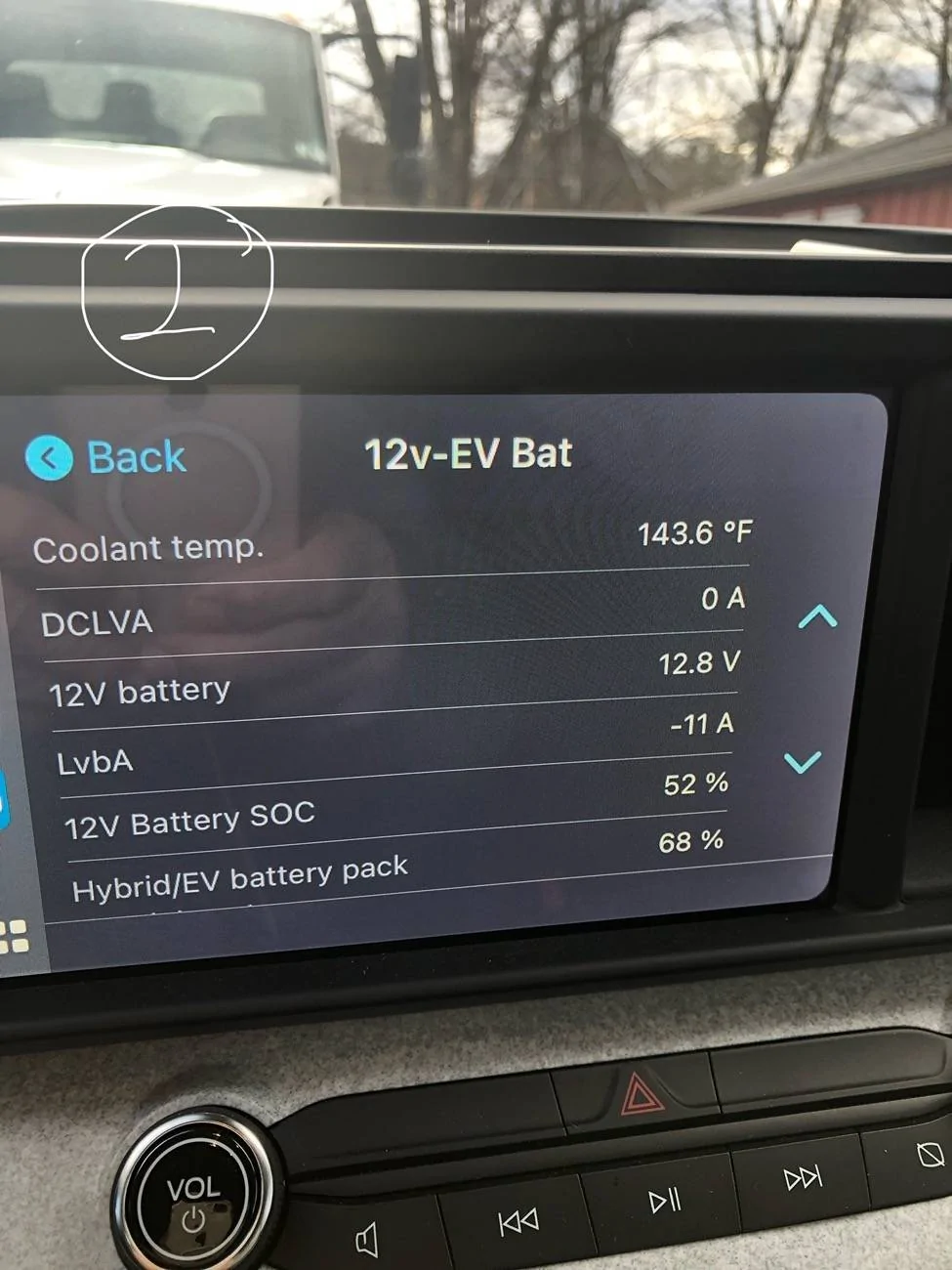

Photo #2 is after that 20 minute ride, vehicle turned off, 12v SOC at 52%(wow), DCLVA goes to 0 amps, discharge amps are 11 amps from the 12 v battery, but battery voltage is at 12.8v!
Photo #3 is after a start & 5 minutes home, vehicle running, SOC 52%, 1 amp charging, DCLVA supplying 20 amps to power 12v systems.
Photo #4, vehicle turned off, DCLVA to 0 amps, LvbA discharging at 12 amps, battery voltage is at 12.8v, which represents almost 100% charge, no?!
Also, I have the service manual for this vehicle, it’s good for most….., but they have very poor “Theory of Operation” for electronics components……
Being a Navy vet, my comment to ford would be….” You need to get your shit together”, or at least “get it in one bag”. Bill P, good night all…..

The 12.8v in #4 is the surface charge less the open circuit reading probably just over 13v since 12 amp discharge. Need to take reading after battery has no charge/discharge for at least 45 minutes (very hard to do on an active "flow" battery without removing battery and bench testing).
