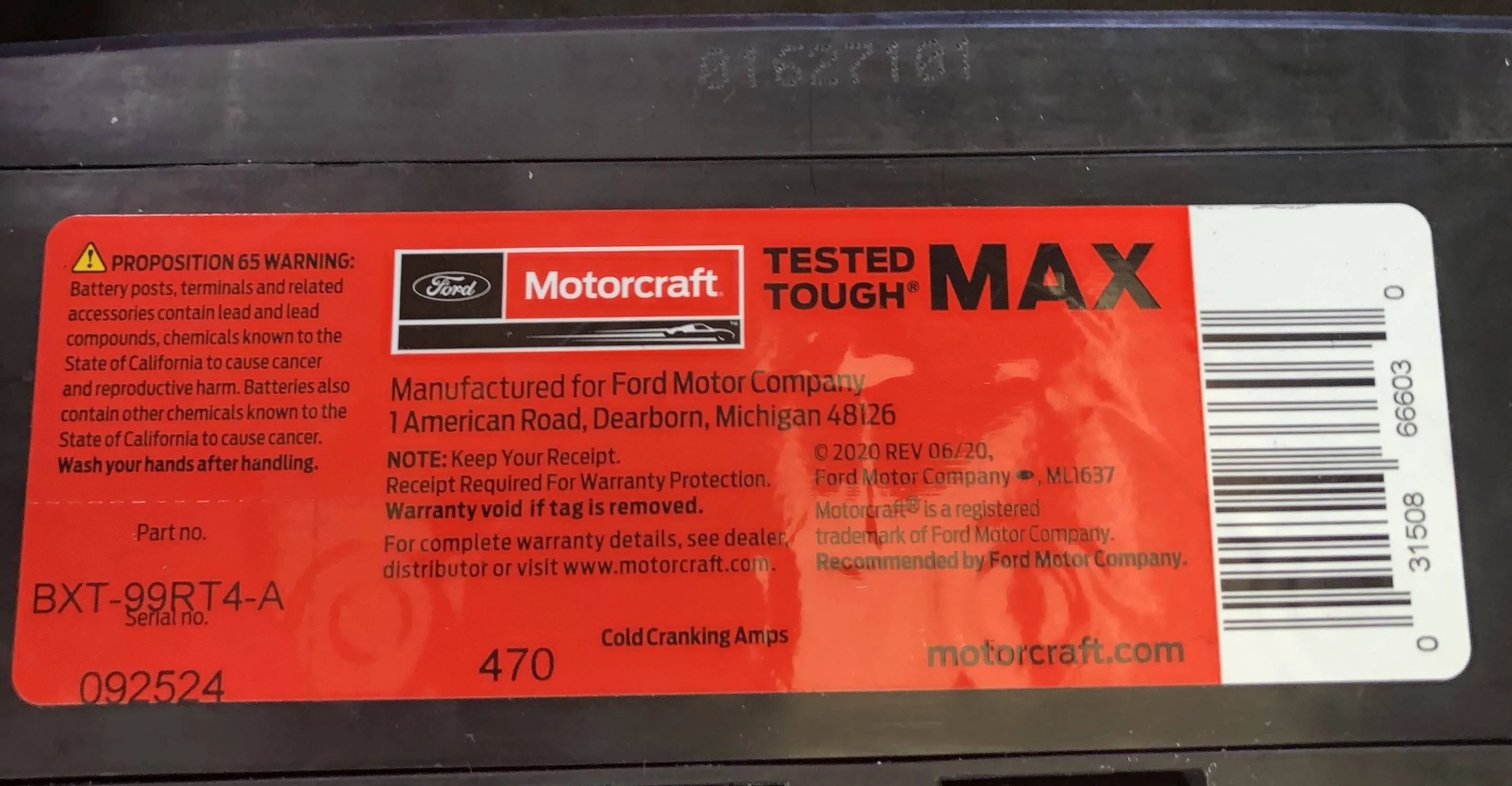

Was having various problems: dome lights not coming on when doors opened, pass side keyless lock/unlock not working, Sync display not firing up when door opened.
Dealer diagnosed it as a failing 12v battery and replaced it under warranty.
The truck didn’t just keel over, it was shutting things off as the battery degraded. The drivers side keyless lock/unlock kept working.
New Battery.
Ford Maverick 12v Battery Replaced Today IMG_0276

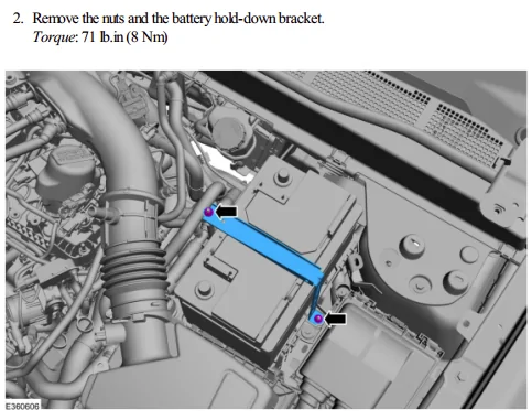

Trying, and failing, to remove battery on my 22 ecoboost, it is the original which failed a week ago at 3 yrs 11 months.
Removed all required items: hold down bracket, neg and pos cables. It will NOT pull up and out. I can get the front to come UP about 1/2" and pull forward to airbox.
Rear will not come up AT ALL.
This does not match any of the how-to write ups I've found,
no force within reason makes the rear move other than 1/16" side to side, or back and forth. Zero up!
Advice? Help? This is my only form of transportation
Not a plastic bottom brace in there, hard to see since black?
Hold down bracket may not be only thing used.
You may have noted the hybrid ONLY has that bottom brace to keep it in place - they work very well.

Although mine isn't a hybrid, if for some reason it does have it, HOW do I release it?
It appears if there is one - it should be on the more visible side, but indeed farther down.
Then again - I've seen brackets like this where a long threaded rod on the back side goes into the plastic block deep down, amongst that mess of pipes - very annoying.
Or it is actually bolted right there at the top?
