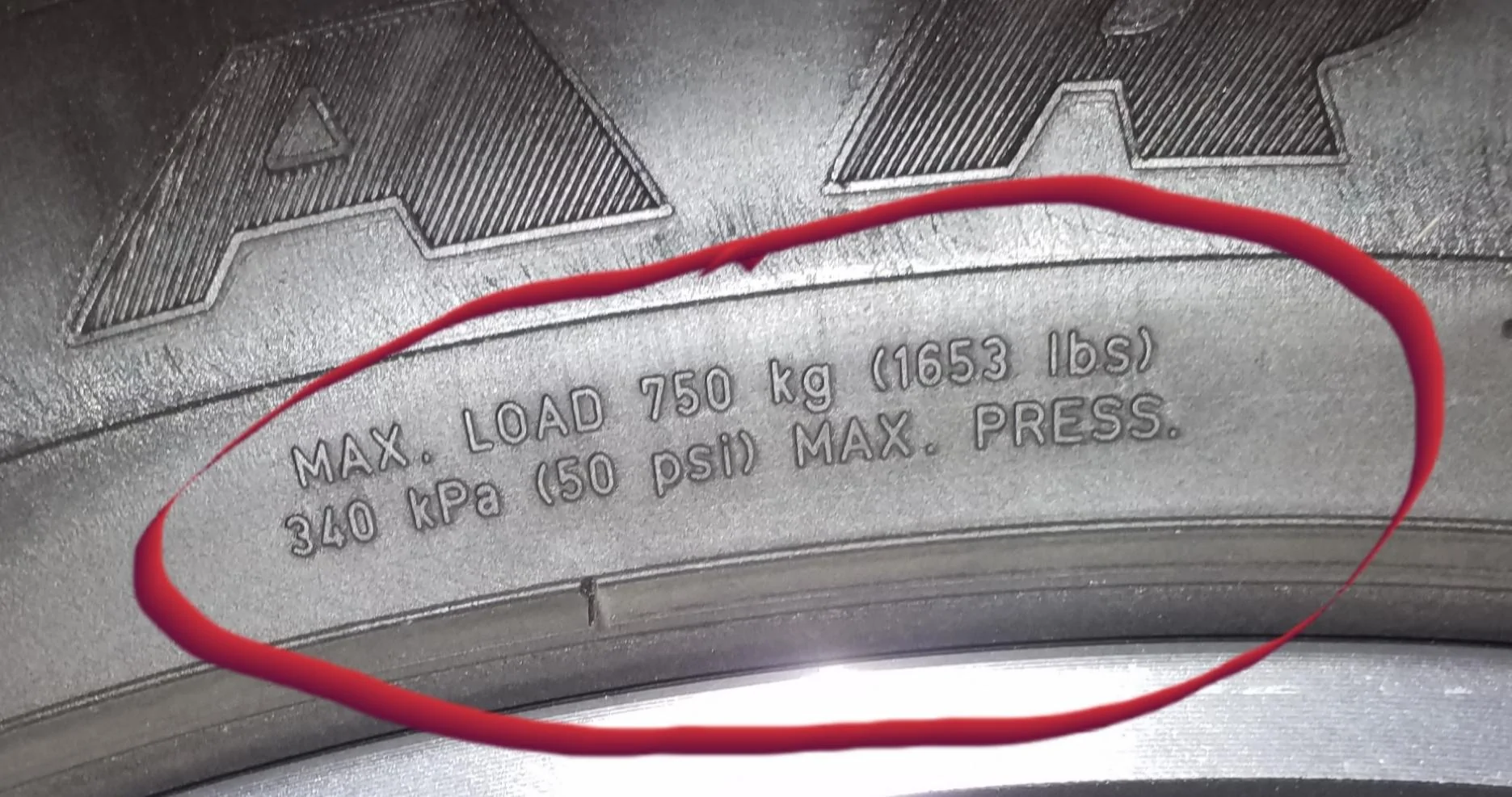

We don't have our Maverick yet.
For peace of mind could you REcheck the max pressure on the tire sidewall :eek:
This is the Goodyear on our car, small car!
Yes 50 is the max BUT you go 35psi as it says on the door because as you drive the pressure increases so if you start at 45 getting over 50psi happens quickly. I go by the door it's worked well for me for decades:)
