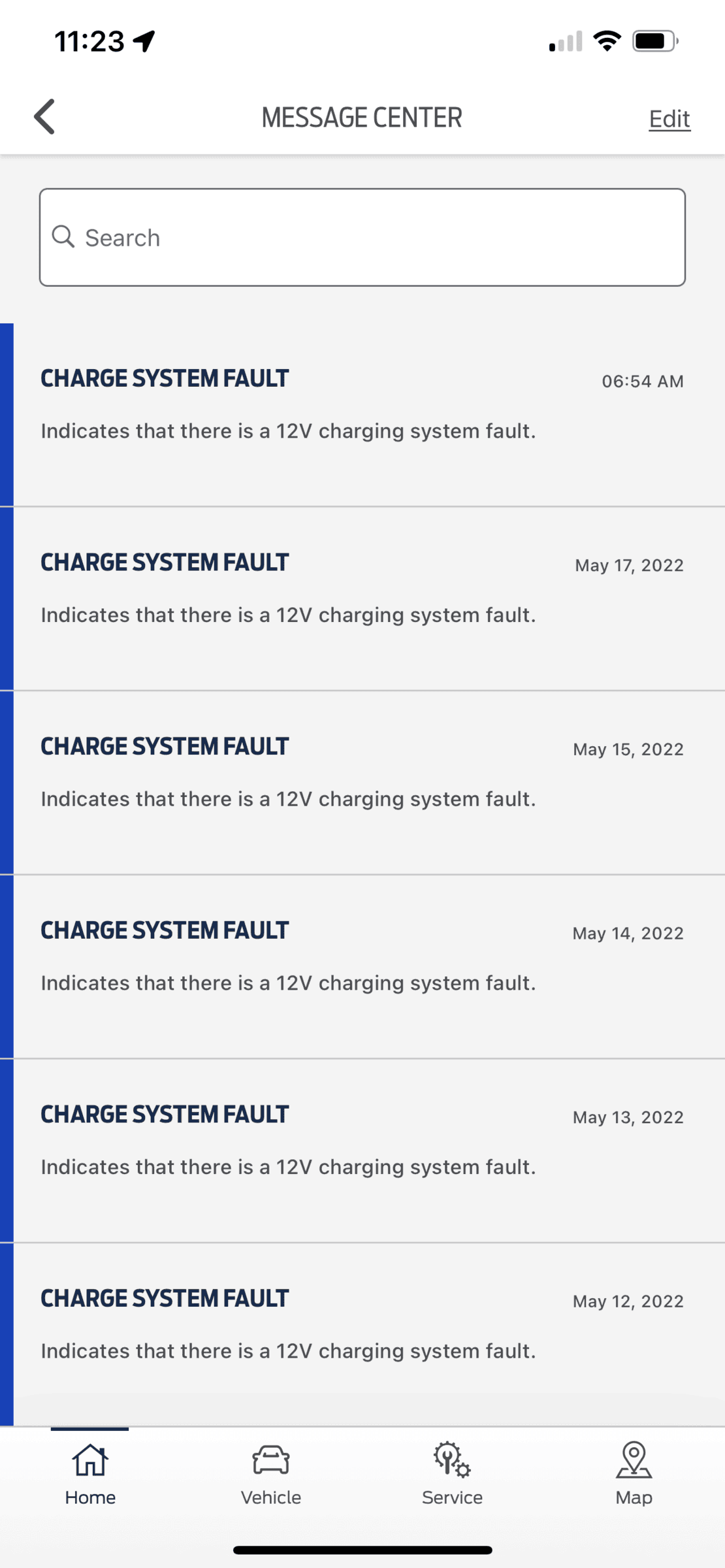

Ive been documenting MTC Maverick issues from day 1. As far as I know you’re the first to mention corrosion and water in sensors. Did they find a massive water leak from the hood to the engine bay?
Rob-
I Have this issue same as several other posters mentioned awhile back as I’m late to this thread… but the dealer asshats plugged it in to scanner no issues and no lights! I have pictures, video, and FordPass now has over 60 faults in less than a month! Red battery light comes on, red alert, with audible tone saying service charging system 12v now. It’s due to water getting into the harness. It’s not just the ford Maverick that is having this issue!! I continue to fight to get mine fixed by the knuckleheads! Thanks for documenting and helping.. but this issue is annoying! Thankfully on the Maverick when it happens you can still drive it! On some of the f150’s and explorers when this happen the vehicle will be inoperable.
