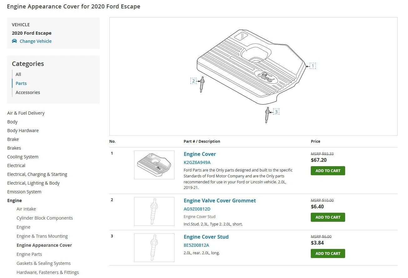

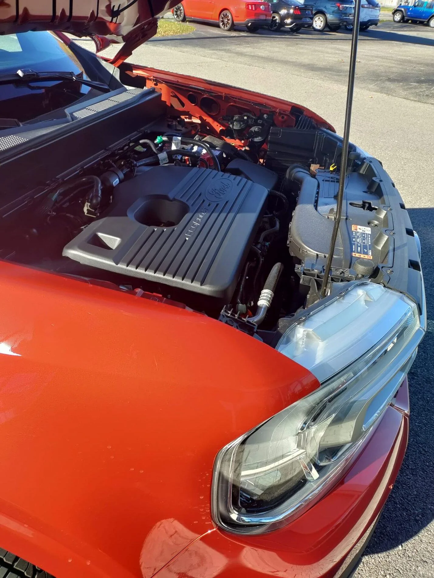

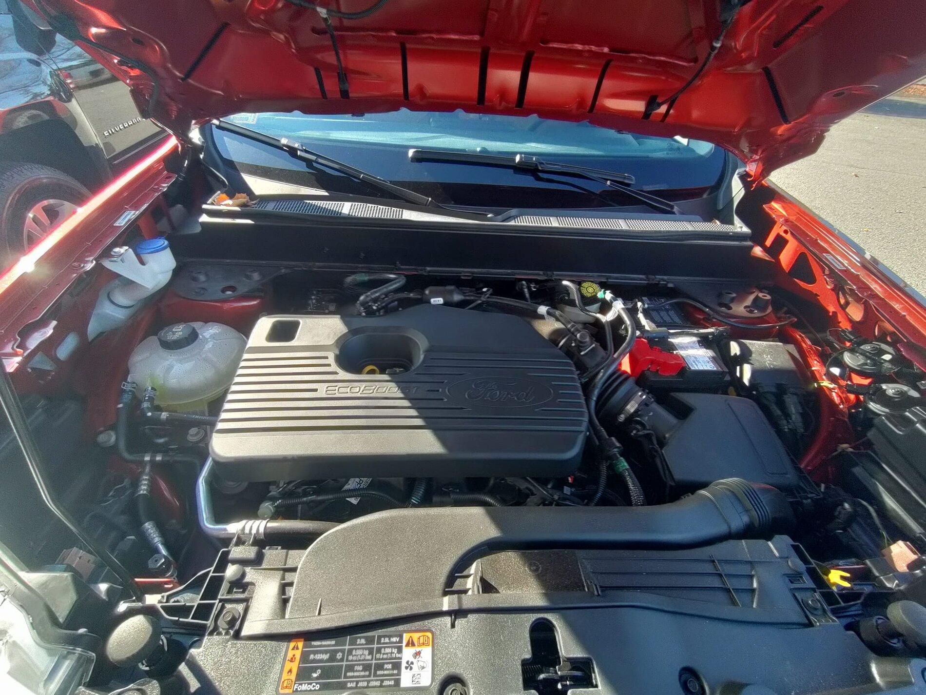

Thought y’all might like seeing the engine bay cleaned up a little. I bought the cover available for the Escape 2.0.
Fits great. You will want to buy the additional studs to secure it with but all in it was only about $75.

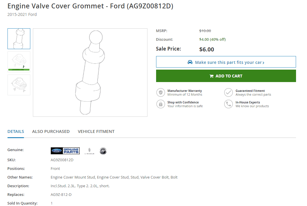

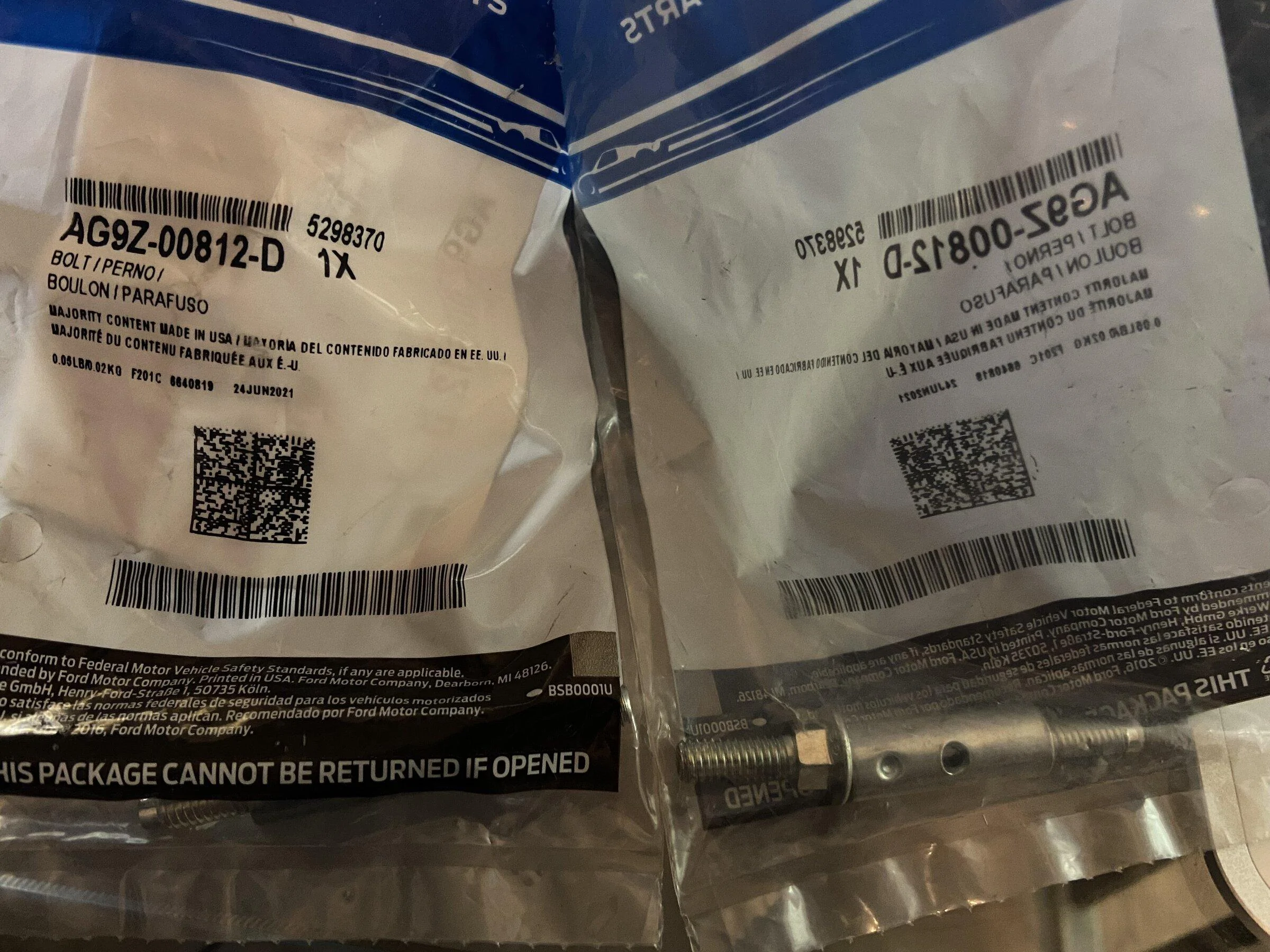

Hey guys, created this account just to post on this thread. Figured I'd give some info on this topic as I am trying to figure it out along the way. This mod seems like it should be simple, but I've found myself on a bit of a parts hunt.
I am having some issues finding the correct Engine Valve Cover Grommets. Since I couldn't really find a clear answer in the thread, I figured I would just order X2 of each of the studs (P# 8E5Z00812A and P# AG9Z00812D) with the intention of returning whatever I don't need/use. What they sent me for P# AG9Z00812D does not match the drawing that was on the site. I called my dealership and spoke with the parts counter and had him look up the part. He emailed me a picture of the same part that I received, so this is what will come if you order it. The parts counter guy said he is going to look research a bit on his end and see what he can find as well. However, there are pictures in the thread DO that show the correct "ball" style stud mounted in the back. Maybe the actual "ball" stud is actually a just a rubberized cover and a completely different part, and the part referenced is actually just for the bolt? I'm not sure and it seems like I may be going to the junkyard at some point just to pull off what I need.
Please let me know your thoughts or if you have some insight for this. I'm not really a mechanic, so there might be some obvious things that I am missing or am unaware of.
My plan is to eventually make a detailed install with pics and instructions when I get everything worked out.
Also - The engine cover P# K2GZ6A949A is NOT hard plastic, its a semi-soft foam material (I believe this has been stated in the thread before), so just a heads up.
Ford Maverick Engine Cover installed in 2.0L Ecoboost Maverick engine bay (From Escape) Engine Valve Cover Grommet
Ford Maverick Engine Cover installed in 2.0L Ecoboost Maverick engine bay (From Escape) IMG-0672

QUOTE WhteRbtObj
END QUOTE
From what I have gathered looking hither and yon, it seems that there is one fastener (passenger side, closest to firewall) that uses a fastener rather than a push-on ball/rubber grommet. That would be the fastener shown in your above image. I think you will need an 8mm nut to hold the cover.
Let us know what your parts person comes up with.

So I was thinking about it this morning and I decided to do the legwork and go straight to the source. Gonna head up to the dealership (hopefully today) which is not so far from me and see if I can get a look at an escape that has the cover set up and see what it looks like. There may be pics people have posted that shows this somewhere but I can’t seem to find any of these specific areas. I’ll take pics and post any info I find.
