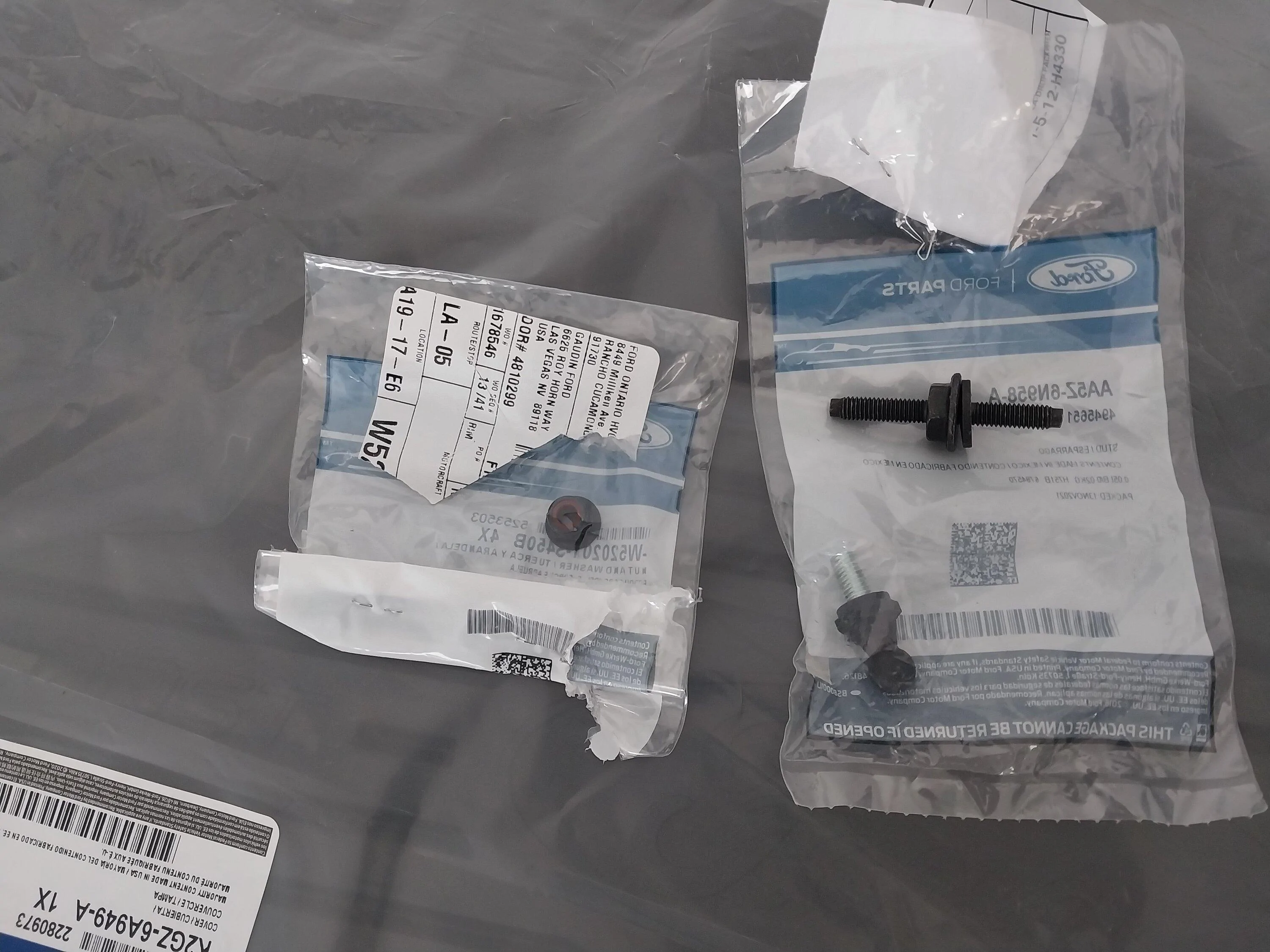

whats about the hardware needed to mount, do you have the list by chance?

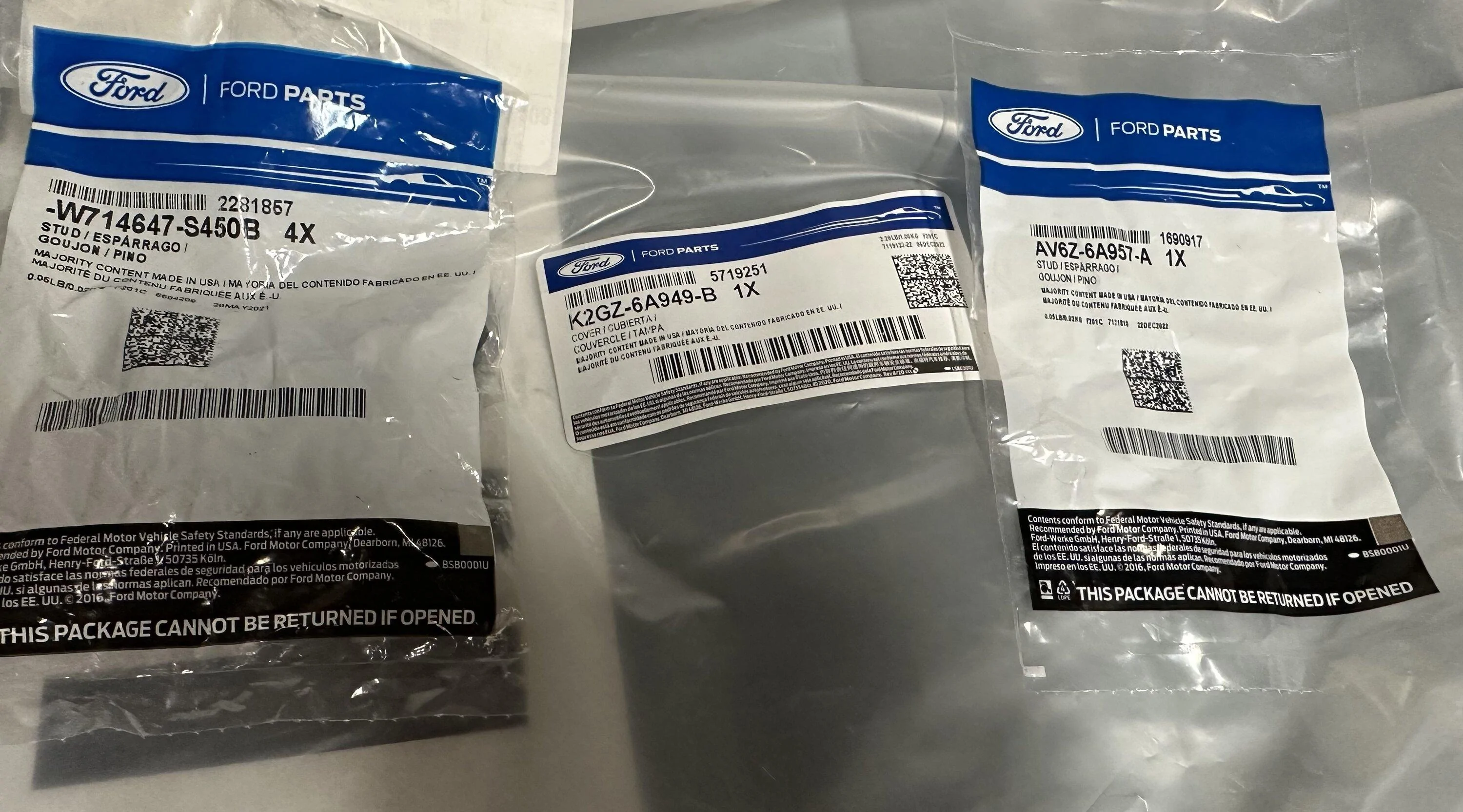

Ball stud ------------------ AA5Z-6N958-A
Threaded Stud ------------ W714647-S450B (comes 4 to pack)
Nuts for Threaded Stud -----W520201-S437 (comes 4 to a pack)
Cover -------------------- LZ6Z6A949B

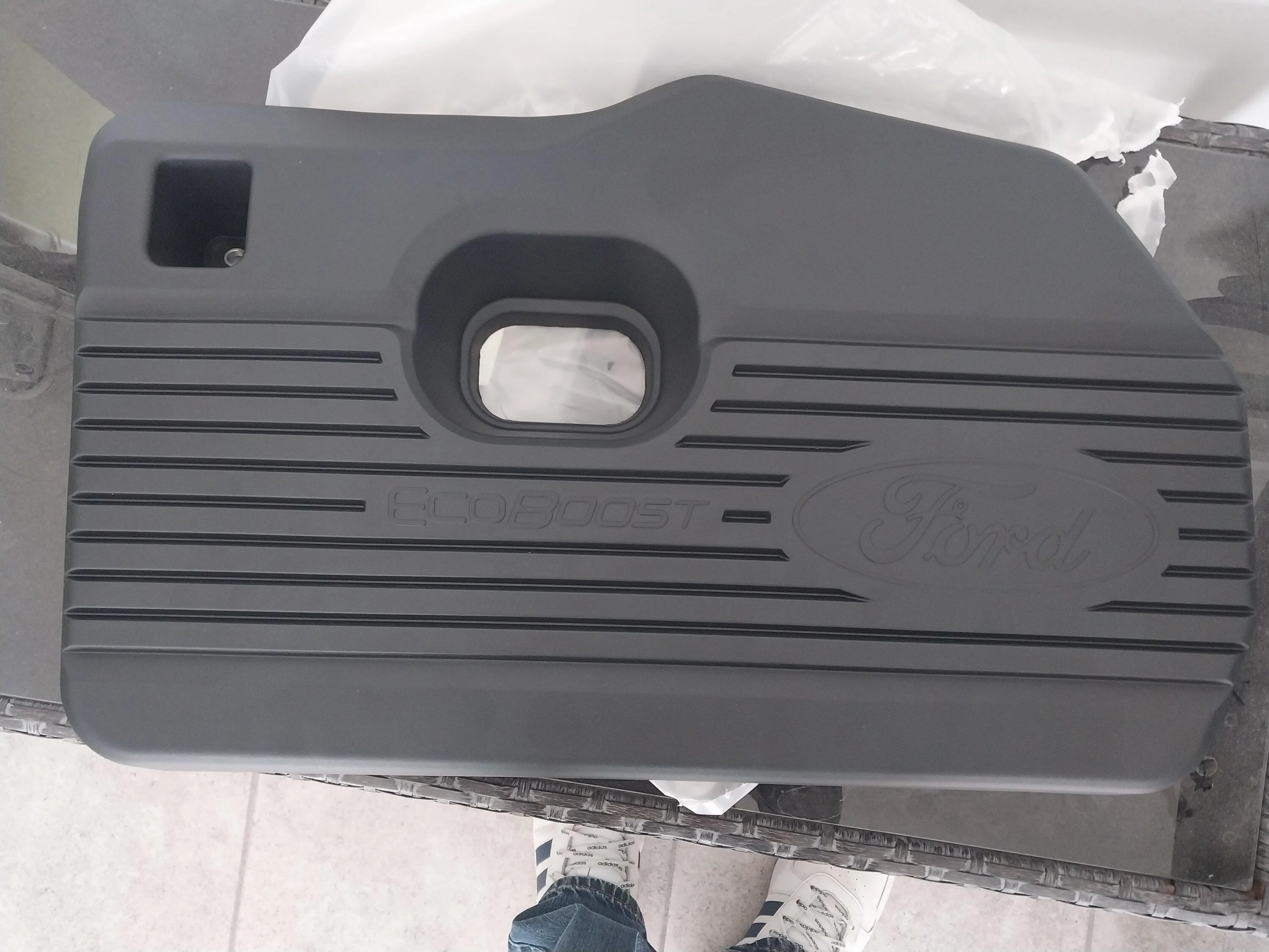

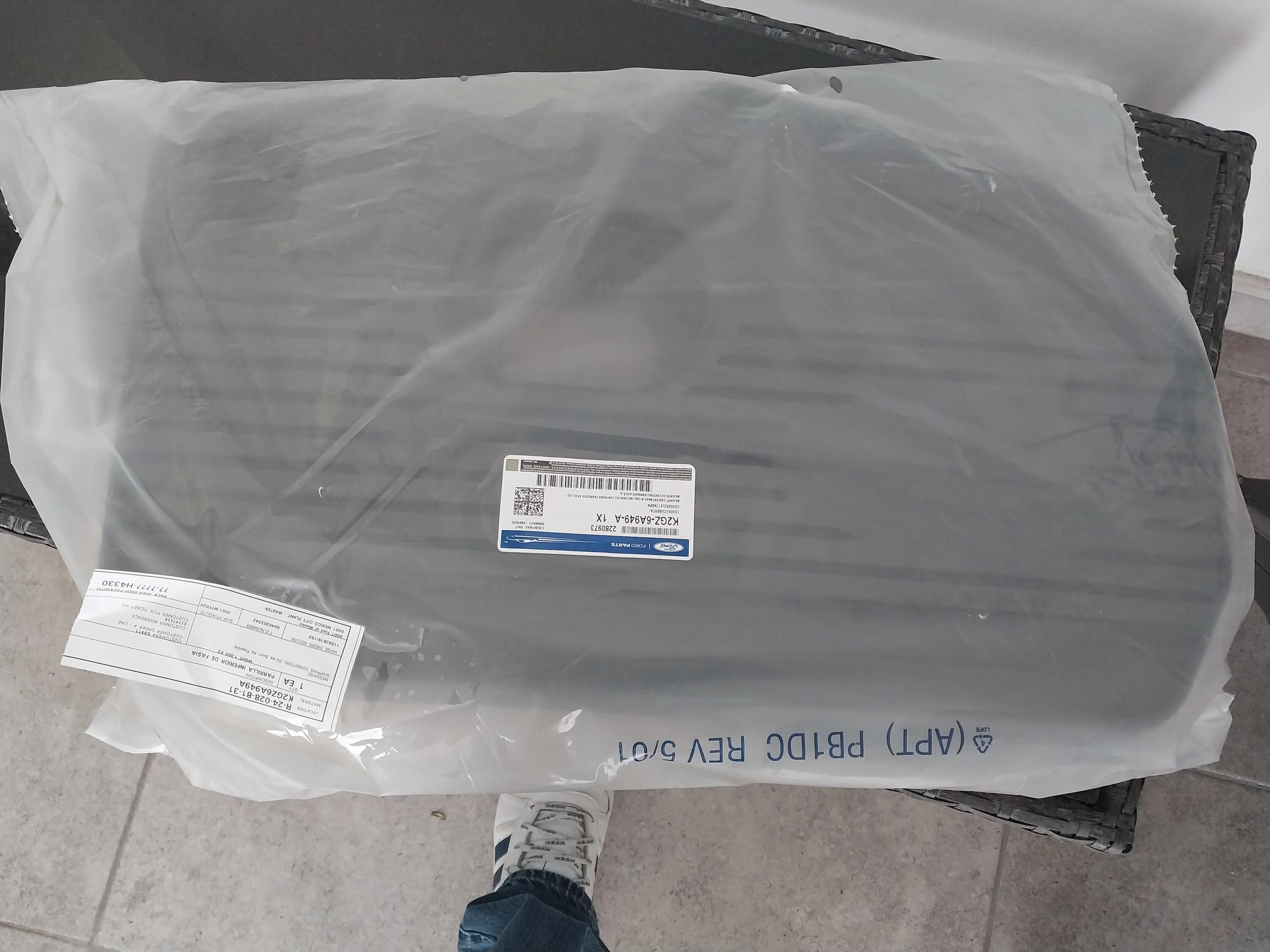

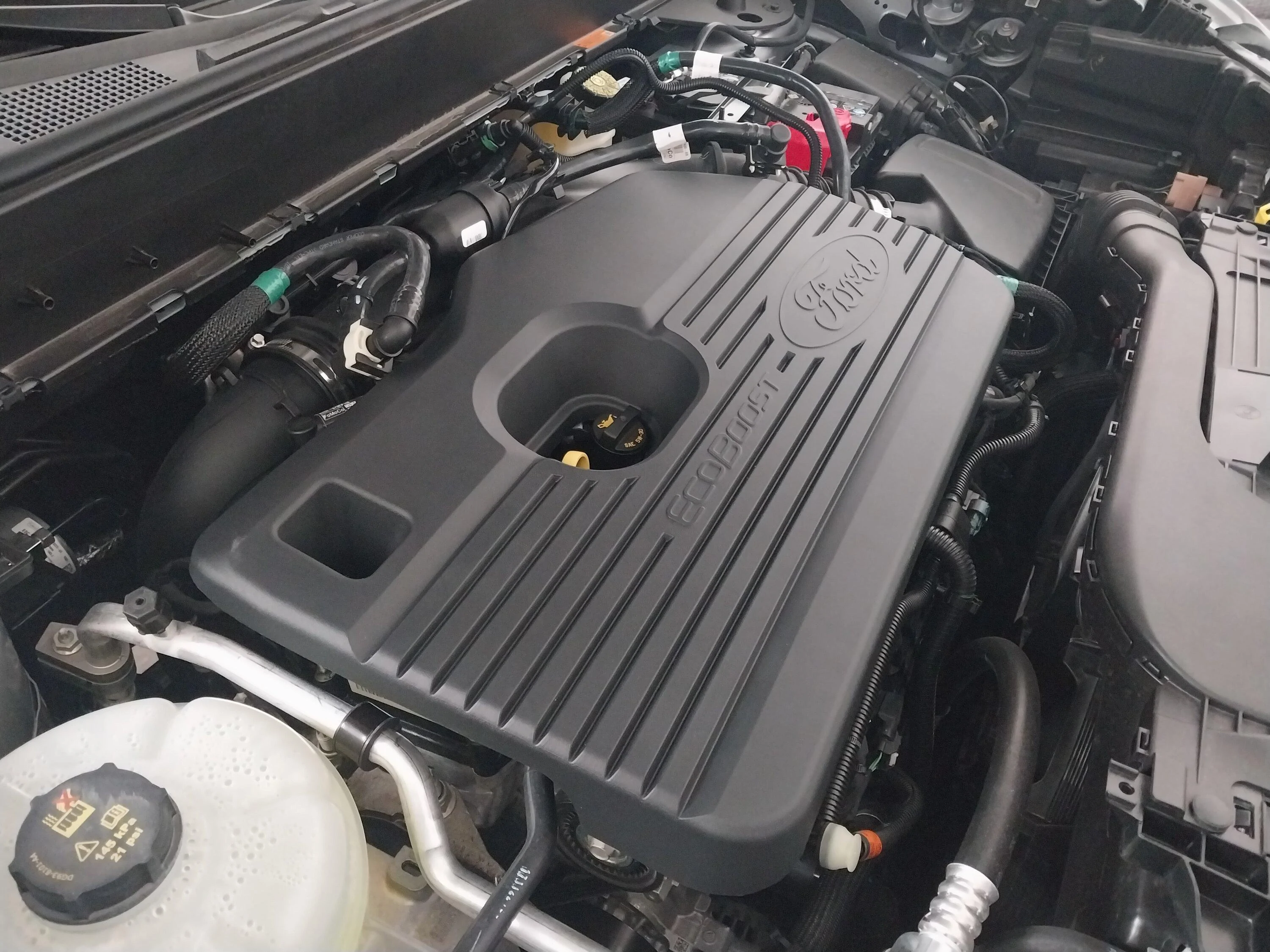

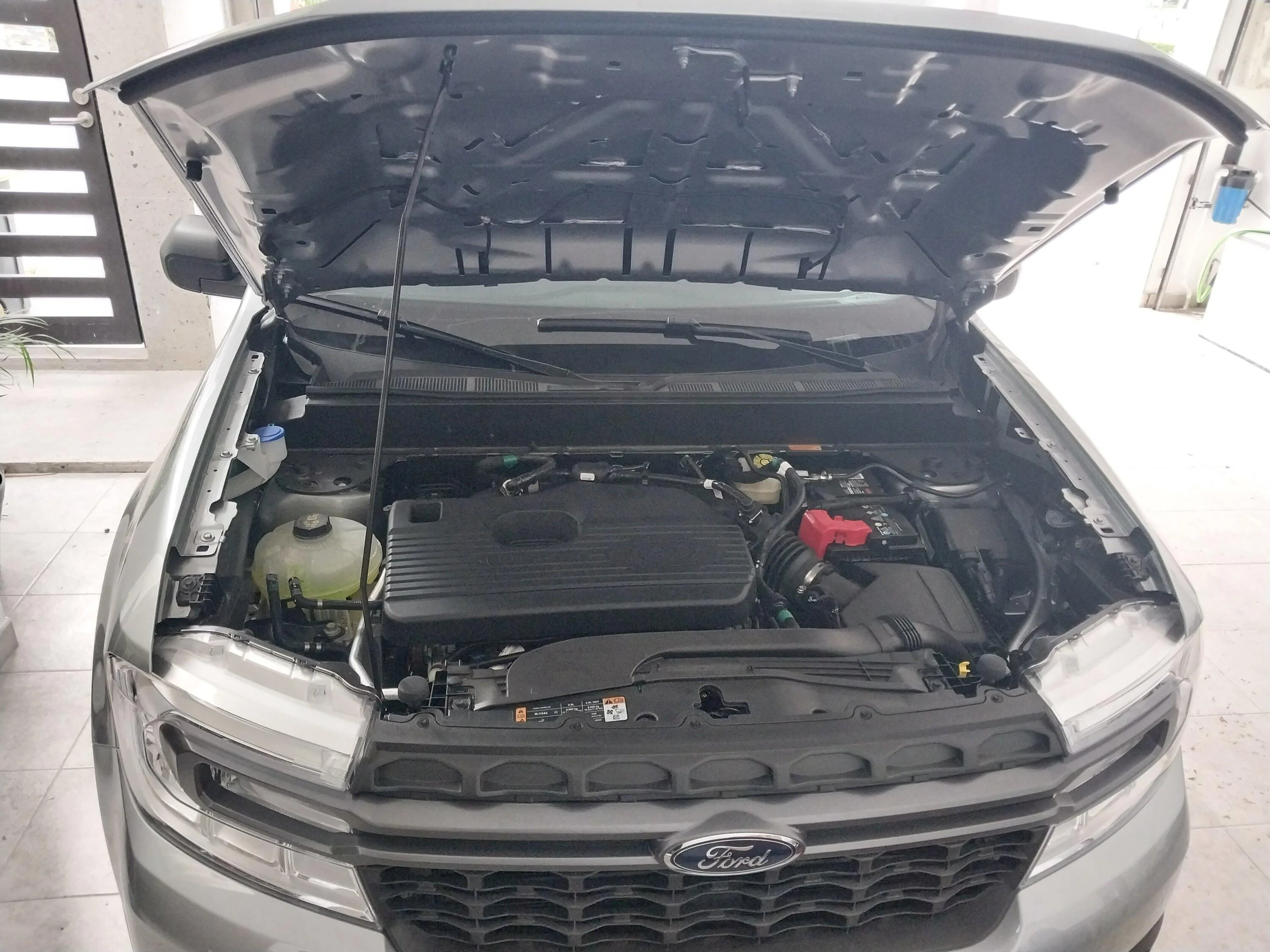

can you please send me or post the mounting hardware part #..
Parts list @ 1 each
Engine Cover - K2GZ6A949A
Engine Cover Stud - W714647S450B <-- this is just a stud with an integrated nut
Lower Track Nut - W520201S450B <-- this is a nut you need that couples with the above stud
Engine Cover Stud - AA5Z6N958A <-- this is the ball shaped stud ("post") you just need 1 (at least on my 2023 XLT EB , the engine already had two of these plastic studs integrated as part of the manifold
That is all you need, easy install! regards.

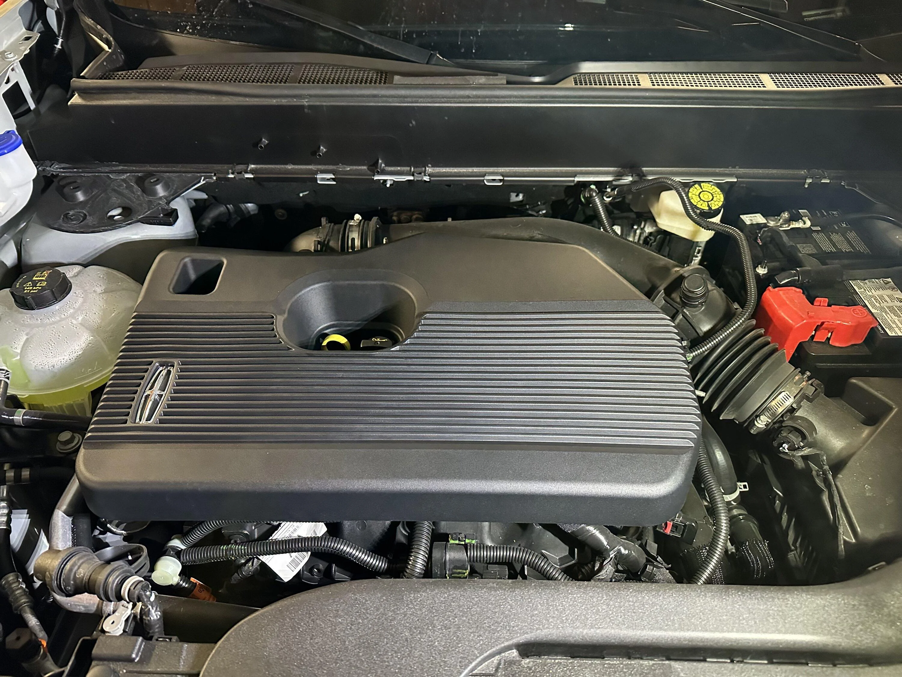

Put one on today and fits like a glove.
I didn't need the nuts for the stud, they came with the studs. Not sure if needed for the ford cover. Now to find something to hide the Lincoln logo.
Almost forgot, these are hot items. Went to a local dealer had an escape on the lot. They had the engine pictured online with the cover and was gonna ask if they would sell it. Someone beat me there and it was gone:ROFLMAO:
