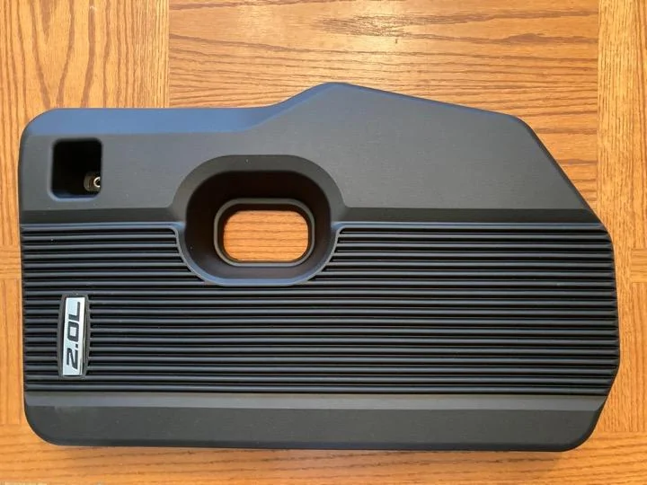

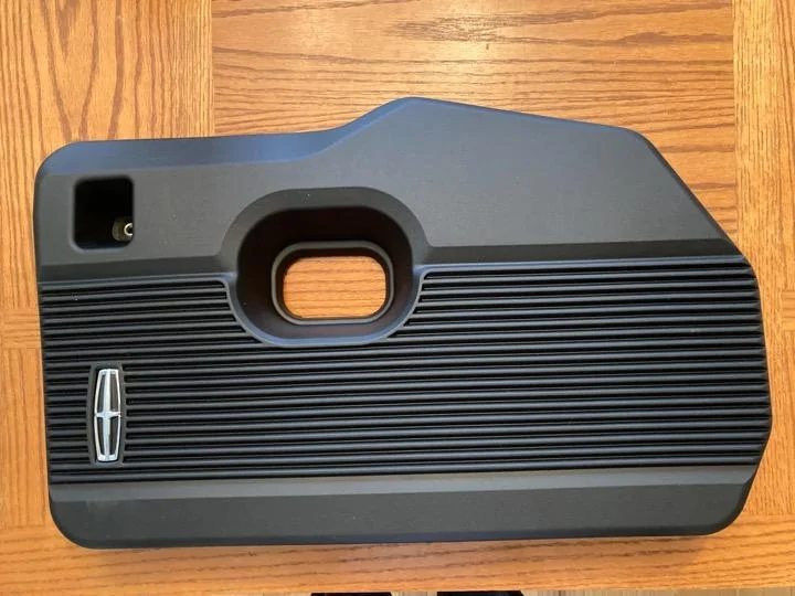

ENGINE COVER BADGE OPTIONS:
If you’re looking at getting an engine cover, you know that the appropriate “Ford Ecoboost” version — K2GZ-6A949-A — was discontinued and doesn’t seem to be available new anywhere.
But you also know that there is an engine cover that fits the Maverick Ecoboost — The K2GZ-6A949-B.
This engine cover fits the Maverixk exactly. Only downside is that is comes with a small Lincoln emblem on it.
Might not bother you — it’s just a small bit of plastic, and it’s easy to remove by pulling off the two small flat nuts that hold it from on the underside.
BUT … If you’re looking for another appropriate badge of the same size to put in that spot, I found two different small metal badges exactly the right size that you might want to consider. (I swear you CAN find anything on Amazon…)
One says TURBO. The other says 2.0L.
Chrome Finish Metal Emblem Turbo Badge
Chrome Finish Metal Emblem 2.0L Badge
These come with adhesive strips, but you’ll have to use Gorilla Glue or some other heavy-duty adhesive to get them to stick to the foam. They “press fit” snuggly into the indented area where the Lincoln emblem is, so that helps.
I think they look pretty good.
I ordered both emblems ($5.88 each) because I couldn’t decide which one to go with …
Here are photos of both, plus the engine cover as it came, with the Lincoln emblem.

I found these Maverick EcoBoost-appropriate metal emblems that fit in the indented area of the Lincoln emblem EXACTLY.
$5,98 each on Amazon.
Plastic Lincoln emblem easily removed (Two flat stud nuts on the back).
These badges come with adhesive strips — but you’ll need something like Gorilla Glue to get them to stick to the foam. Although they fit pretty tightly into the space, so aren’t going to jump out.
Here are photos of what they look like on the engine cover, along with photo of original.

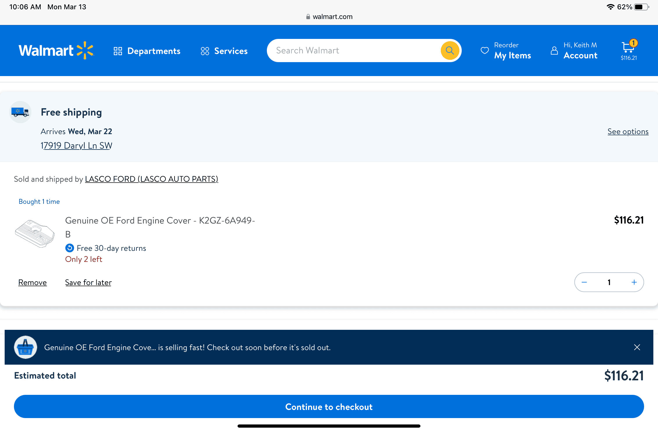

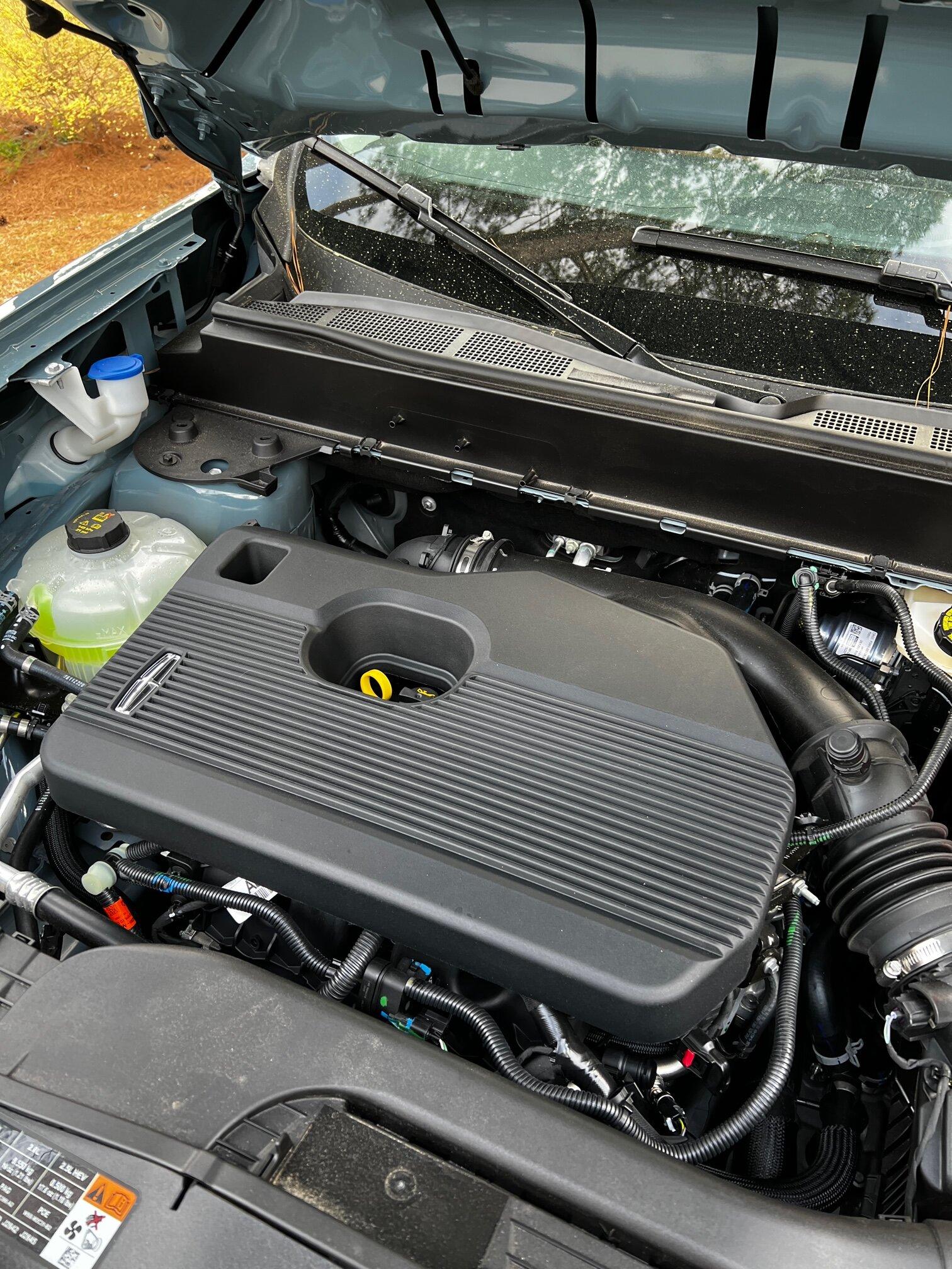

Just received mine from of all places Walmart.com, but came from the Texas Ford dealer….it definitely does make the engine compartment look finished

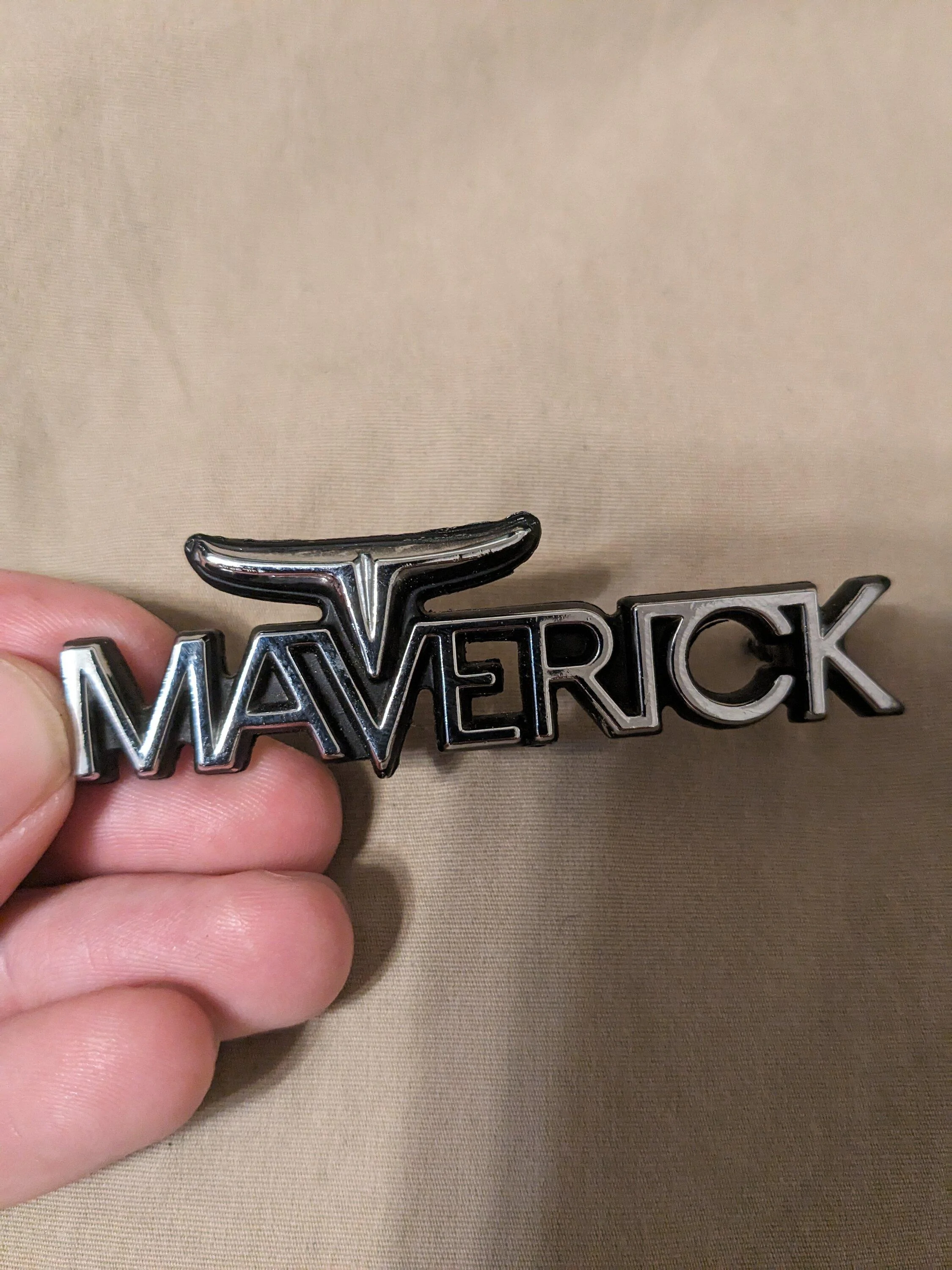

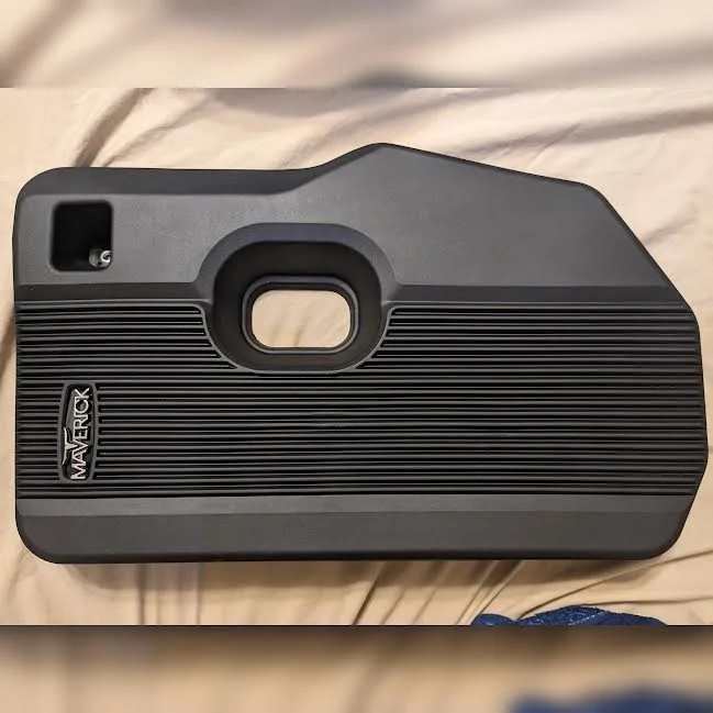

I ended up getting a Lincoln cover and found a vintage Ford Maverick emblem that fits pretty well.
This one I actually like. The other ones (Turbo, 2.0 etc etc) just don't look like they belong as much.
I'd really like to find a FORD one though. I've been on the lookout for a while now.
They could have just printed blank ones without any logo and used them universally. You'd think FORD would know that, but it seems they have chosen the true FORD way in the end anyways...

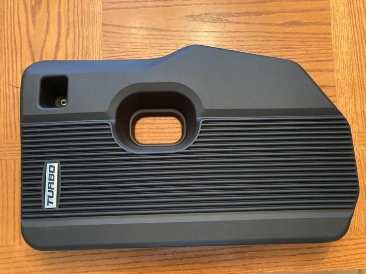

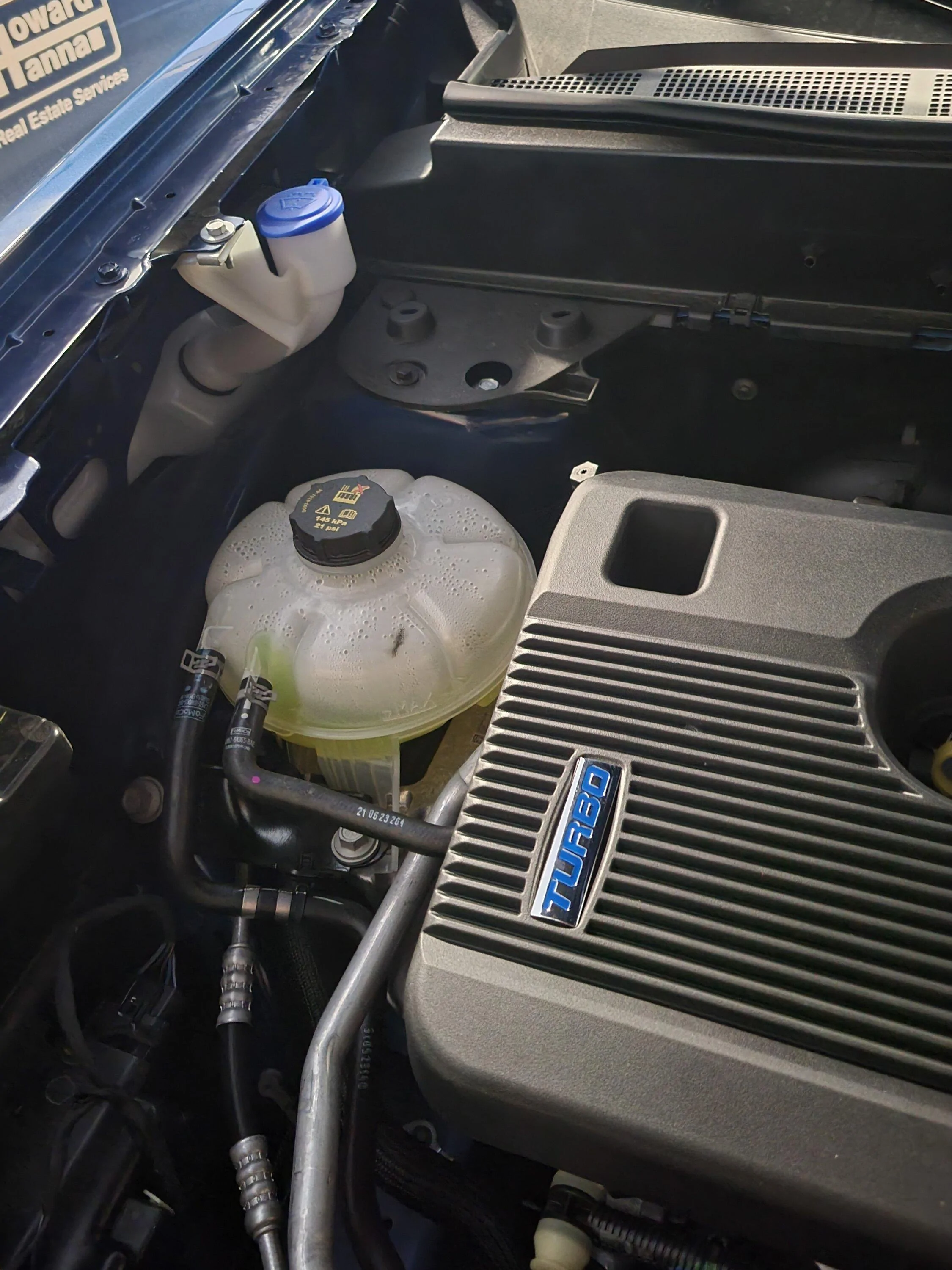

You rock! I couldn't justify $40 badge and bought the turbo badge from Amazon. Thanks again!
Ford Maverick 2.0L engine cover from Lincoln Nautilius compatible on Maverick Ecoboost? 20230901_193037

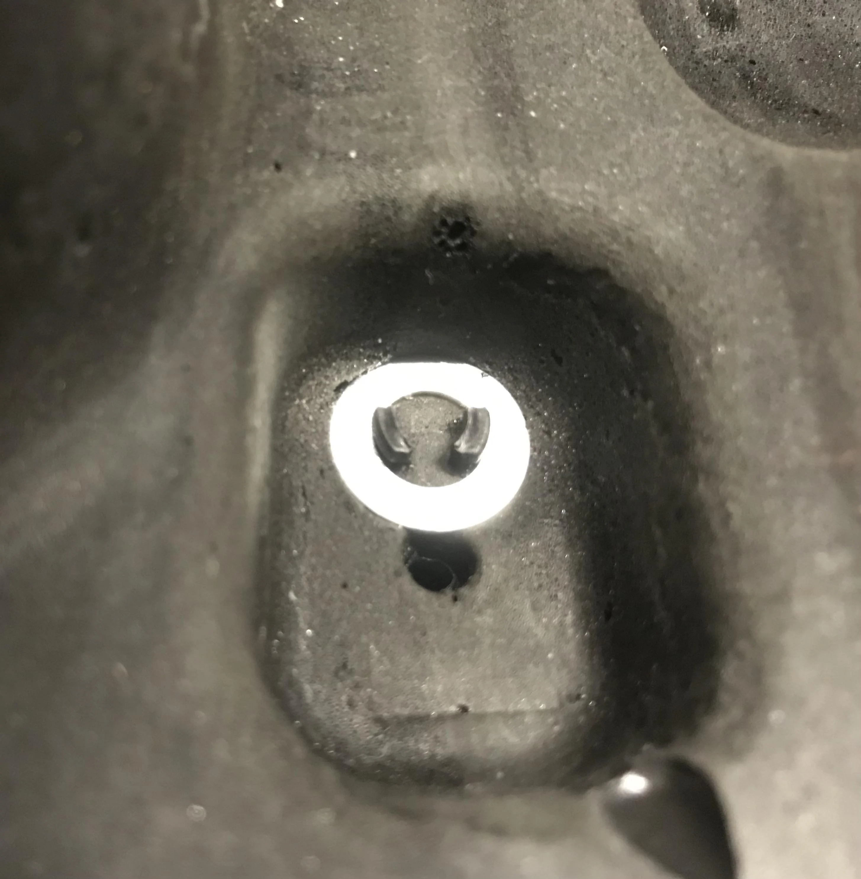

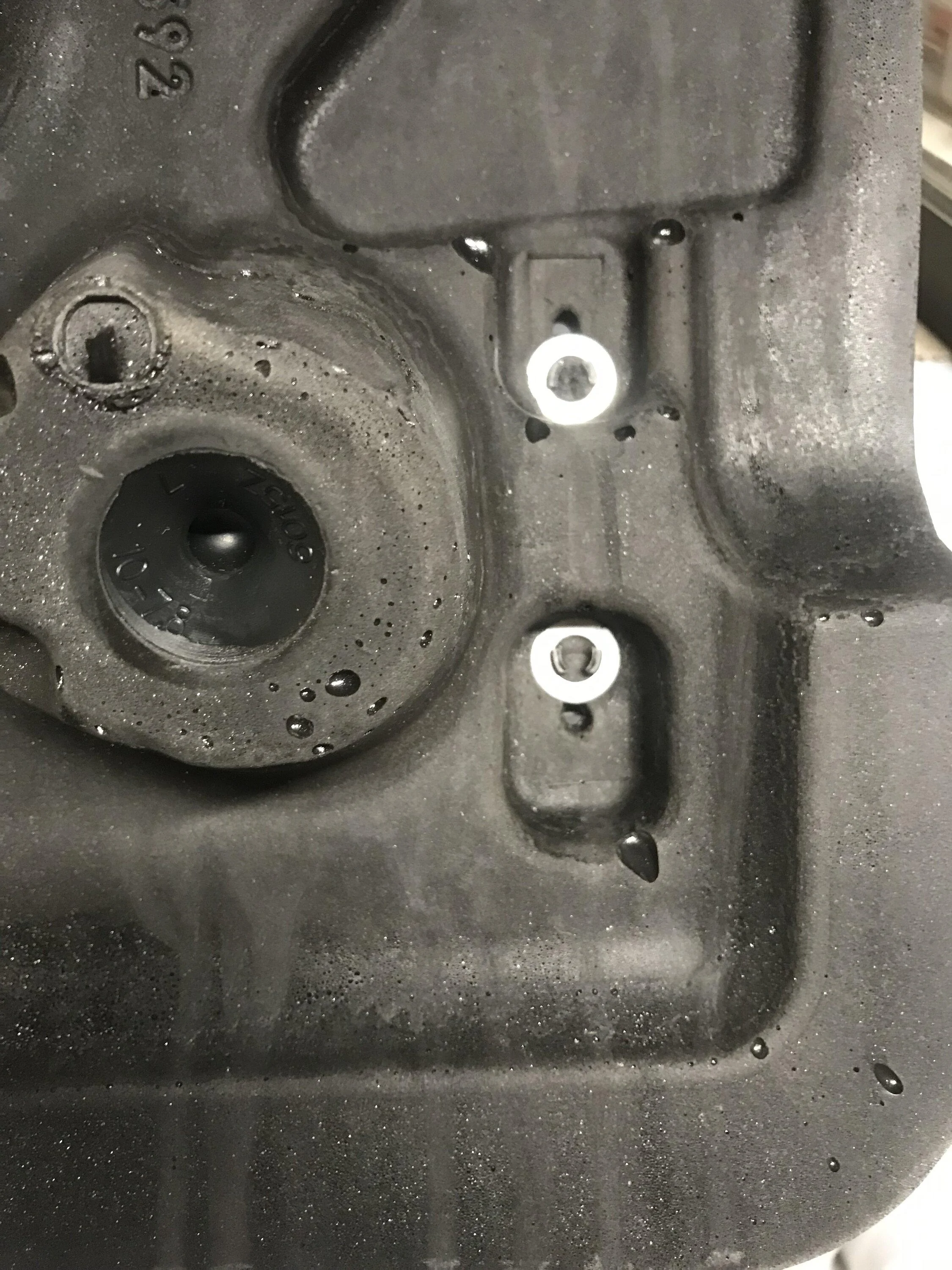

Just installed my Lincoln cover. I ordered the two studs too, but used a nut/washer leftover from my only other newly purchased vehicle - 1989 Mustang 5.0LX. It really does tidy up the top of the engine!
Ford Maverick 2.0L engine cover from Lincoln Nautilius compatible on Maverick Ecoboost? 0979596F-5645-483B-AEBB-FE0FC6441778
Ford Maverick 2.0L engine cover from Lincoln Nautilius compatible on Maverick Ecoboost? 74C6F0E4-B3A7-4B03-B773-353E7ACE5957
Ford Maverick 2.0L engine cover from Lincoln Nautilius compatible on Maverick Ecoboost? 887FC188-F9C8-43F9-9652-C97EB48D5DCA

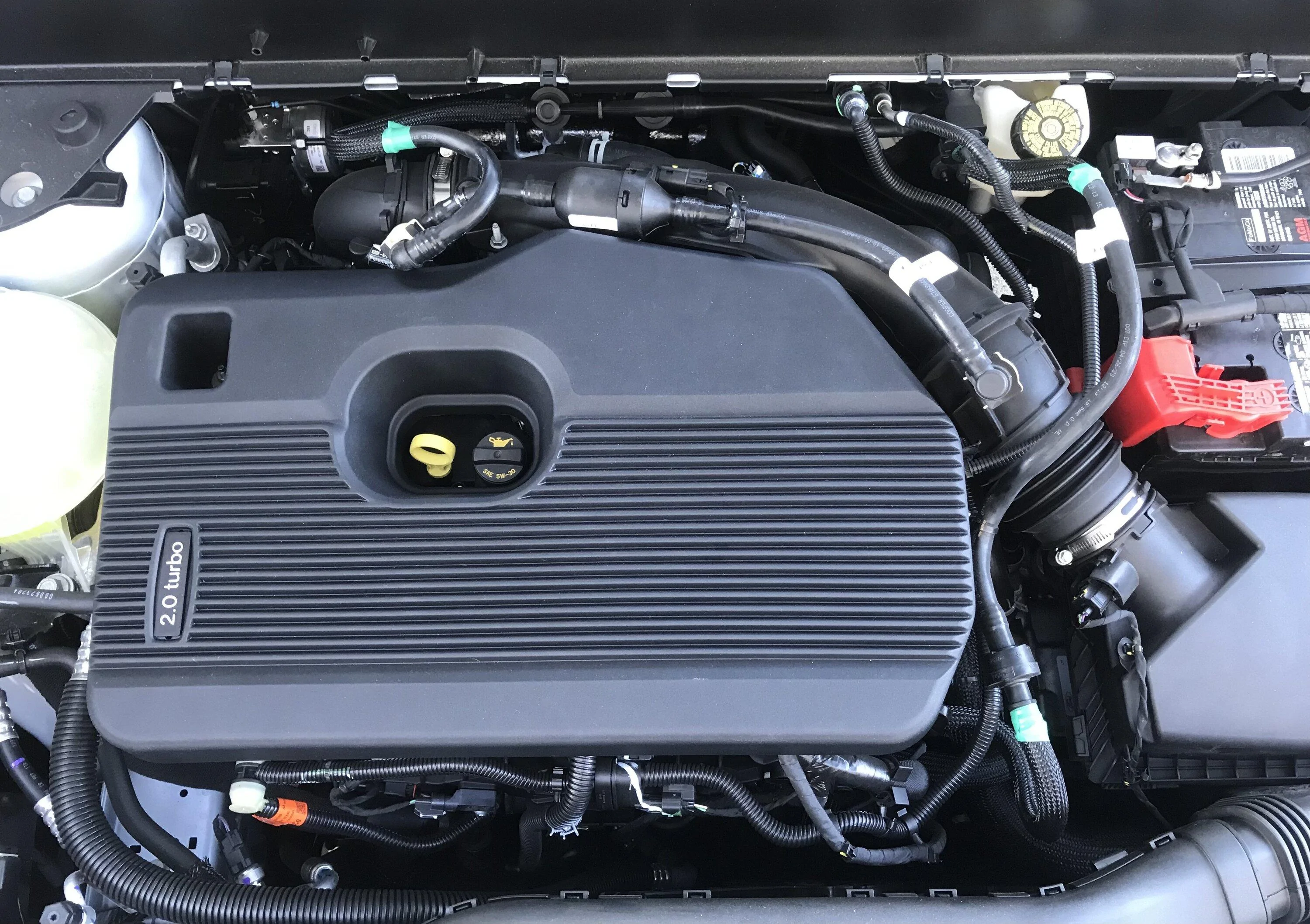

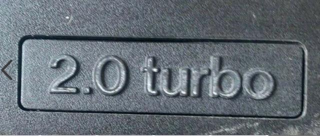

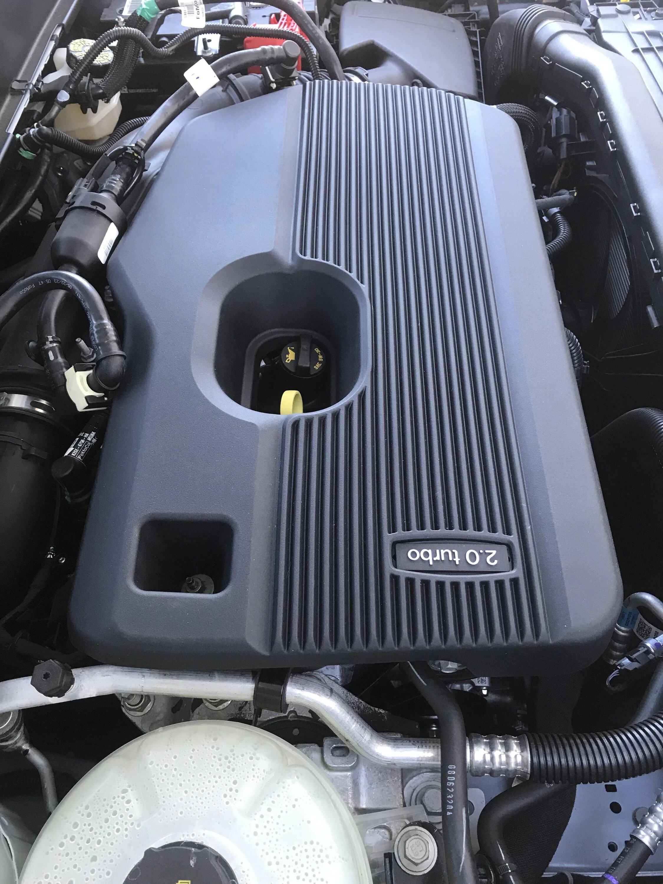

And I wanted an emblem that looked somewhat OEM to replace the Lincoln badge, and after an extensive search came across a SAAB part!
https://www.esaabparts.com/viewparts.php?searchpart=1&section=3150627
Emblem on Saab cover:
Ford Maverick 2.0L engine cover from Lincoln Nautilius compatible on Maverick Ecoboost? 0C6A9665-8B61-4778-9CFF-7361EF0423E2

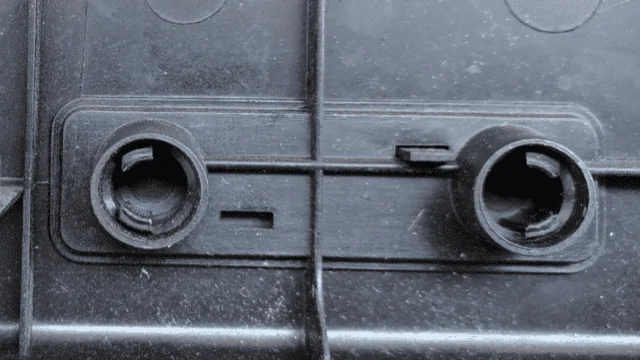

On the Saab the pair of tabs on each end snap into a tube with an internal “lip”:
Ford Maverick 2.0L engine cover from Lincoln Nautilius compatible on Maverick Ecoboost? 2D57835F-F0B9-46BD-A4B6-D73F40387DC1
On my cover I positioned the emblem, pushed it through the foam, then gently squeezed the pair of tabs with a small needle nose while slipping just the correct ID washer over to secure.
Ford Maverick 2.0L engine cover from Lincoln Nautilius compatible on Maverick Ecoboost? 6E53A1D5-CE34-45B1-AD41-6BD2CB5A67CA
Ford Maverick 2.0L engine cover from Lincoln Nautilius compatible on Maverick Ecoboost? 0639ADE1-2E39-476F-870F-26DBF0BC16B7

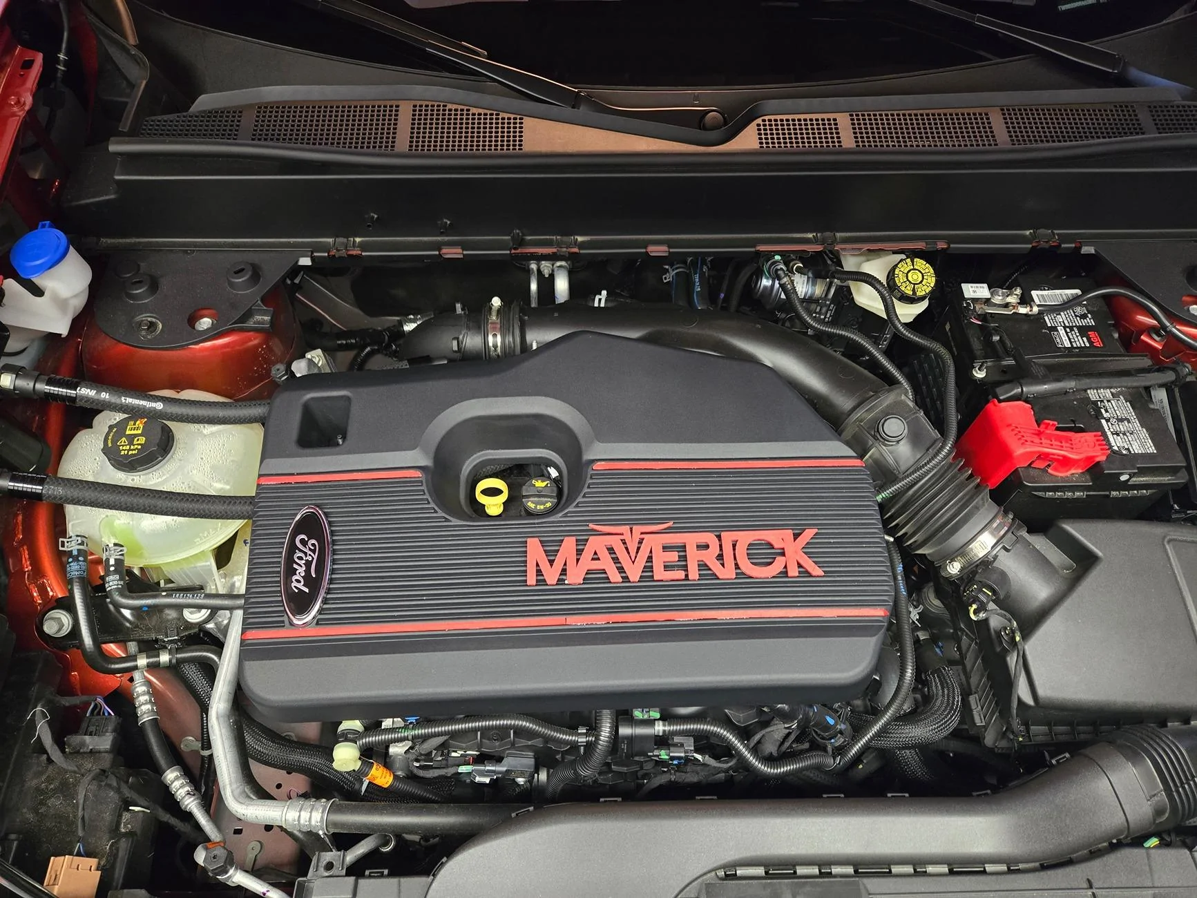

I couldn't find a Ford cover for the 2.0 Ecoboost, so I ordered the Lincoln version. I'm in the process of modifying it. This is what I have, so far. Not the best picture, but I'm not done yet.

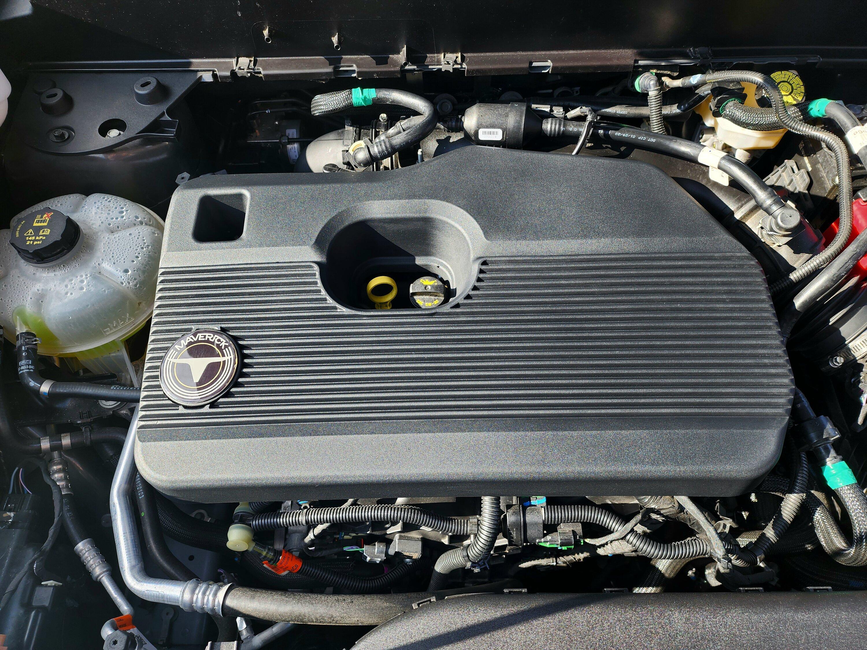

My take on the Lincoln cover.
Ford Maverick 2.0L engine cover from Lincoln Nautilius compatible on Maverick Ecoboost? 20240705_183841
