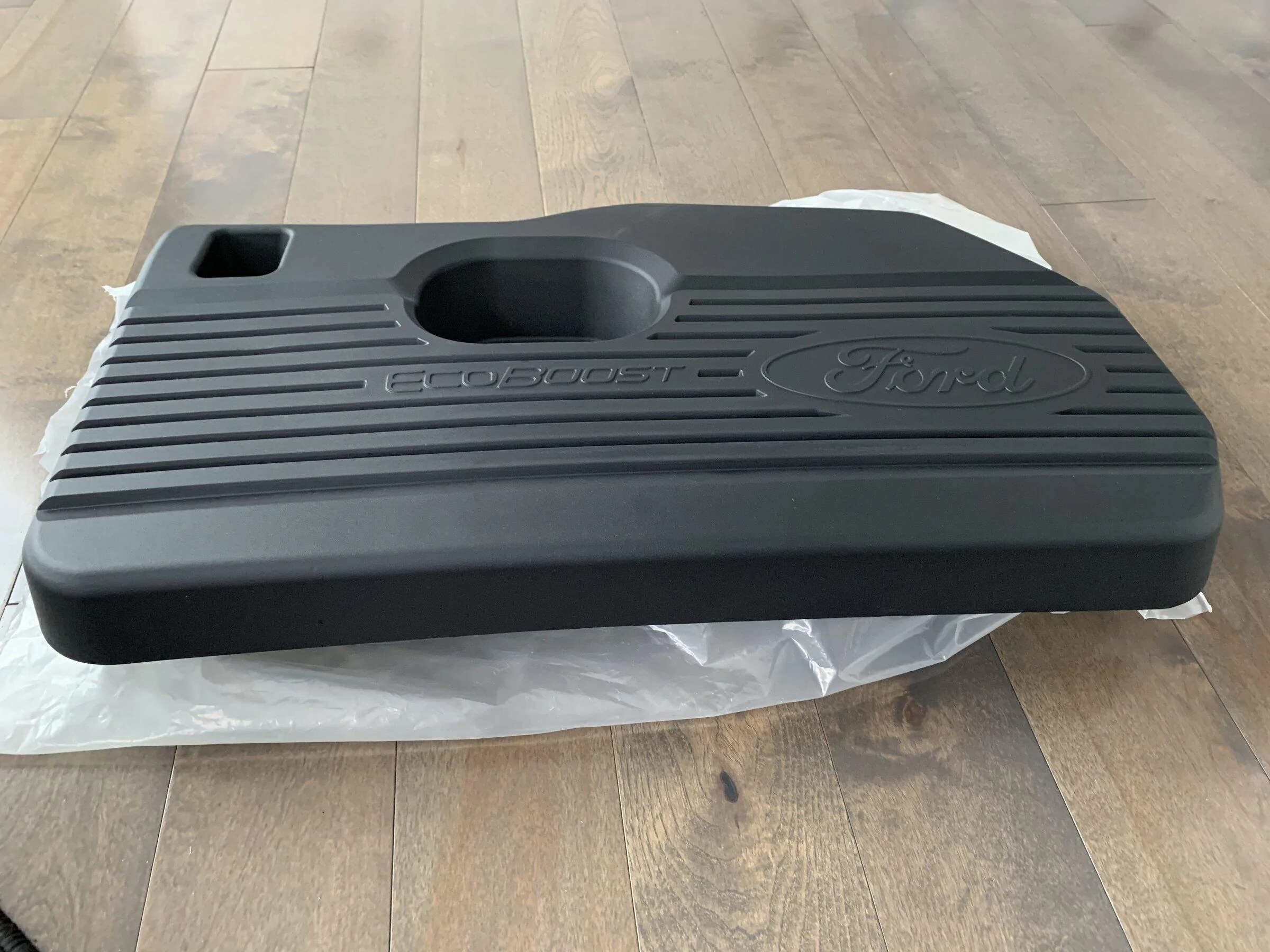

I got my cover in the mail this evening. It was packed in a box that was 2 inches shorter than the cover and was pretty badly warped. It would have probably straightened out after a time installed on the truck but it also had two deep indentations about the size of a quarter and about 1/4 inch deep on the top on it. It looks like something heavy was sitting on it in the warehouse. I wish I had just went to the dealer and paid full retail now. I am going to see if I can return or exchange this thing. Just a warning to anyone ordering one online.

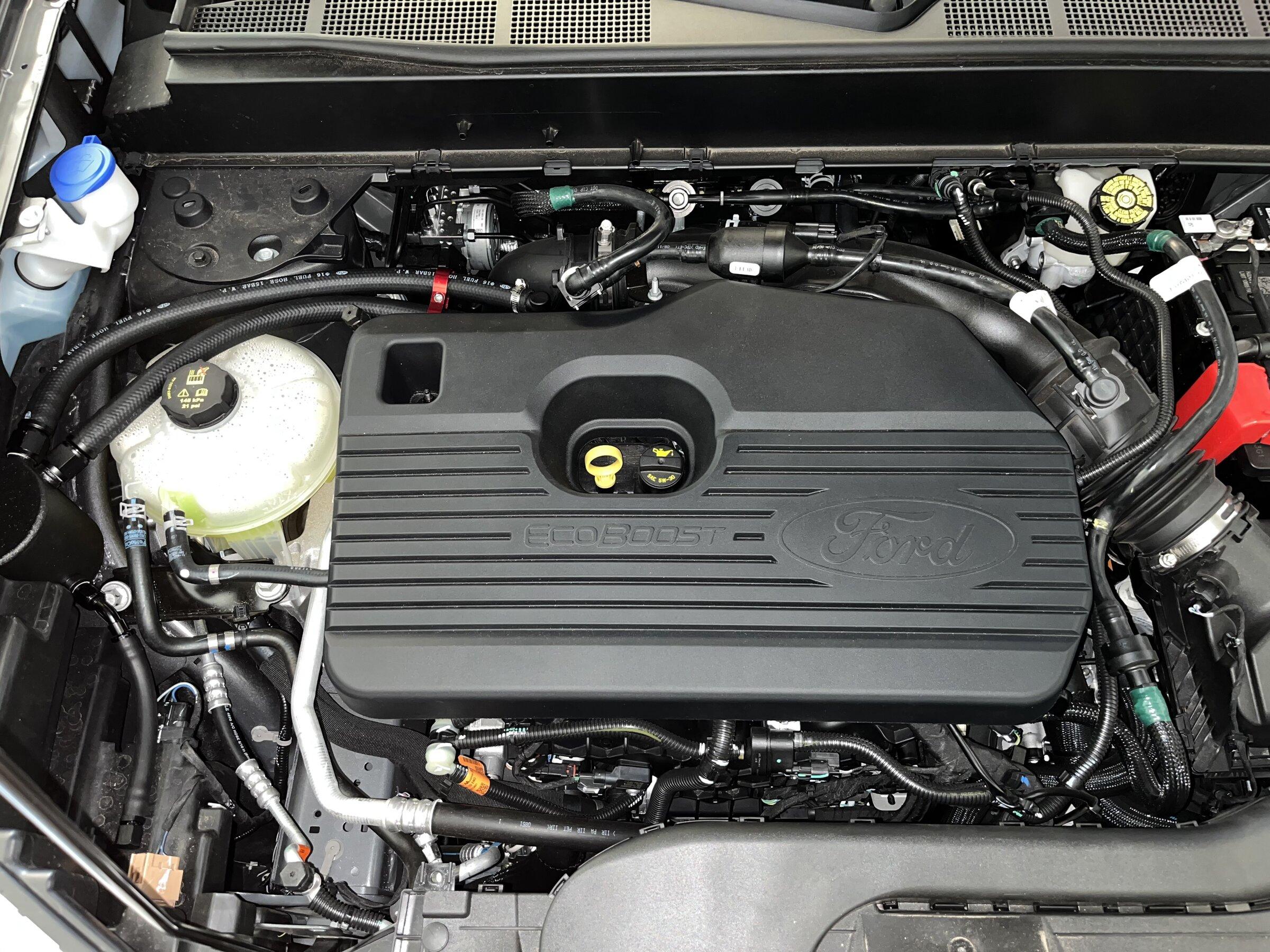

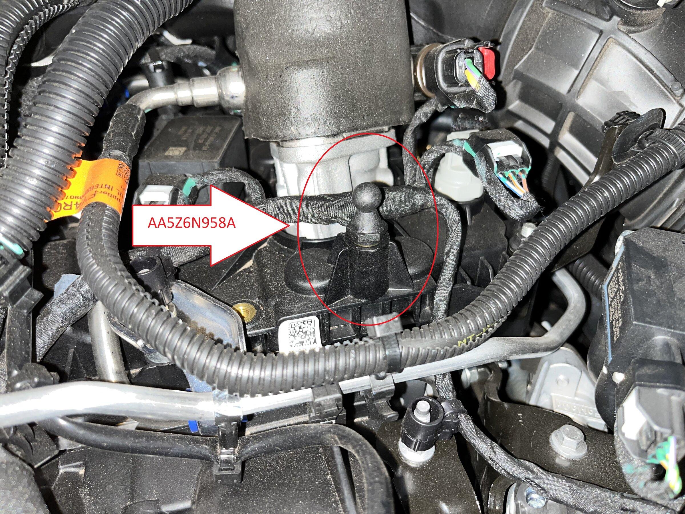

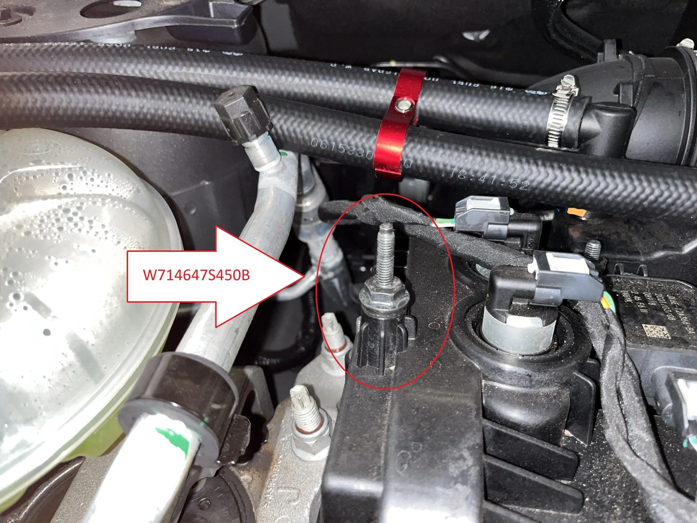

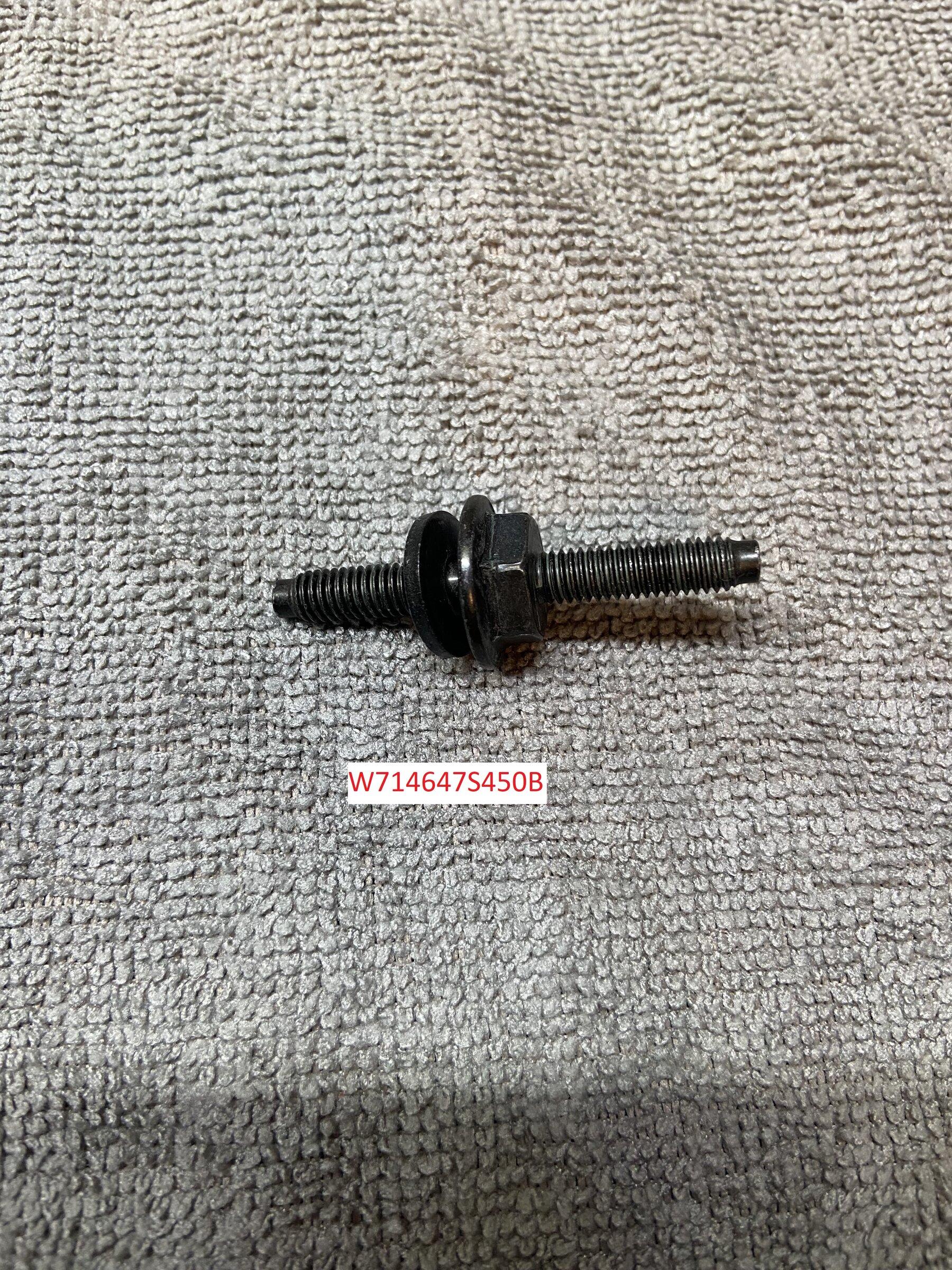

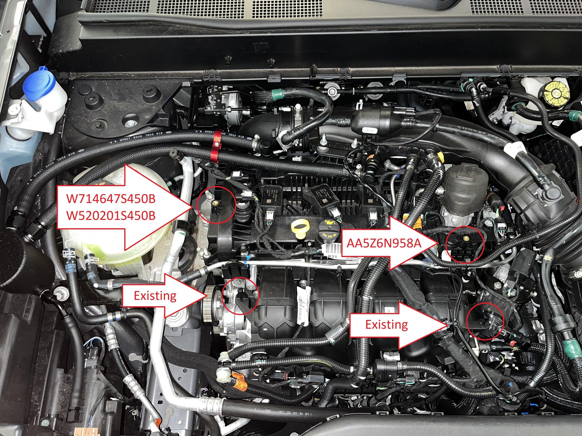

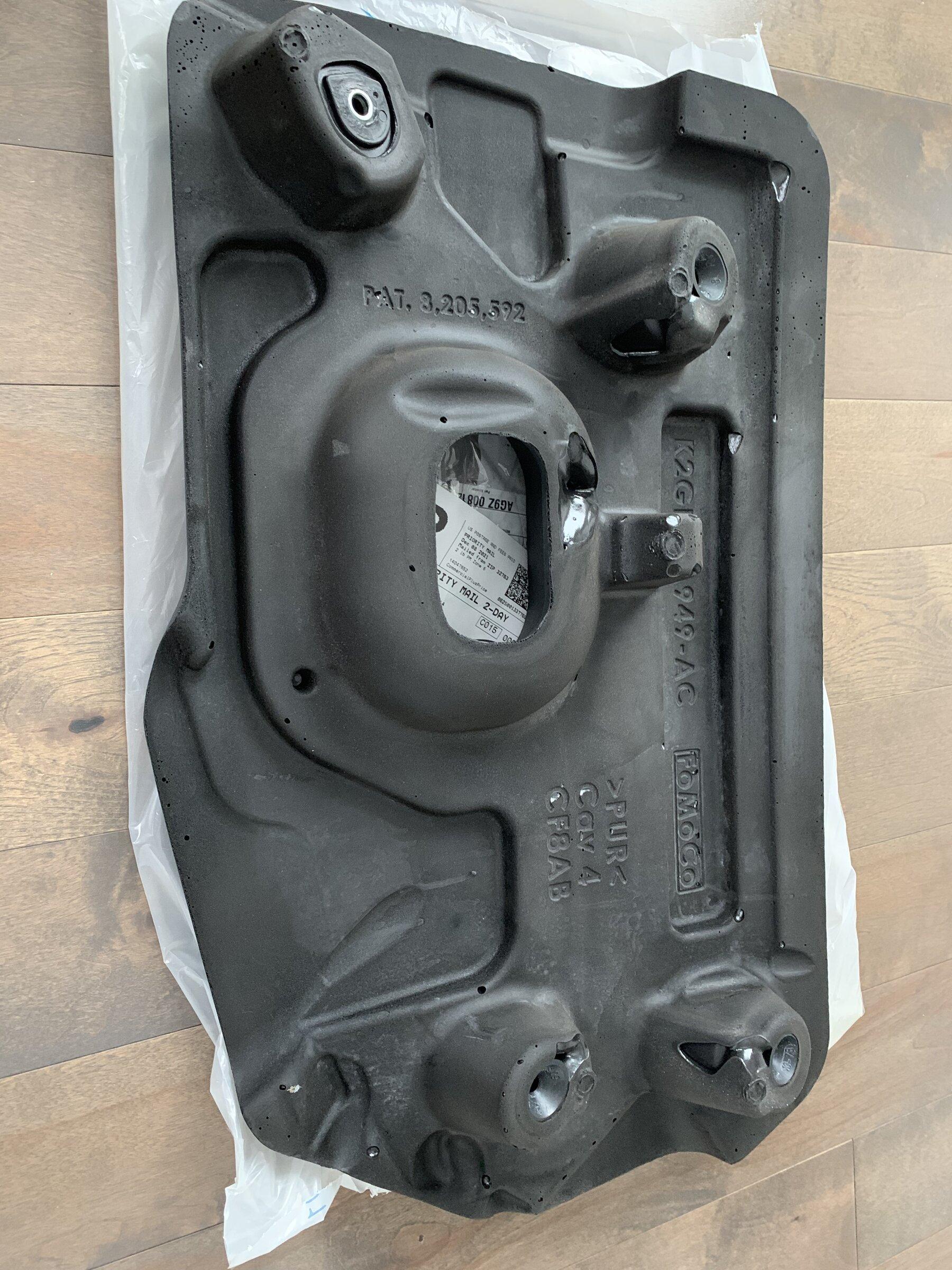

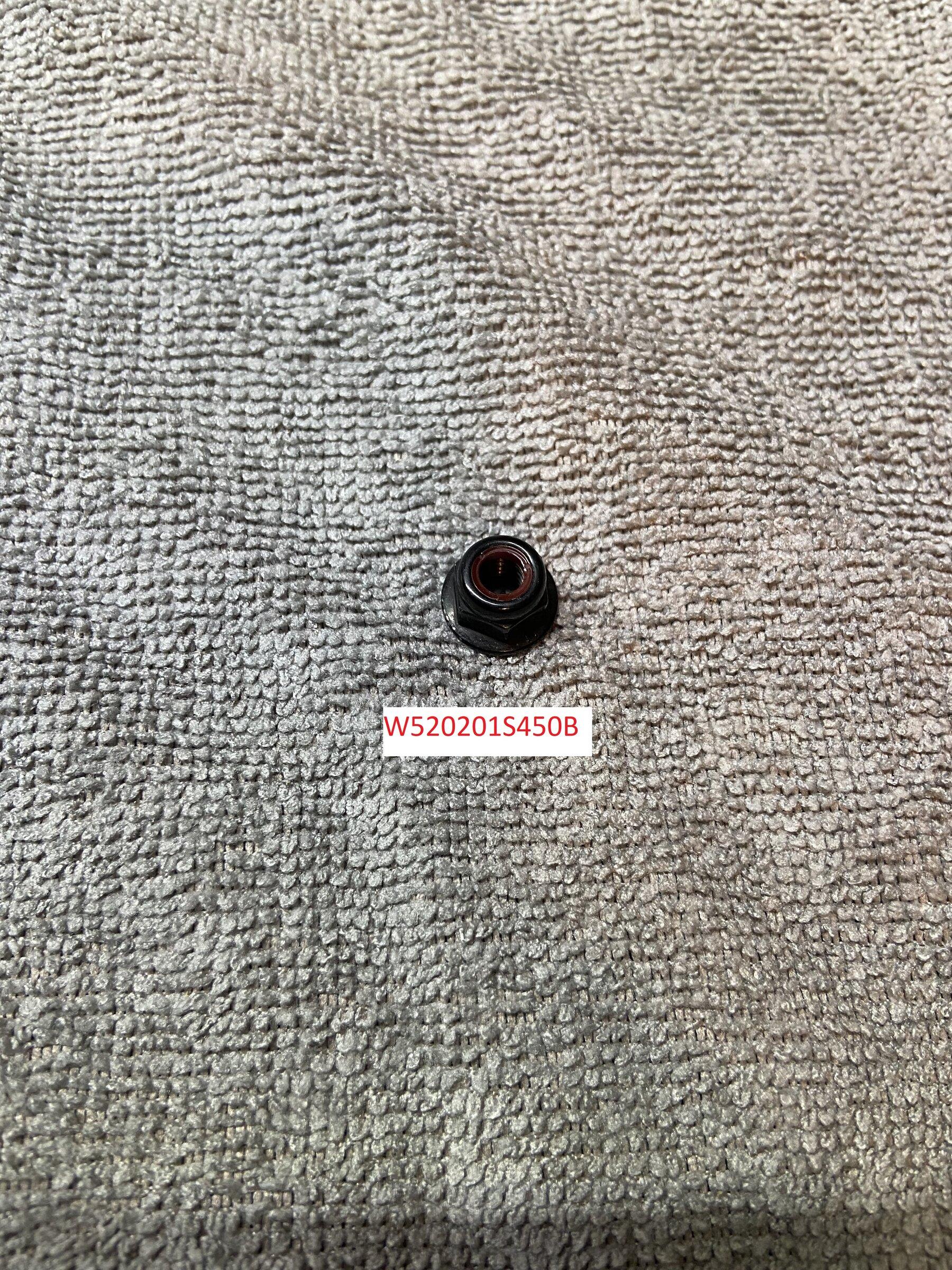

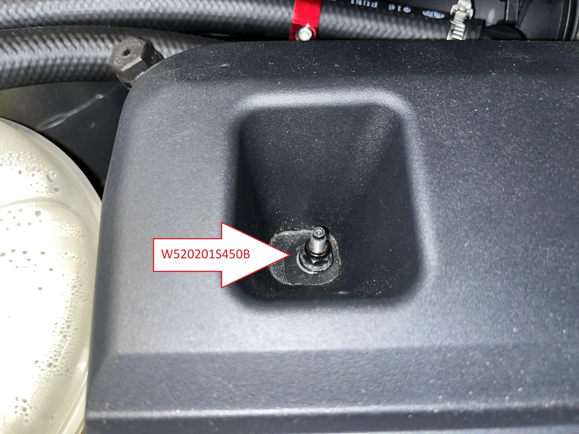

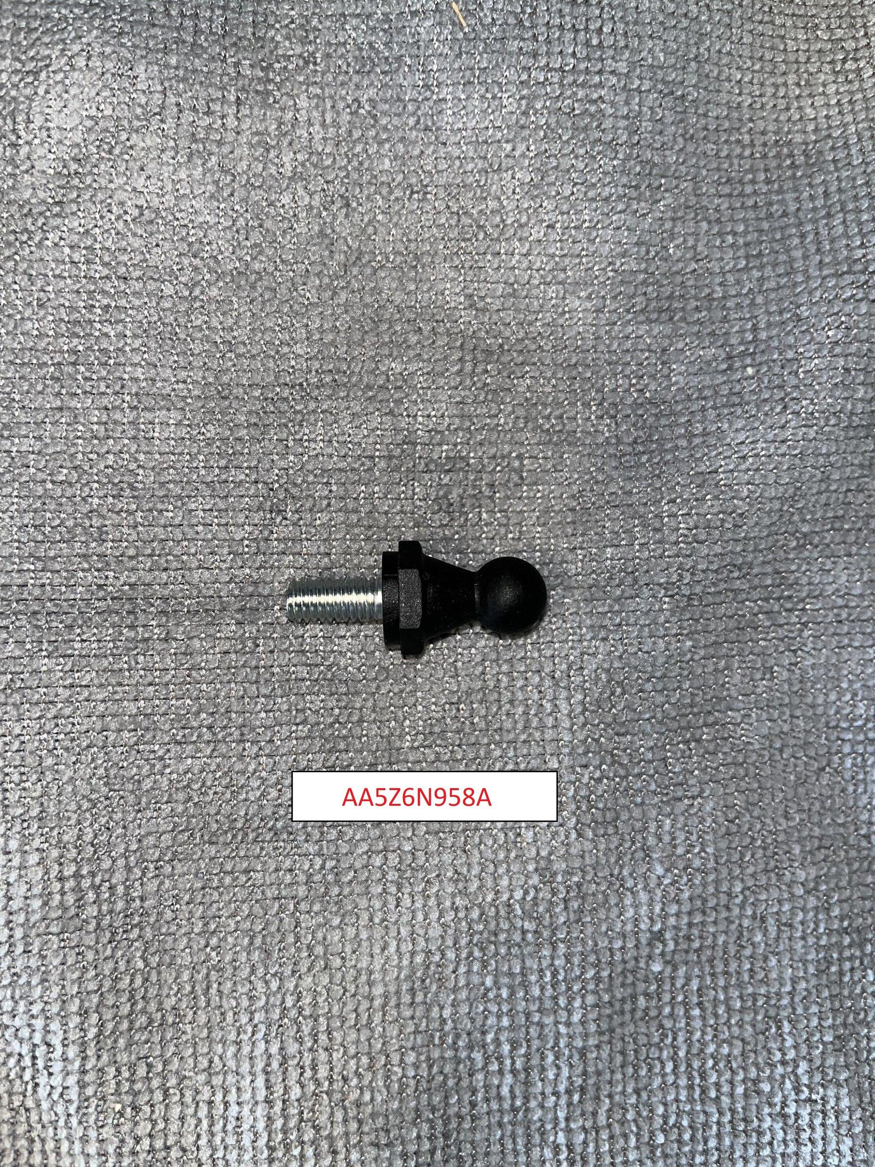

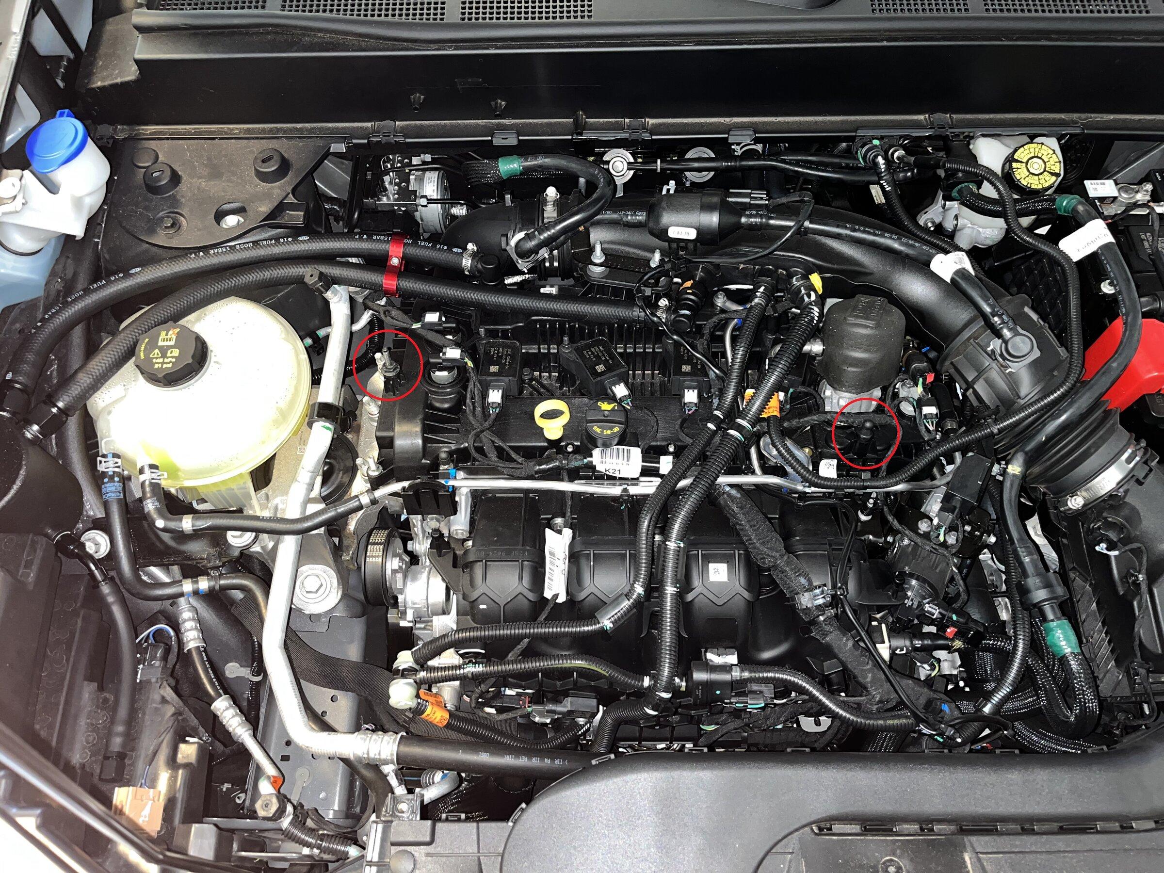

I finally got all of the parts in and got my engine cover installed on my 2.0L Maverick XLT FX4. I wanted to create a parts list / install photo post so here it is. I think most of this has been covered before, but I know there was some confusion on what parts were needed an where they should be installed, so I hope this clears things up.
I ordered all of my parts from https://www.fhmparts.com/
Parts list:
Engine Cover - K2GZ6A949A
Engine Cover Stud - AA5Z6N958A
Engine Cover Stud - W714647S450B
Lower Track Nut - W520201S450B
Total Price:
$80.56 + $18.46 S/H
I'm not sure if having an engine cover really does anything or not, it seems to be debatable. I think it looks great and I wanted it to "button up" the engine compartment so for me it was more of a personal choice. After I drive it around for a week or so, I can let you guys know if it cuts down on engine noise and what not if requested.
Install was pretty straightforward. I included photos that show part install locations. Hopefully this helps. Cheers.
