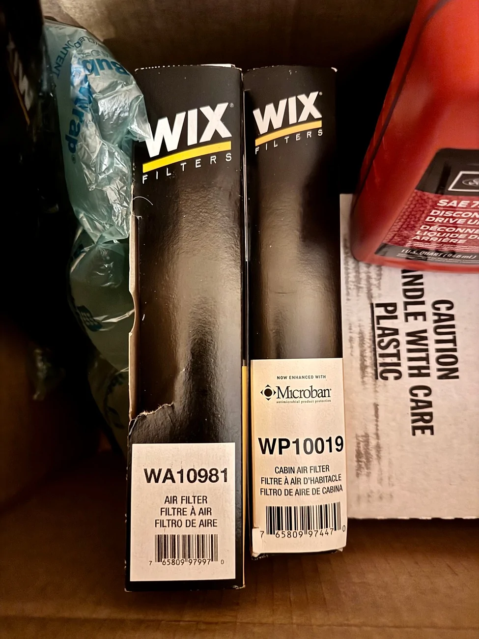

Glad the Wix was at least mid pack; when RockAuto had the oil filters, air filters, cabin filters, and windshield wipers I wanted all in the same warhouse, and some on sale, I took that as a divine sign to stock up more than usual. Somewhat curious that there is a huge gap between the Purolater and Wix though; they are both made by M+H, so figured they would similar, if not the exact same part.

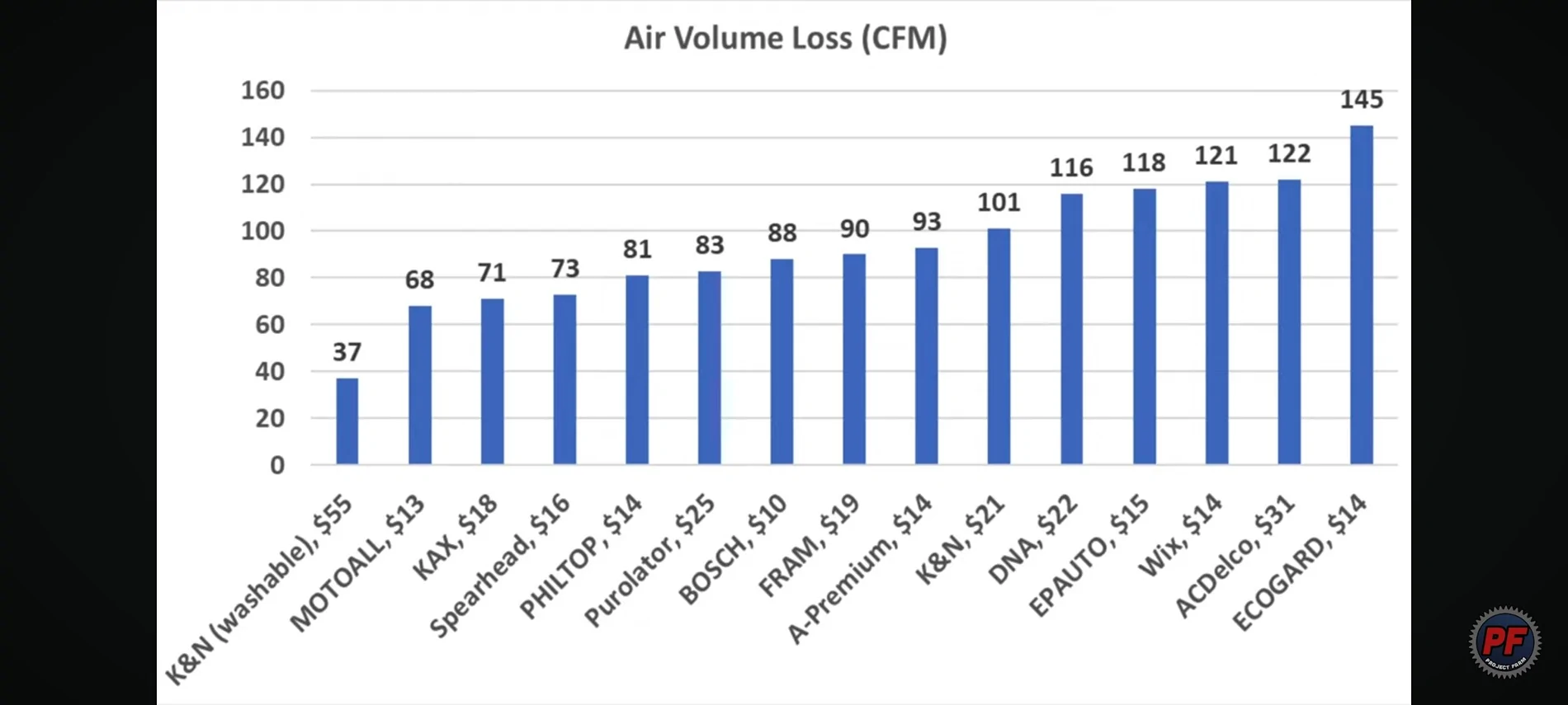

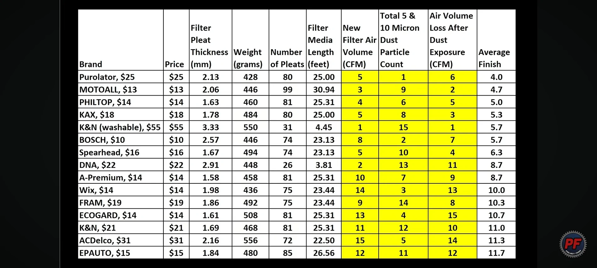

Here's the data.
18:03 the k&n has good airflow. It allows the engine to eat everything except grasshoppers.😅

The entire point of an engine air filter is to filter out the dust and silica particulate that wear your engine's cylinder walls. Some would argue it's even more important to have a high quality air filter vs oil filter.
Reading his results, that K&N didn't filter out anything and will lead to long term damage as silica wears away at your cylinder walls before getting trapped by the oil filter (if it does).
If you're running a race car and want max hp and have tuned for it, use a K&N (or nothing) but for us mere mortals it looks like that Purolator, Bosch, and Wix are the go to's. Bosch looks to be the best value of them.
