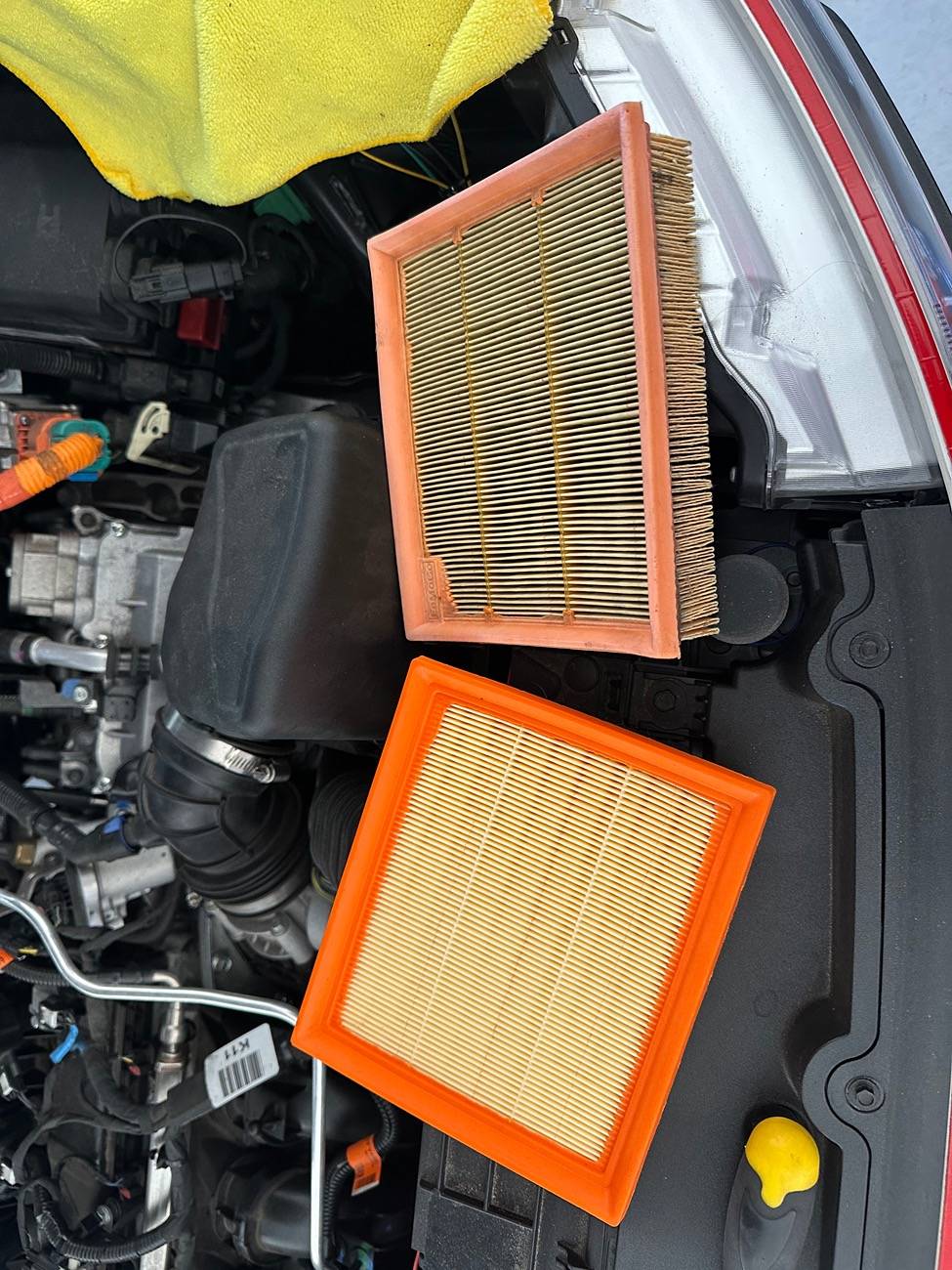

The air filter is a bit smaller than I thought. As you can see after 2 plus years it’s accumulated quite a bit of dirt.
Ford Maverick Changing out engine air filter today IMG_4422

At first when I read 2 years I was like HOLY $H!T, but; then I noticed you have a hybrid. I understand now.
I replaced my filter at 15K (7 months) But I have an EcoBoost. Mine looked just like that; maybe even worse. Sometimes I wish I would have gone with the Hybrid.

Yeah hybrids have no need for regular maintenance and clean filters.
Well the ICE does not run as much as ours............... If they are City Divers, they might have 15K on the ODO, but the ICE ran 5K. Make Sense Now?

I do "Get it". Mine looked the same after 15K in 7 months. So ya......... Dunno what you do. But I look at mine every oil change. That's NOT bad at all. Seen much worse. Much Much worse. Hell I got a 2018 6.7L Diesel. Looks like that after 8K. Milage and use are what I go by. SHIT. If I changed mine everytime I had a lil discoloration (gots look at the other side) I would change every 5K oil change. You do you, Ill do me. That Dudes Filter on a Hybrid looks decent for what it is. I dunno, If there is nothing on the clean side I go with it. Who else does not do the same? Speak up folks. Do you Change your filter after its a lil dirty on the Bottom side? Or do you wait?
I would love a consensus at this point.

As per my earlier post, my classic car has a filter in that's 35 years old, granted it doesn't get used nuch.the k&n filter in my ram is over 15 years old, I know that's reusable. Our mavericks filter is almost 3 years old and 27,000 miles, doesn't look bad,I blow it out with compressed air every spring. will probably change it in a cpl more years at 40- 50 thousand miles.

Many options affect this topic. I had cars with oil bath filters 1950s style. The engines loafed along with loose tolerances from the factory and coarse filters worked fine. High performance Muscle Car ear with big circular filters of tighter material for he clearances used. These are fine up till computer machine tolerances needing tighter filters. Then there is the use of turbocharging. Even small dust paricles that impact the very high RPM turbines embed onto the blades and will hater more dust particle that can grow to the point of being able to cause damage. On turbo vehicles it is not dust into the cylinder but dust building up in the turbo.
I have used a lot of open free flow filter setup on NA vehicles but will not on a turbocharged one!
"consensus" ain't gonna happen to many stubborn folks. If I ever go back to a NA breathing engine I would not worry much about the air filter. But I have seen dust build up downstream in intake piping with K&N and other free flow filters. Turbocharges in my use will get better care.
As to frequency I'll inspect my air filters several times a year, not so much for dirt as dirty filters filter better than new, but for fit and condition. Yes looking at the clean side it should be clean, the dirt side is good as long as obvious plugging is not visible. Another point is electronically controlled engines do not respond as the old carb and point ignition engines. The ECU determines the power demand and adjust itself. Tossing a free flow or no filter at all in the airbox just increases the air flow potential while the ECU decide what to do with the air available. Ya need to allow that ECU to demand more power to get any, that is called tuning!
