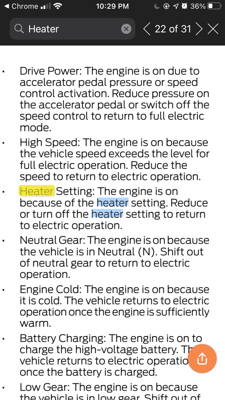

I don’t think anyone can conclusively say there is an aux heater, but there appears to be a substantial fuse for it.
I went back in the manual (draft?) to search and all I got was this note on “why is the engine running” section lol
pg. 416
