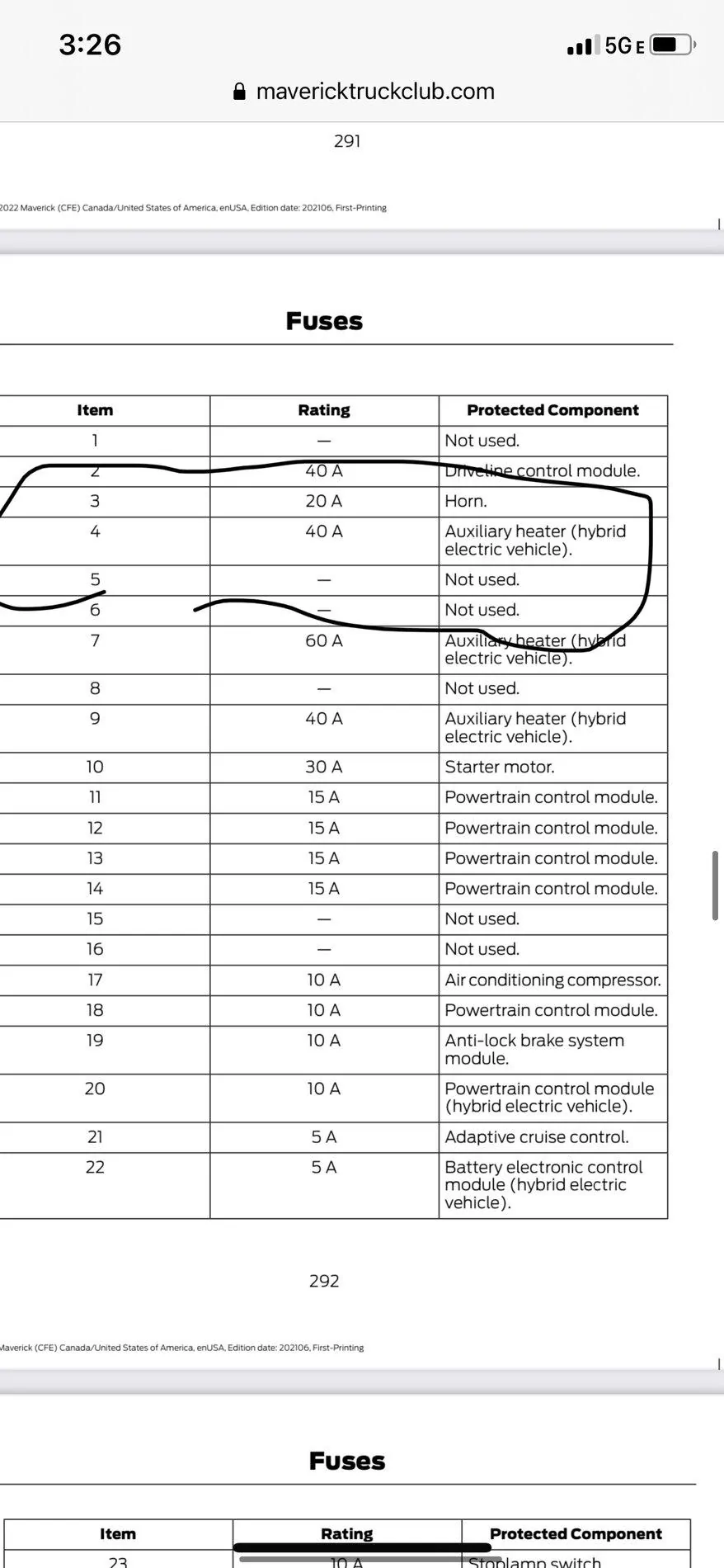

Heat in the hybrid is 100% from the ICE, there is no electric heating element for the cabin. In the winter, remote start will turn on the ICE. But probably shut it off an on as needed while you’re parked, after you’ve reached your automatic temperature setting.
The owners manual shows a 40a circuit for resistance heating in the hybrid only.

There's a 60A and additional 40A for the resistance heater below that one as well.
Could one of those be for optional block heater?

Block heaters are usually straight from the plug to the heating element. No fuse at all.
Thermal management is one of their biggest obstacles. The high voltage battery will most certainly have a heater for the battery "coolant/heating" fluid to ensure that the internal temp of the battery cells are at a certain temperature so that regenerative braking can be implemented or increased proportionally dependent on internal battery temp. I believe that there is a heat recovery unit on the ice exhaust to help circulate heat to where it's needed. The battery appears to have the bottom (15-20%?) dedicated to it with temp controlled dampers and an electric circulating pump along with a separate burp tank. I read that if the tank got low to ensure that any entrapped the tech would have to use software to open valve and run pump until air is removed from battery, etc. So check tanks. With all the auxillary heat fuses they are heating everything and I am betting battery gets the 60amp circuit = get battery to 70 degrees or so ASAP before heavy braking occurs. I also expect that if battery temp gets over some temp then ac condenser can be called on to help as 170+ deg = death for lithium ion.
