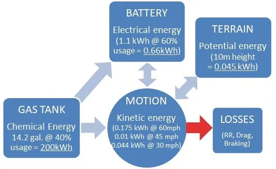

Lastly, consider scale...
Something like this? Not sure what your point is.....
Ford Maverick Drive belt on the 2.5L engine Energy Flow Diagram Esca
The HVB is not a power source, it's a buffer to store energy, same as climbing a hill. The GAS TANK is the power source, the rest of it just conserves that energy once the fuel's burned.
I already made my point, you cut it out of your quotation. The scale of how much energy can be captured by regenerative braking is very small, especially since its also used for locomotion, so the system is likely operating in generator mode most or all of the time to produce that heat. So as a system, you have to look at all the previously mentioned inefficiencies of turning gasoline into heat from the electric heater. So the claim that its 100% efficient is hugely misleading because it ignores the system as a whole.
