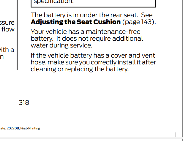

Where's the 12 volt battery located on the Maverick's hybrid 2.5L engine?

AGM vs Standard Flooded Battery
I think some of the confusion is that The Maverick uses both an AGM battery and a Standard Flooded Battery
2.0L ECOBOOST - AGM battery: BAGM-348H6-760 (AGM in the part number)
https://parts.ford.com/shop/en/us/battery-and-related-components/battery-7862483-1
2.5L, HEV - Standard Flooded Battery battery: BXT-99RT4-A
https://parts.ford.com/shop/en/us/battery-and-related-components/battery-7868851-1
The 2.0 EB comes with an enhanced flooded battery not an AGM. See page 357 of the Maverick owners manual.
MOTORCRAFT PARTS - 2.0L ECOBOOST™
Motorcraft Part Number Component
BHEF-48H6 Battery.
https://www.fordservicecontent.com/...-Owners-Manual-version-1_om_EN-US_07_2021.pdf
