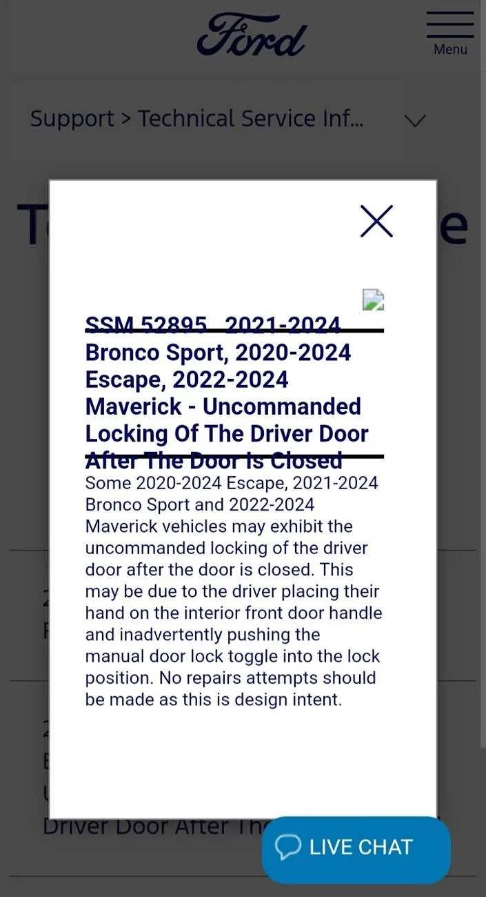

But it IS the manual lock …..what is there to explain? he didn’t post anything that debunks the human error hitting the manual lock when opening the door. I don’t know how many times this has to be explained. It is not something wrong with the truck 🥴🥴🥴
It has to be explained every time someone just can't admit they might be the cause of their issue and learn from it. They've gotten this far in life with that thought process and its sadly not going to change now.
