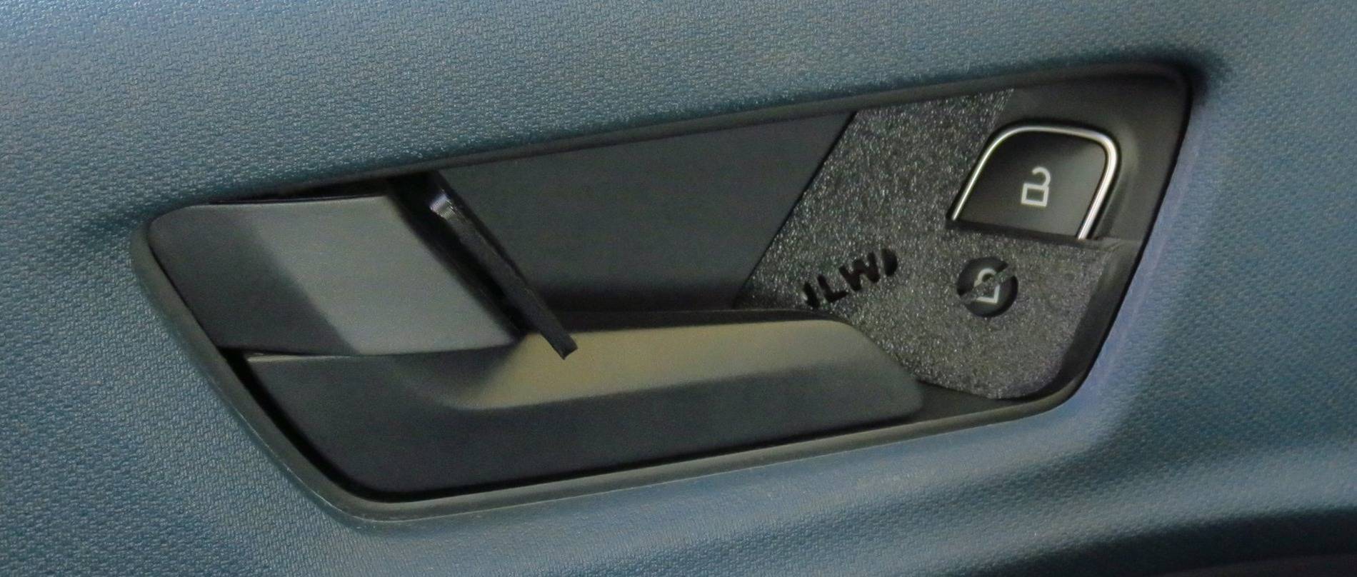

So, I went to the bottom of the rhread page and opened an older thread with over 21,000 views!
It was all about the driver door locking "problem" and copied a photo provided by @NoVaJimmy so that I could put it here...it is similar to @Glen Baker LLC photo, just different notes on it!

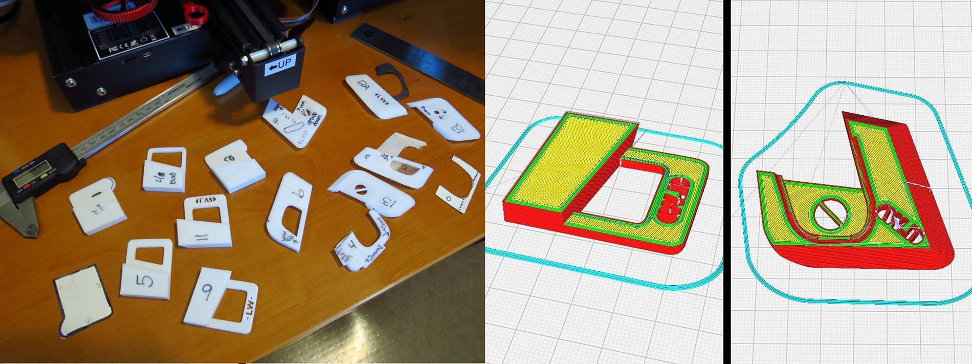

when I went back to open the driver's door it was locked.... I went to the passenger door and it was not locked
The accidental locking had plagued me too. I got super irritated and fixed it. Made a simple 2-piece 3D printed solution that works well in preventing accidental pressing of the lock lever and button. Took a bunch of iterations though, like anything worthwhile does.
Ford Maverick Door locking incident... 222086-b3423ede4c8cec9b0ab5f6d172942cd7
Final version:
Ford Maverick Door locking incident... 222087-da465f022406165c4d3a29ae343a76e9
Read more about it here. They're available If anyone else wants a set.

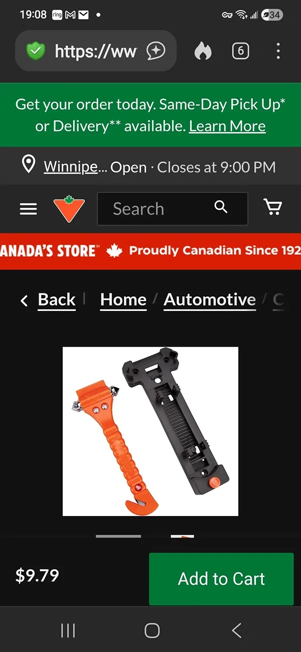

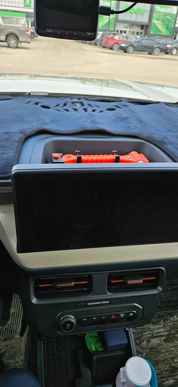

Andy - the bracket/holder for the tool - did that come with the tool, or is it something you 3d printed, or... ?

Hello @Lane I just edited this as I saw upon review that you were looking for the window breaker info.
End edit
Nice mod you came up with and printed, and I get it...it takes a few tries to get something just the way you want it! And those 2 parts could really help some people with their driver door lock issue.

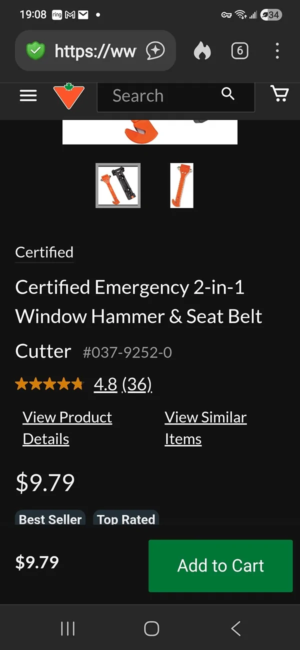

The emergency window breaker I have is all one package that I picked up at Canadian Tire.
I quickly looked it up so I can attach some extra photos for you.
I believe it be a Canadian Tire branded item. So this particular item might only be available at a Canadian Tire.
It is dirt cheap at under 10.00 CAD before tax, so I can't complain about that!
Have a good one and I am glad if I helped you out,

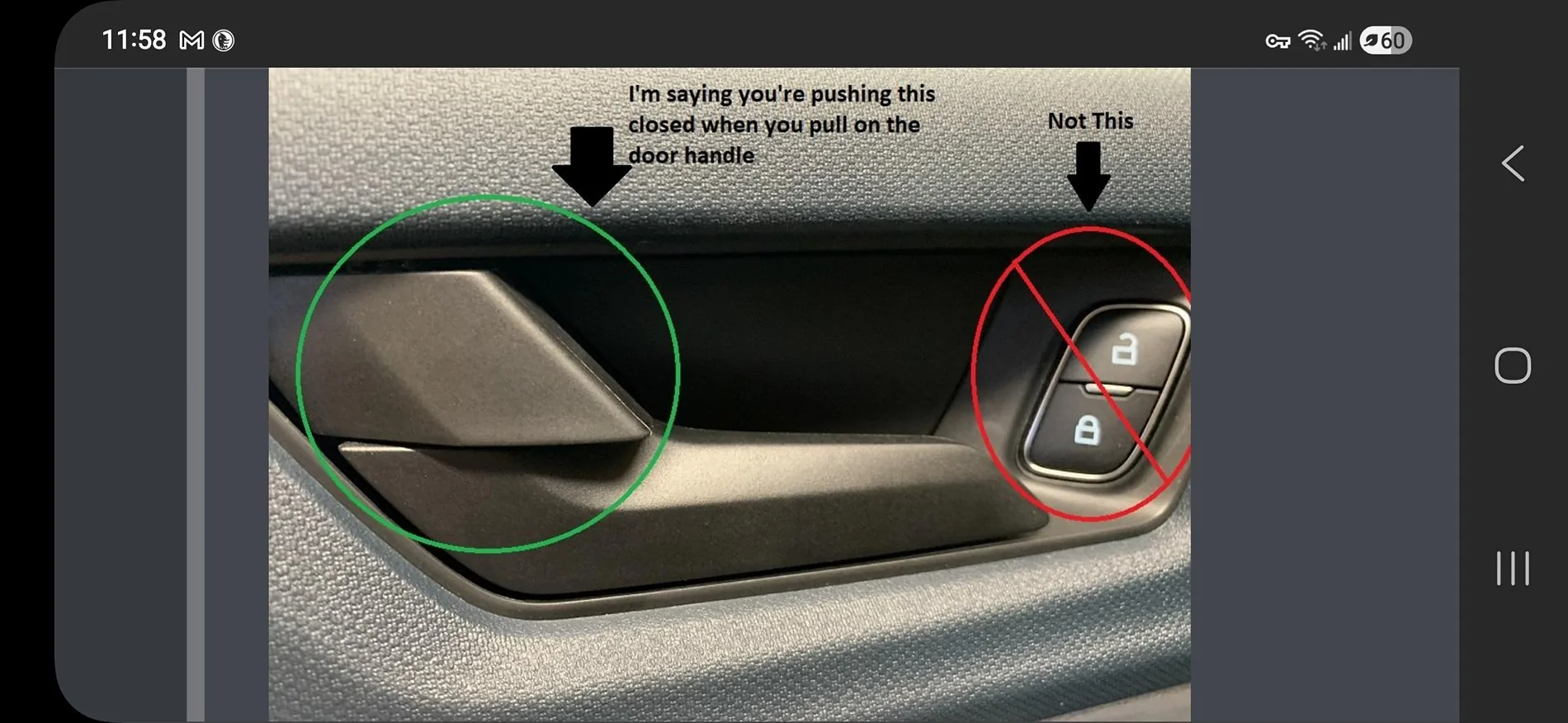

You unknowingly Pushed the Lock LEVER as you pushed open your door.
This is a very common phenomenon NEW owners discover with the Ford Maverick and the Bronco Sport, because of similar door handle design. Allowing the driver to unconsciously, accidentally, mistakenly, inadvertently lock his door while pushing it open.😱
The fact that you state, the passenger door was unlocked.' confirms 100% beyond the shadow of a doubt. That you accidentally locked the driver's door by unknowingly pushing the lock lever while pushing open the door when you got out of the truck.😉 👇👇

so now let's see if this is the same issue where:
-the door gets accidentally locked when they actuated the "manual driver door lock lever"
(not the electronic door lock button!)
Let me see, I think I still have the pic that is similar to @Glen Baker LLC assistance photos...
@jpt5775 please humour us and have a look at the photo below and then go out to look at the door latches on your truck...the common cause of the accidental driver door lock has always been by accident! ThE MANUAL DOOR LOCK LEVER is very easy to lock if pressed by your hand.
Please, just go look at the truck door and compare to the Pic I posted here.
If this isn't the root cause of only the driver door locking on you, please let us know.
Andy
Ps a good way to check is if the driver door is locked unexpectedly, go try the other doors...they should be unlocked for you to gain access (unless you changed the truck setting to only driver door unlocks automatically).

Okay, let's sort this out a bit so we don't get issues crossed.
Please look at the photo above, observe the items circled.
This, and most likely thousand of threads/replies have to deal with THE DRIVER DOOR (ONLY) locking the driver out unexpectedly.
This has always been caused by the human behind the wheel inadvertently depressing the MANUAL DOOR LOCKING LEVER, usually when they push the driver door open.
This can be proven if the driver just walks to any of the other doors. The other doors should be open/unlocked.
This has nothing to do with accidentally pressing the ELECTRONIC DOOR LOCK BUTTON ON THE DRIVER DOOR....it does indeed lock all the doors.
Any other door locking issues such as doors locking mysteriously as you walk away (you stated you have heard the door locks click as you walk away) are unrelated and deserves its own thread.
FOR THE DRIVER DOOR LOCKING all by itself, take another look at the photo provided.
Thank you, and let us know if your issue is different!
Andy
Here is another photo as above, just in case another look is needed.
