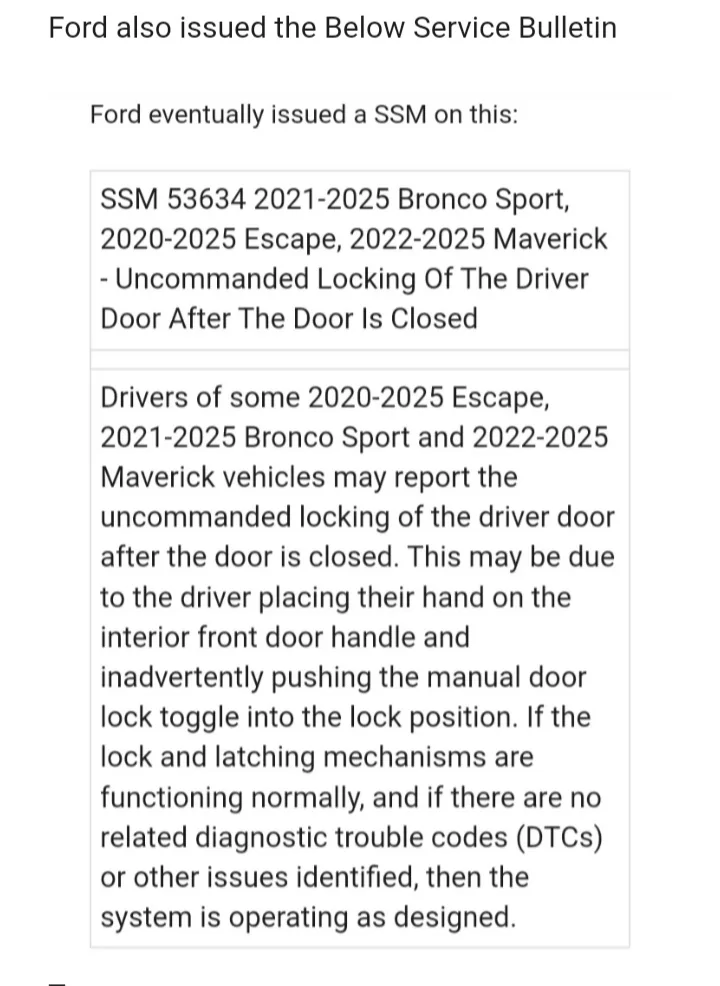

Even ford acknowledge, it was owner induced.
Ford Maverick Door locking incident... 20260405_080655
Not one person has been able to honestly replicate their experience of an uncommanded auto-door locking on video.

So, I went to the bottom of the rhread page and opened an older thread with over 21,000 views!
It was all about the driver door locking "problem" and copied a photo provided by @NoVaJimmy so that I could put it here...it is similar to @Glen Baker LLC photo, just different notes on it!
Ford Maverick Door locking incident... Screenshot_20260405_115810_DuckDuckGo
I Hope this helps...I mean I really, really really hope it helps!
I don't want this thread ending up with 43 or so pages as well...we will have sore thumbs for sure!

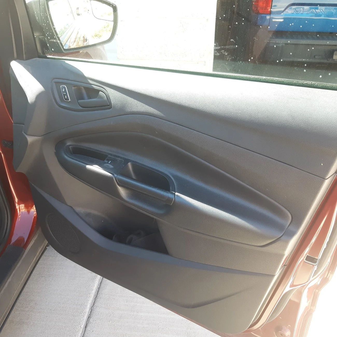

My wife's 2016 Escape does not have any manual locking mechanism on the doors, other than pulling on the interior door handle.
Ford Maverick Door locking incident... 20260405_101020
