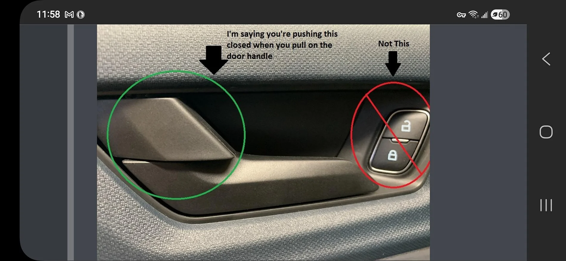

Good day @mikellmikell
Okay, let's sort this out a bit so we don't get issues crossed.
Please look at the photo above, observe the items circled.
This, and most likely thousand of threads/replies have to deal with THE DRIVER DOOR (ONLY) locking the driver out unexpectedly.
This has always been caused by the human behind the wheel inadvertently depressing the MANUAL DOOR LOCKING LEVER, usually when they push the driver door open.
This can be proven if the driver just walks to any of the other doors. The other doors should be open/unlocked.
This has nothing to do with accidentally pressing the ELECTRONIC DOOR LOCK BUTTON ON THE DRIVER DOOR....it does indeed lock all the doors.
Any other door locking issues such as doors locking mysteriously as you walk away (you stated you have heard the door locks click as you walk away) are unrelated and deserves its own thread.
FOR THE DRIVER DOOR LOCKING all by itself, take another look at the photo provided.
Thank you, and let us know if your issue is different!

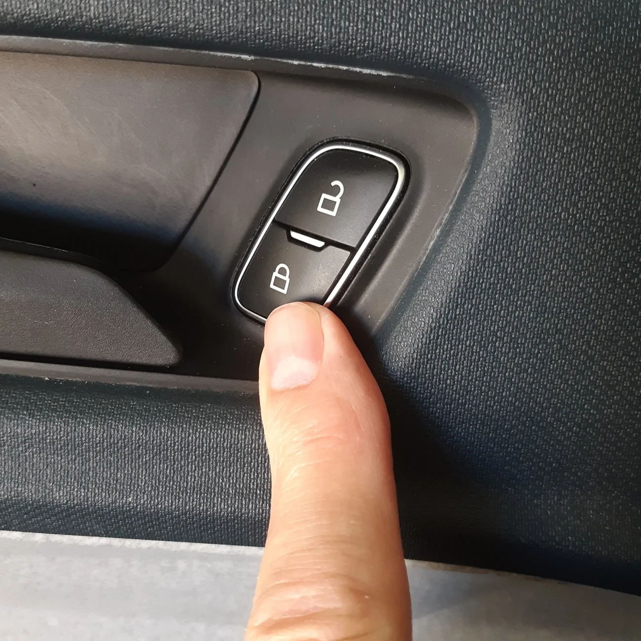

Here is another photo as above, just in case another look is needed.
So you really have no clue what people are talking ab
Carlitos_92
Mar 24, 2024
2,488
5,236
Whatever issue you think you have, is not necessarily the same one as the OP of the thread you're in.
It is not physically possible to electronically lock one door and leave the others unlocked, which is what OP and many, many others ARE talking about.

I intentionally, deliberately, on purpose push the Lock BUTTON, when exiting my Maverick.😁
I don't worry about my Maverick being stolen. I don't think there's a huge market stolen Mavericks.
I find it more convenient to push the button as I'm getting out of the truck.
