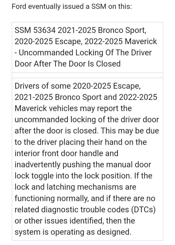

Ford's response to uncommanded locking of the driver's door.
Special service message SSM 53634
Of course, that does not explain why I hear the door lock when I am about to re-enter it, instead of hearing it lock when I am getting out.

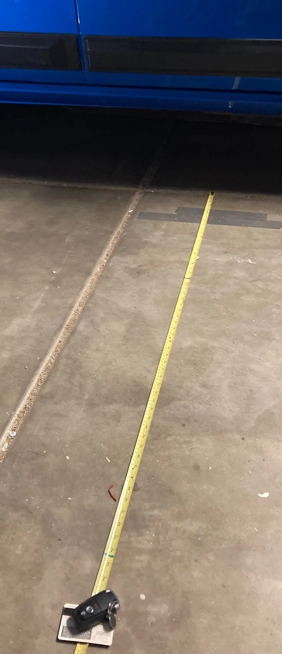

👍 On my 25 Maverick, the proximity of the key FOB makes a difference.
With my truck, the key FOB needs to be within about 58 inches of the either front door to have it activate the unlock mechanism sound & a blinker/headlight flash when inserting hand in handle well.
The FOB uses a CR2045 battery BTW.
