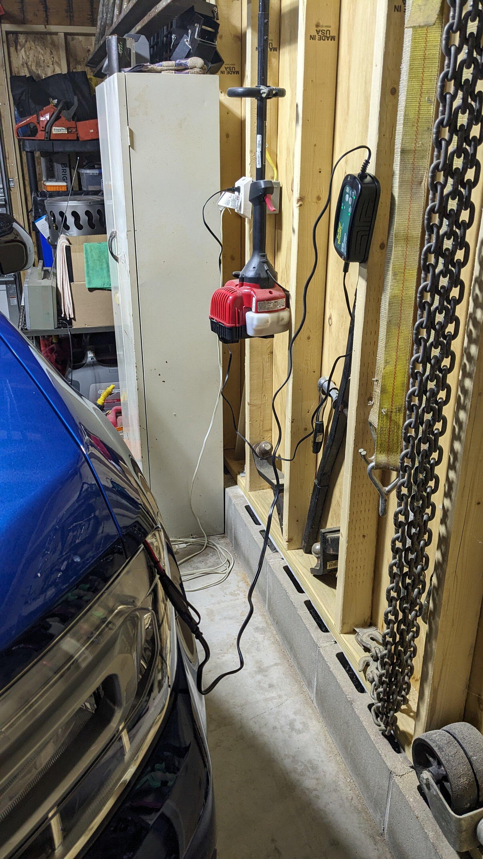

I won't disagree with those that feel a battery tender shouldn't be needed. We shouldn't have to plug a new vehicle in to have the battery last 3, 4, 5 years or more.
Then again, there's alot of things in life we shouldn't have to do, but we do it anyways because it's easier than living with the consequences of not doing it, and fixing the real problem is not something that's often within our reach.
So, I will plug my Maverick into a battery tender whenever I park it in the garage. It's not that hard to do. I do believe my battery will last much longer because I've been doing this already and my batteries have lasted longer than expected.

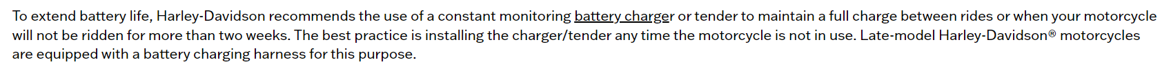

Harley Davidson recommends plugging their motorcycles in whenever they're not being used. They've been recommending this for years. I've a 2014 motorycle that still has the original battery.
If I'm wrong, I can't see much in the way of negative consequences for doing what I'm doing?
Not much of a solution, though, to those that park on the street and don't have the same opprotunity to plug in.

Your hood looks closed. Where do you store the connector ?
I been thinking of adding a charge port either in the bed, side XLT badge or.... ? I hate opening the hood.
I ran it out the space between the fender and the headlight. There's a big enough space that the wires aren't pinched. I leave it hang out a couple inches, like it is, all the time.
I did the same thing. The battery tender harness was too short so I got a 12" SAE extension from Amazon. BT sells one but it is 6' long which is way too much.
If you try to run it lower the movable shutters might not work correctly.
